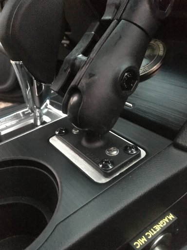

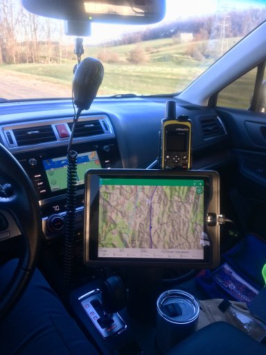

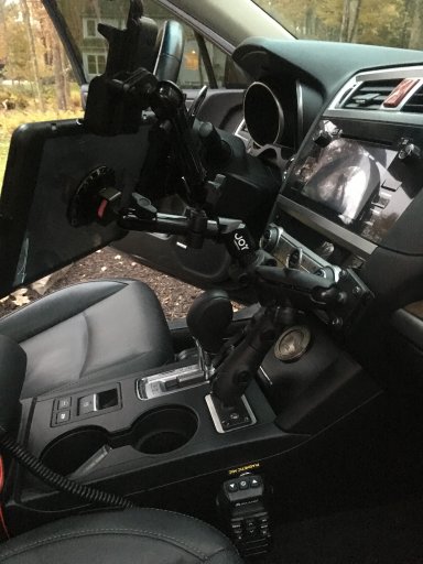

Expo pressure continues to pay dividends.. had a nice productive morning after getting home from work and the kids still slept. This is my custom setup for my iPad and InReach.
It’s a mixture of Joy Factory, RAM, and 67 Designs parts and it’s centered on a custom mount where the cell phone/change pocket used to be.
I’m in the testing phase but it’s almost perfectly flush and as long as it works out I’ll end up painting/wrapping that aluminum. It’s already massively more stable than the dash mount or the cup holder setup. The dash mount didn’t go to waste though because I tied it in via a stabilizing arm.

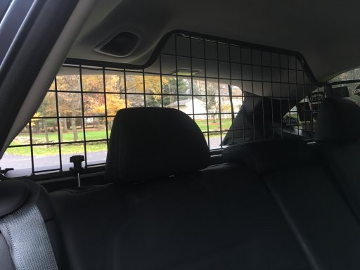

I carry a lot of extra items behind the rear seats and I’ve wanted to address the safety factor for a long time. That said there’s nothing custom about this Travall cargo/pet barrier. I’ve been going back and forth between this and a Raingler net but decided on this. Visibility and knowing that I can leave it up and still sleep in the car in a pinch if I wanted to swayed me towards the Travall barrier.
I still have other things to install but time is growing short. I can’t wait to pack and leave for Expo!

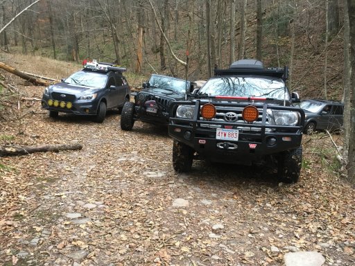

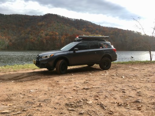

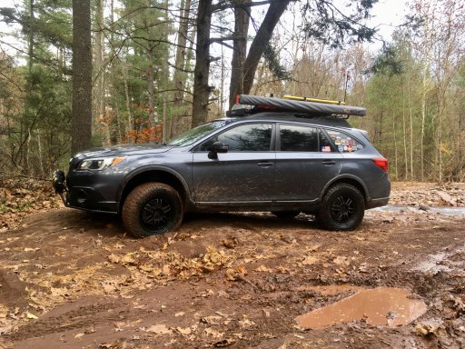

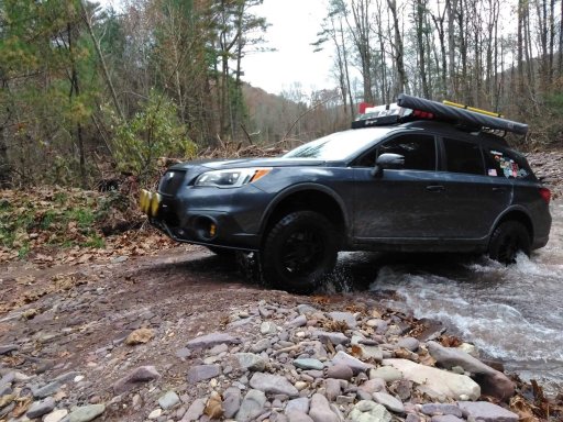

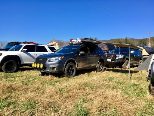

Thought I’d share a few of the very limited pictures I took and some that were taken by others on the way down to mudfest 2018 (aka Expo East).
We had a great time hitting the trails in George Washington and Jefferson National Forest.
View attachment 76565 View attachment 76566
View attachment 76567 View attachment 76568 View attachment 76569 View attachment 76570 View attachment 76571 View attachment 76572
The new arm configuration worked perfectly and even when the trails were at their roughest there was next to no movement.
On to the next projects...
