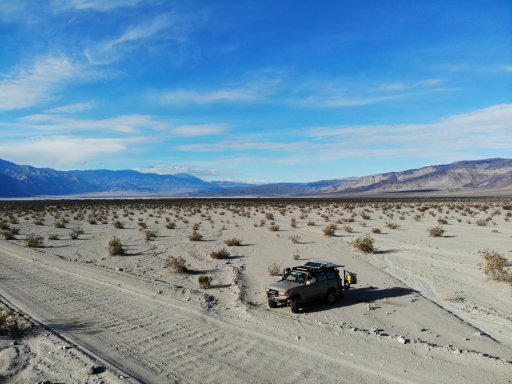

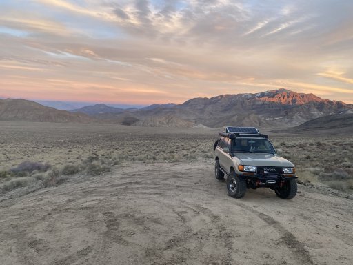

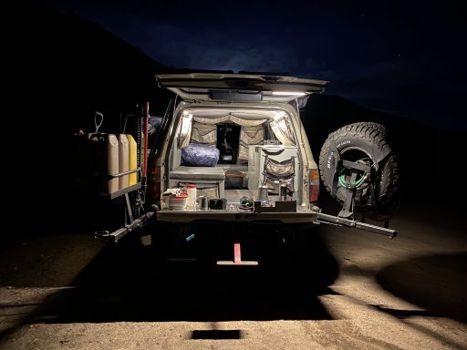

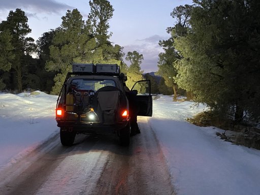

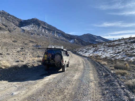

Just came back from Death Valley. Got in from Goler Canyon and slept next to the cabin in the car. Night came down to the twenties. We then drove to the Racetrack and went down to the Saline Valley through Lippincott Pass. Coming out of the Valley to Big Pine was sketchy. 1 foot of ice and snow on the trail and the sun coming down did not help. I just got the Maxtrax delivered when I came back. Bummer Could have used them :)

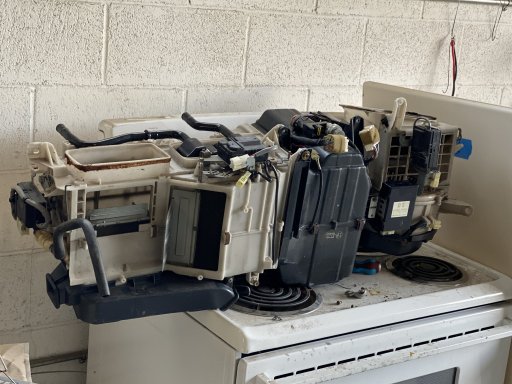

Gutted the dash. It was a real PITA. Took 2 days to do it. Found the evaporator clogged with 30 years of dust, hair and leaves. The problem with early models is that they don't have a cabin filter, so it will eventually clog. I am looking at options to add a cabin filter . The good news is that the radiator shop said that there was a leak from the heater, so it was not only my imagination. Also, when you run the fan, it sure blows air now. Did also clean up with the wiring, so all the non OEM wiring got tidy. I replaced the brake booster as well.
This is the fan/AC/heater unit. Size of a VW bug.
Ob1

It's amazing the amount of stuff they cram in there!
I did some yoga moves to get in there. And there is a sequence to it all. Some of the parts I had to pull out after installing. I put a newer evaporator, and the pipe that connect to it did not fit. It was from a 1995 not 1993, so the mounting hole was off by 1/8". I had to take it all apart. I don't know how they do it in the factory in Japan. They must have little people that do the production.
