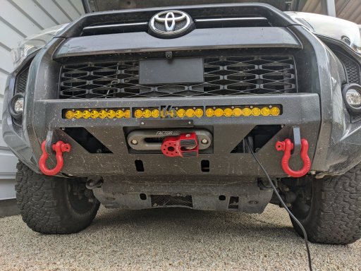

We're still on 265's (KO2) as well (5th gen 4Runner) and do up to mild rocky trails (washes etc), but not rock crawling. From what I understand not all 285's fit in the spare wheel compartment under the car, so you might need a tire carrier. Now that we added a low pro front bumper with winch our front has dropped a bit, and it does noticeably decrease ground clearance. We're still pretty happy with the capabilities, but a bit more clearance would be nice. A suspension lift is on the wish list...
The low pro definitely adds some
weight. Which one did you go with?
