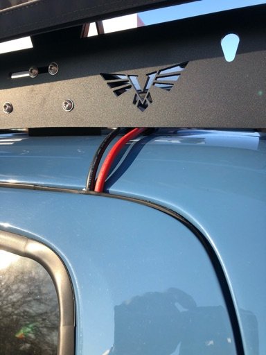

Added a semi-permanent solar panel to my roof rack. Plugs into my 500 Wh Solar Gen unit. Runs my fridge, drone, tablet and whatever else I am running on that particular trip.

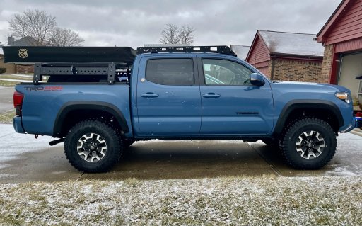

Two part update.
Lift Update. Thanks to @HoosierT and @MattsTrac for helping me get it done.
Icon Stage 1 kit, Icon AAL & Firestone RideRite Airsprings were all installed.
Tire Update:
Falken Wildpeak MTs (LT255/85R16)

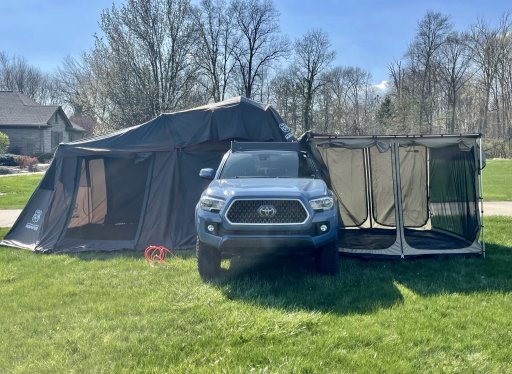

On-board air with control module has been added. Functional but I need to clean up the hoses and fully mount the quick connect port. Annex room and Awning room has been purchased and tested as well! Fully set for long stays now.

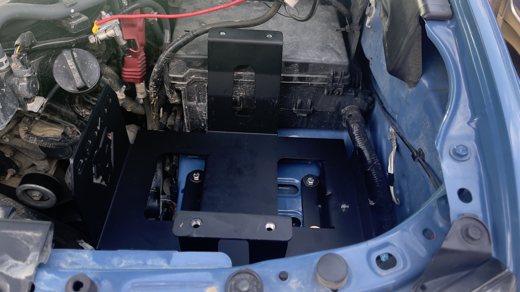

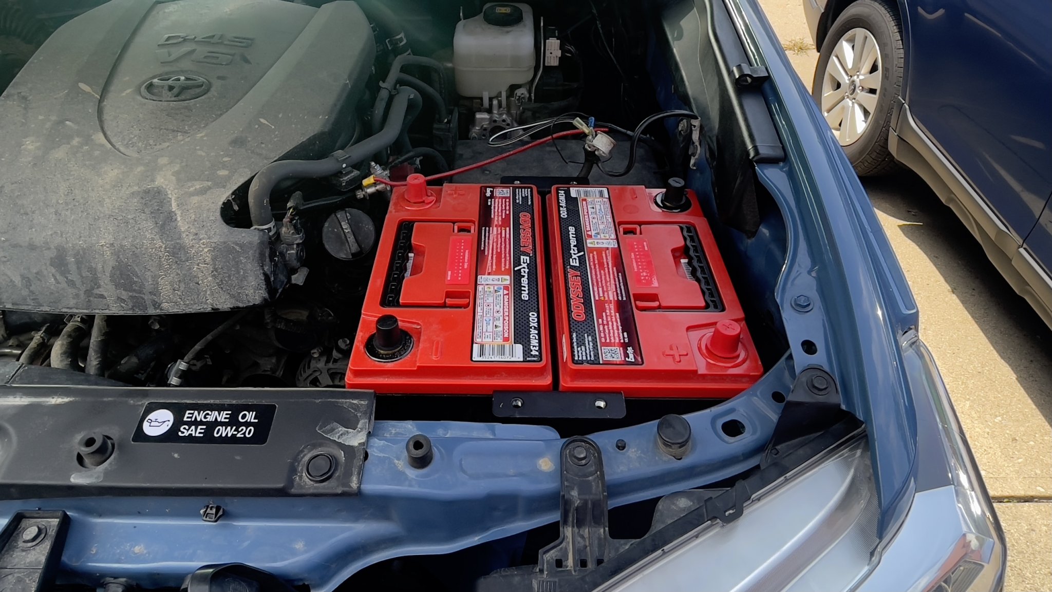

Dual Batteries have been installed on what seems like the hottest day I could have picked for SW Ohio :tearsofjoy:
Drilled and inserted Well Nuts then installed new Tray
Shimmied the Group 34 Odyssey batteries in
And installed the smart solenoid harness
Did a quick trip to the store for refreshments to test everything. Success!
I also was able to tune the ECU to Allow more voltage to the AGM batteries. At an ambient air temp of 85-90F/29-32C sitting at 14.2v out of the alternator.
So what's next? Well I do have my Trigger controller that arrived but no lights to connect to it so here's hoping those ship this week. I did get the PWM controller early as well as all the wiring and connectors I will need for them. I just need to pick up an anderson crimper. Then obviously I want to add the 12v plug in the rear of the cab as well still but gonna need an extra hand for running through the firewall. I may drill a new hole as well as the stock grommets are starting to get full. So still plenty to do the next week or so!

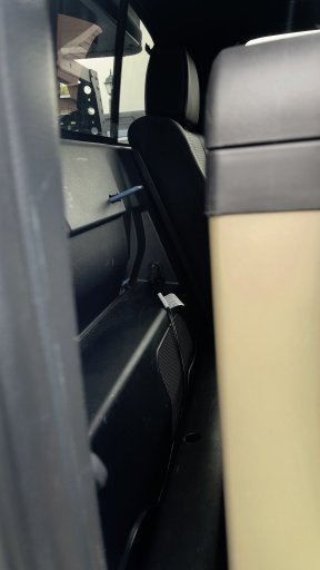

Fridge plug has been wired in the back! I just ran the wire out the rear of the cab then down the frame to the Aux battery.
