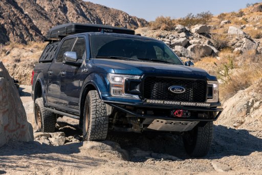

It has been awhile but a pretty big update to the big Blueberry.
It took a lot longer than anticipated, but got a RPG Prerunner bumper installed with a Baja Design Onyx6 40" light bar. Also got the warn 12S winch with Factor55 Superhook. Took it on a test run with some fellow OB members and that skid plate already came in handy with some scratches on it from some slightly technical sections. Overall really pleased with how it turned out.
Future is to delete the rest of the chrome, and save up for some beefier suspension. This weekend will probably trim the plastic in front of the wheels and may drill in to the skid plate to mount the license plate. Still torn about that though.

I spy the intercooler! Nice upgrade there as well. Any noticeable difference with the added cooling area?
Good eye! I had no choice to do it since it was the only way to get a winch in there. I honestly haven't noticed since I didn't do the Forscan mod to see the temp until recently. We were out in the desert (roughly mid 90s) and it remained at a good temp. No noticeable power boost.
