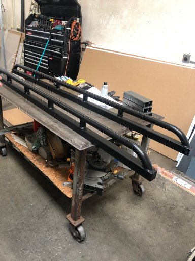

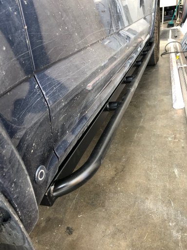

I would also recommend true rock sliders. Currently I have some being built.

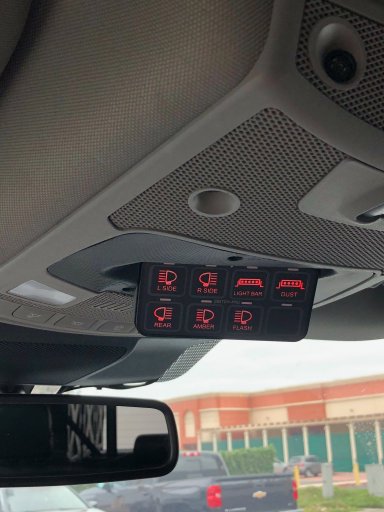

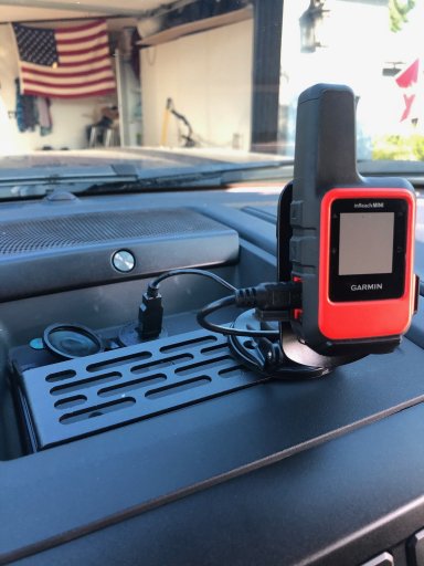

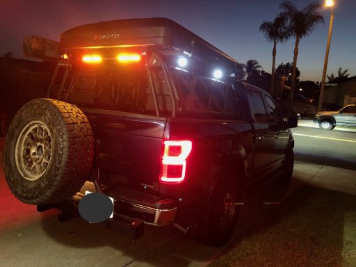

Haven't updated in a while, but there has been a few changes:
1. Installed KC Hilites C-series area Lights, 2 on the left, 2 on the rear, and 2 on the right. Each side is on its own switch so I can light up only one side to not disturbed neighbors if in a developed sites. The switched used is a Switchpro 9100 with a Swarfworks sunglass holder mount and SDHQ mount inside the engine bay.
2. Installed KC Hilite 28" multifunction rear chase light. I have the amber and flashing amber put on the Switchpro and tapped the running, brake, and reverse lights into the tail lamps. This was the biggest pain, especially with the instructions not being clear on what they considered the "left" tail lamp (FYI they mean passenger side when they left, not driver).
3. Got a good deal on an OEM grill and switched out the chrome grill. Almost done getting rid of all the chrome now.
4. Bought Rigd Supply Megafit mount with frontrunner table.
5. Last but not least, bought a Builtright Industries dash mount. Used this to have a mount for my Inreach Mini. Also put in a Blue Sea Systems 12V USB outlet since I had the dash out so I could power the GPS/Gopro without the wires looking messy.
