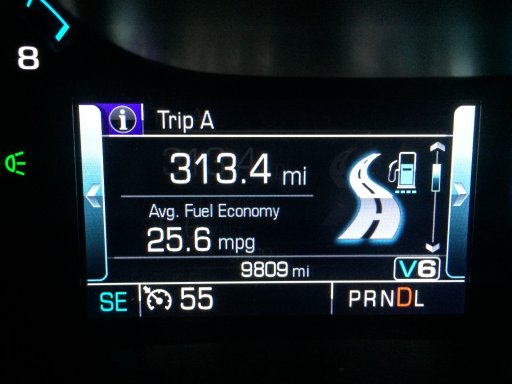

OK. Obviously this test was done a few weeks apart from the first test. The weather has cooled slightly. On this particular test I did run into a 5-10mph head wind... with heavy rain for one of the 50mi legs. Which made my fuel mileage plummet for that leg. Had one mini traffic jam as well for around 20min so it was not too bad.
Sadly the gas station was not open for the final refuel! I will do another 100mi tomorrow and get the refuel there for the actual calculations. I still stopped in their parking lot and took a pic of my dash.
I am keeping the air dam off! I can say that without it my truck is totally more sensitive to a head wind. My fuel economy now hovers ~22mpg when cruising @ 70mph compared to the ~24 reading I got with the air dam on.

Side - by - Side results below...
Test #1: Air Dam ON
Test #2: Air Dam OFF
