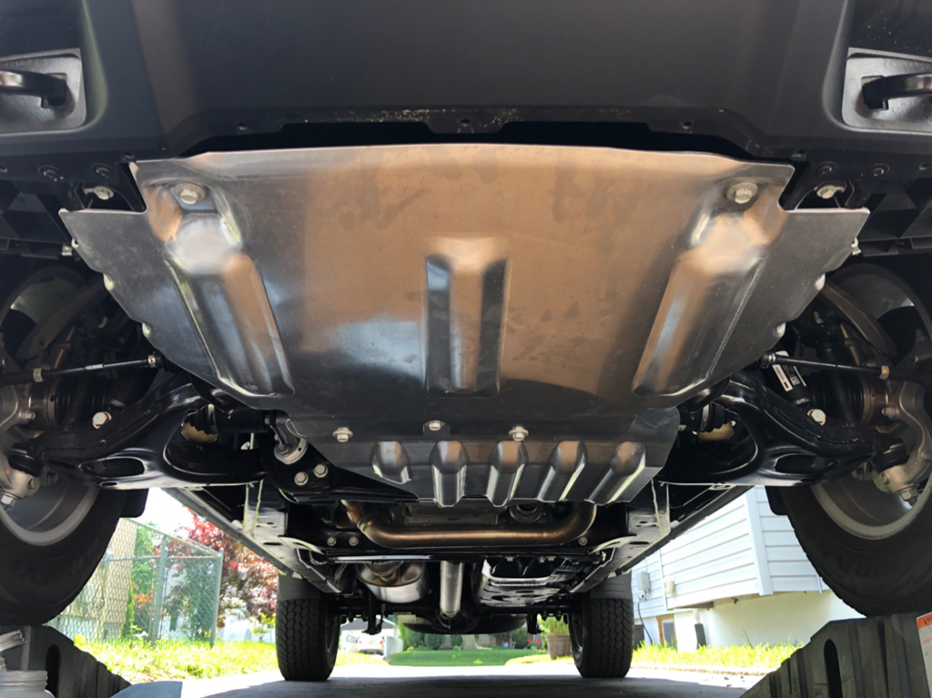

I just check out the skids in that link. They do indeed look like a robust 3/16" steel. A.K.A. they are slightly IED resistant. Here is a pic of them unpainted. Looks like they come black though. (Pic is of a ZR2 though obviously)

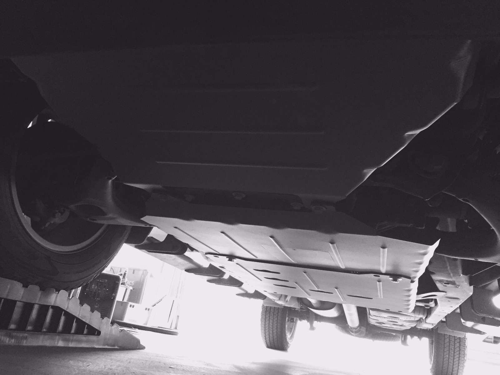

I did some Google Fu looking for the upgraded GM ones. They look like they are both affordable and fit like a glove. I like how the bolt heads are tucked in compared to all of the skids I have seen so far. The skids from the prior post did have a removable port for oil drains. With any of these skids an upgrade of the oil drain plug to a EZdrain plug would be a bonus. I also like that our oil filters are removed from the top of the engine bay now... so skid plates will not get in the way. Used to be a pain for my old dualsport motorcycle. lol

Just spent a few minutes looking at the last two skid plate pics posted above. Looking at the difference in suspension components between the Reg Colorado and the ZR2 suspension. Looks like the only visible difference is A arms and shocks up front. The tie rods, ball joints, and all other major components look to be the exact same... which means they are as tough as the ZR2. Nice to know!
I wonder what the sway bar looks like on the ZR2. The one on my Z71 is a BEAST as far as sway bars go. (May inhibit things off road a little. lol) In the ZR2 pics above it looks like they removed the sway arms... or maybe they don't come with them? I may do some digging...
Update: Just did some digging around and saw a sway bar in the pic of a lot of ZR2 front suspensions. They just removed theirs in that one pic... or I don't see it. Looks like the same sway bar as well.

Edit: Nevermind. I answered my own question looking at the pic from an earlier post. The OEM skids do not even cover the crossover pipe of the exhaust. Which answers the question. No... they don't.

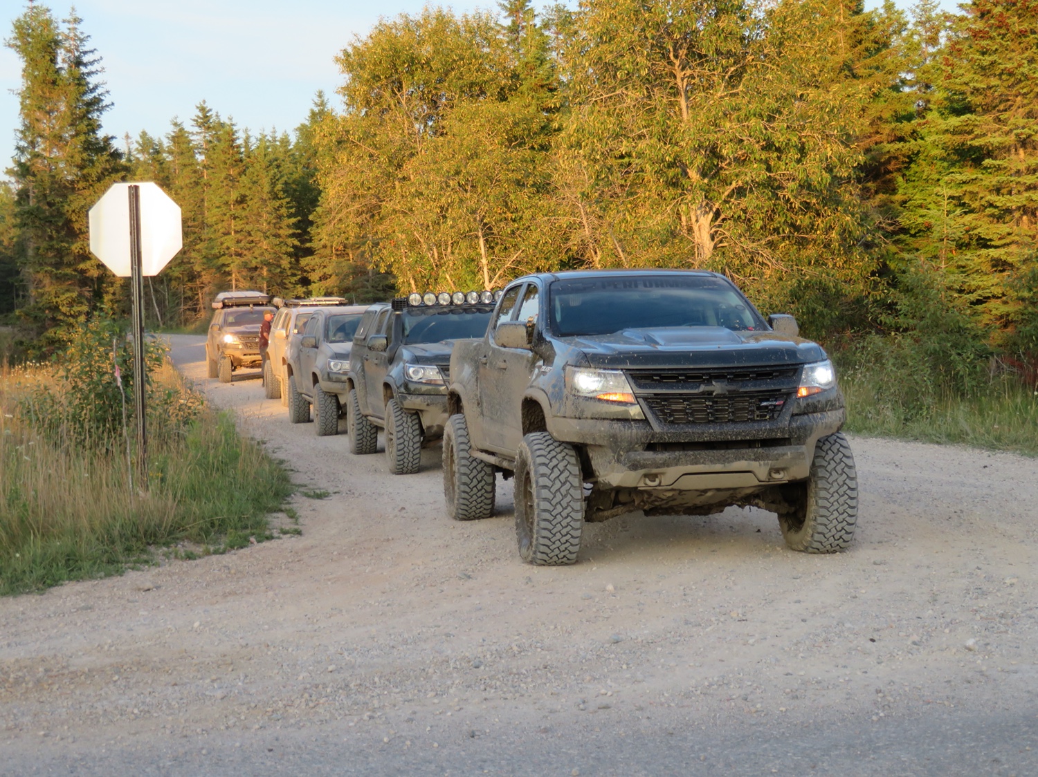

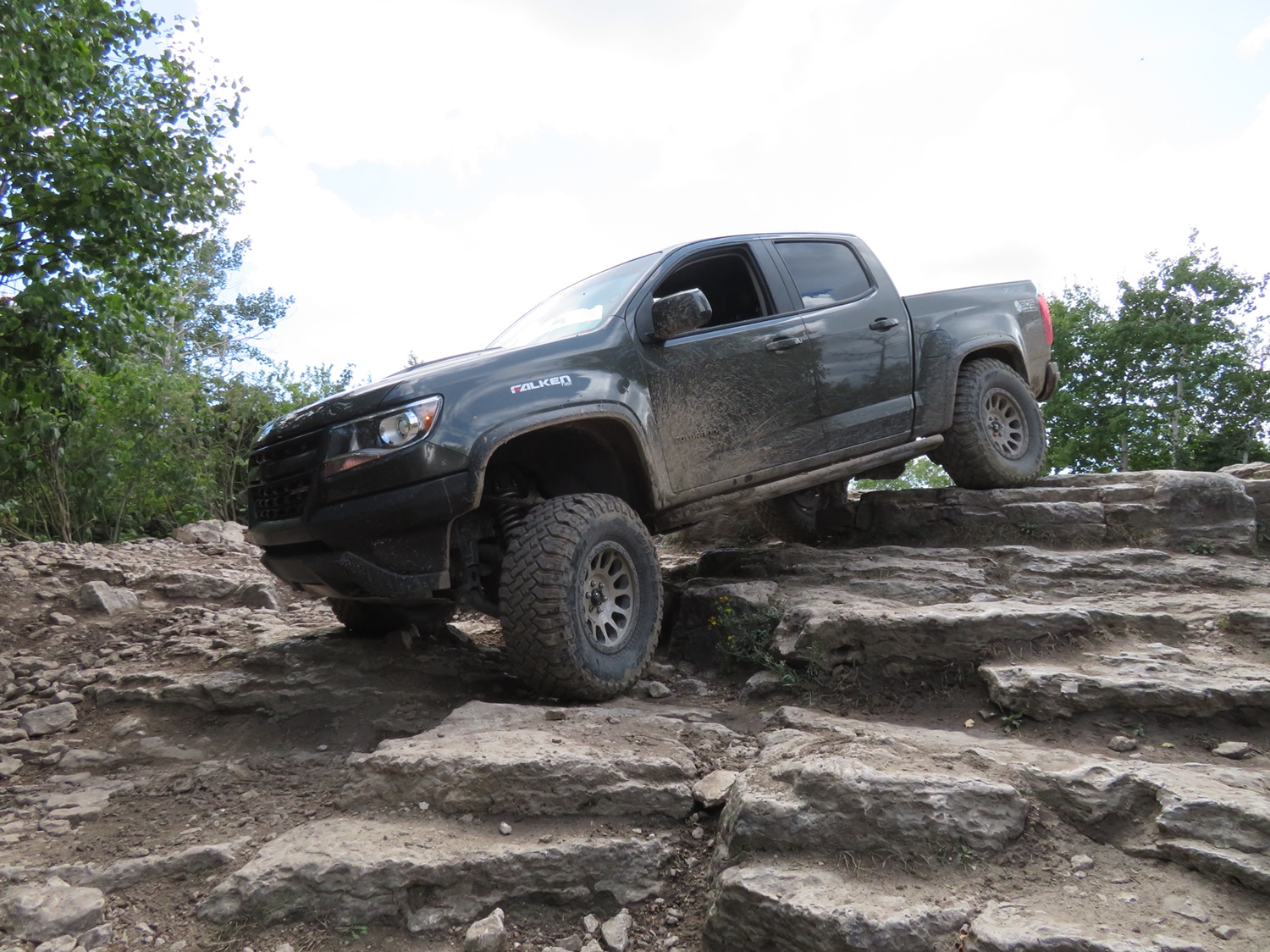

A link to an article that just came out today on the new ZR2 Bison edition that will be coming out next Spring. GM got together with AEV and had a baby.
Link...
https://www.thecarconnection.com/news/1118618_2019-chevrolet-colorado-zr2-bison-goes-through-the-river-and-into-the-woods#image=100669129
That snorkel is actually made by AEV. If you are interested in keeping the dust out this is a good route. Not happening on mine. I live on the East Coast and get around 45" of rain here every year. When on trips I will keep an extra filter in the parts/oil box and plan to have compressed air eventually for rapid filling of the tires and tools.
Here is a link to the AEV site... $459 Ouch! Looks cool though. It would turn some heads for sure... including mine.
https://www.aev-conversions.com/product/snorkel-kit-chevy-colorado/
Here is a link to their YouTube install vid for the snorkel. (I know it's supposed to be called something else but remain a kid at heart)
And now there are already some YouTube videos on the truck coming out...

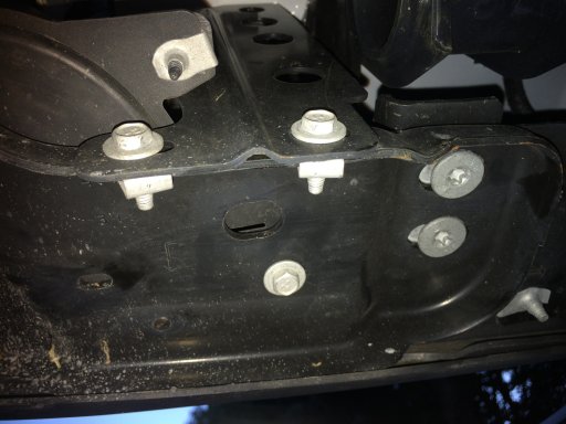

Rear Bumper Step:
I decided to take a look into the rear bumper step on my truck last night. Just to see how hard it would be to simply remove in order to change the departure angle behind the back tires since the largest rocks or steepest angles can have a tendency to be right there. Which is why the ZR2 also has them removed permanently.
Long story short... even though the steps are covered with 1/8 to 1/4" plastic... they are also reinforced with 1/8" stamped steel and are replaceable.
So I have decided to treat them like a skid plate. I will likely never hit them (allegedly), but if I do, I can order the steps and bracket pieces for cheaper than getting a new bumper and having it painted.
On a side note... all of the white sections of my rear bumper are also 100% painted steel. Which is nice because it is tougher... but like all of the metal frame and suspension components I will keep an eye out for rust. I will take metal over plastic any day! It does have a lot of plastic trim that just snaps onto it though.
Pics of the rear step so you can see the seam where it would come off, the brackets, and bolts as well. Several star key bolts... I just got my first set of star keys a little while back. I wonder if these are standard or metric. lol
EDIT: OH OH OH!!! I did not of think of this before. It may be best for these to take the hit instead of the lower sheet metal of your fender well/truck bed. Definitely leaving them on! (subject to change)
EDIT #2!!! I just realized that all of the bolts in the pics are 8.8 grade. Good stuff.
