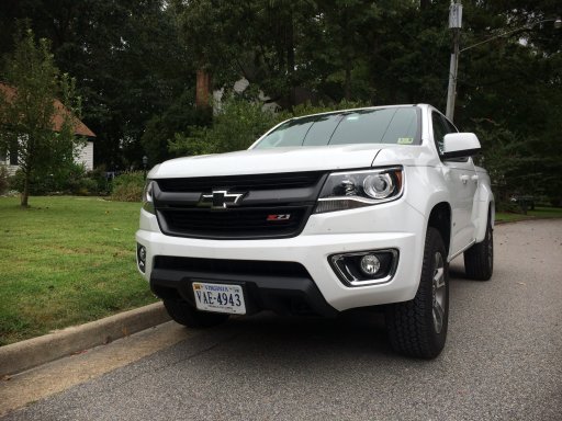

Air Dam Removal:
I just used my spare time sitting around waiting on the hurricane to make landfall making the 1st mod to the truck! Well... ok... maybe the second. The first one was adding/riveting a front license plate holder to the front of my truck when I moved to Virginia a few months ago.
This mod took around an hour to do with a mini ratchet that will hold both 1/4" sockets and flush hold (T10) torxs bits. No the bumper did not have to come off. Yes the hands of a 6ft tall 200lb guy fit in there to get it done. The fuel economy test done in post #46 was with this mod in mind. I now can get a guess as to how much this will effect my fuel economy. I know it will be none around town... maybe 1 mpg on the hwy? who knows.
Either way.... if it is .5mpg or more I will be putting the air dam back on. I will be modifying it to where I can take it off in 2min with power tools in the future. How? By flipping the anchor nuts over and mounting all of the T10 screws upside down. A super simple and easy mod.
Pics of the new bumper ground clearance. It is like giving the truck a 4" suspension lift up front! Not bad. Look how much room is above the basketball I used for reference. There are only a few things under the truck that would snag on a basketball now. Should be great for what I need once I get some skids under there.
And one last pic of the little anchor nuts(upside down). They just pop off and can be slipped onto the other half of the bolt on surface facing the opposite direction. Already did this for two of the bolts so they are not hanging below the bumper. I think the truck looks better! On that thought I may leave the air dam off!
