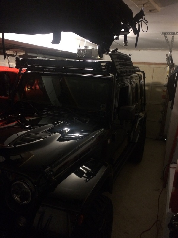

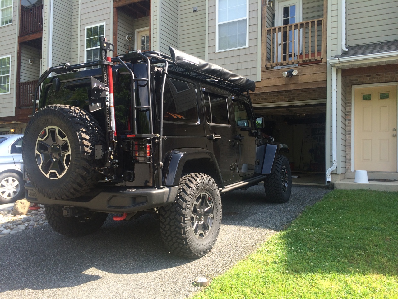

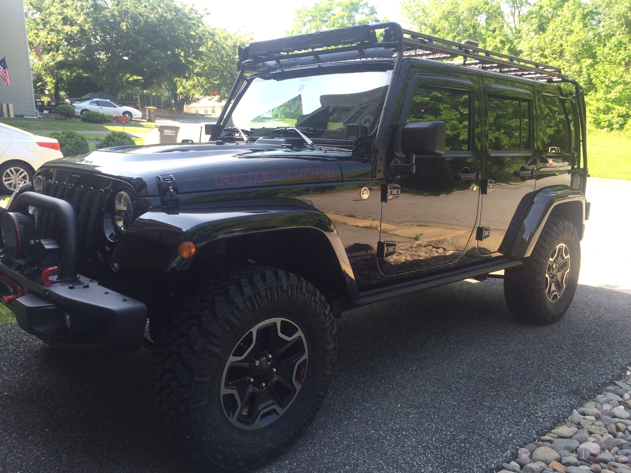

Nice set upThe tent is up, the awning is on. More pics after this weekend's maiden camping voyage.

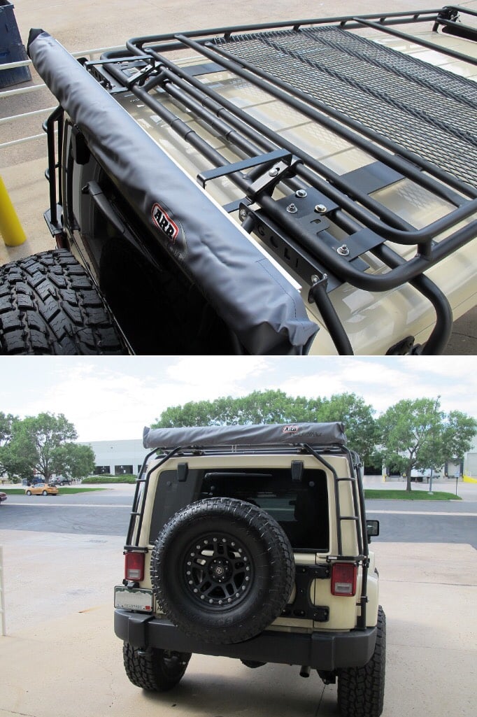

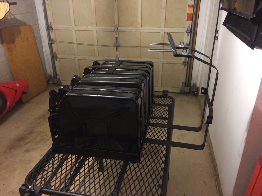

Great build thread. Mine is going very similar to yours just a bit slower. I was reading through your thread and saw your custom Gobi mount for your rear awning. I just emailed them about how people mount awnings to the rear due to the offset bars. They replied with this.
