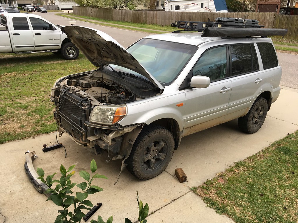

So awesome you're doing this. I was just looking up steel bumpers yesterday to see if one could be modified from a similar vehicle to fit my 05 PilotI am working to fabricate a front hitch receiver that doesn't impact clearance in the front. I have parts ordered and should know if my idea will work this weekend.

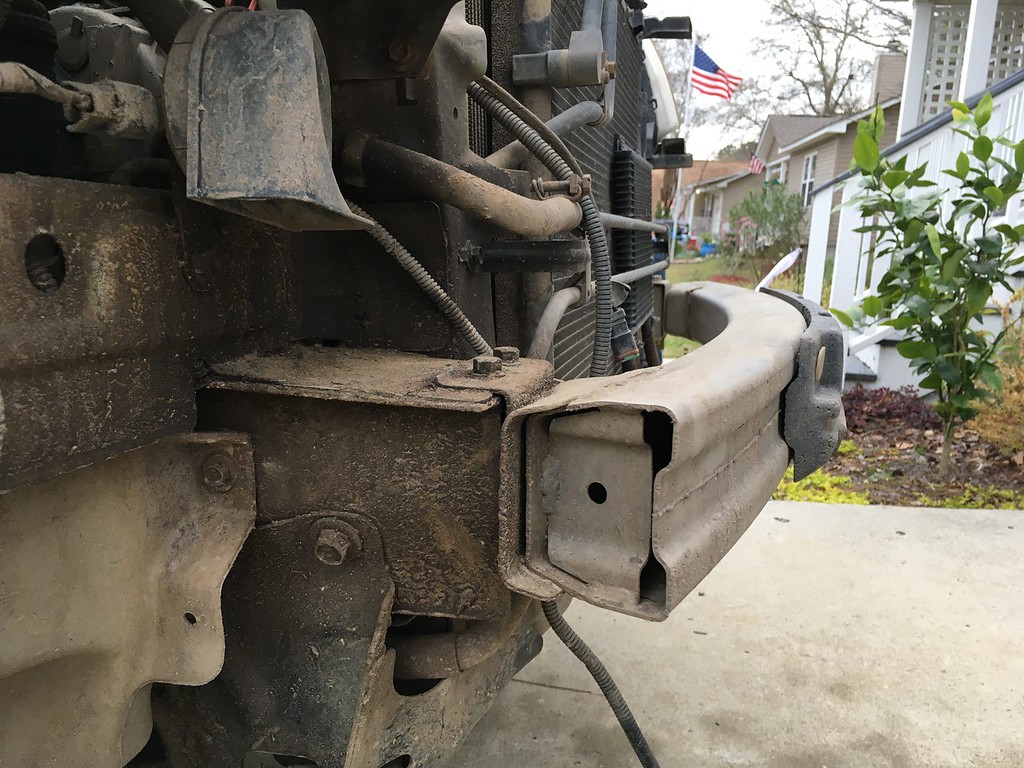

Impressive front hitch build. I would use some longer bolts to attach the hitch plate to the custom mounts and some locking nuts or thread locker. One benefit of the tucked in hitch is less leverage and a stronger mount. Very resourceful and wifey got to weld some. FYI: might want to edit the video to remove personal infoHidden Front Hitch Receiver Build
Thanks, I am going to replace all of the bolts with grade 8 as soon I can find the sizes I need. I will be sure to use lock washers. I am all over the internet at this point so my identity can't really be hidden. Thanks for looking out.Impressive front hitch build. I would use some longer bolts to attach the hitch plate to the custom mounts and some locking nuts or thread locker. One benefit of the tucked in hitch is less leverage and a stronger mount. Very resourceful and wifey got to weld some. FYI: might want to edit the video to remove personal info
