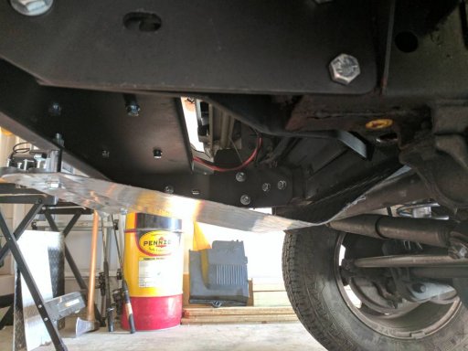

Let me know what you come up with on this. Can you get a couple more pictures for me so I can see exactly what this looks like? I'll have to look at my skid to see what can be done to divert air up.
I'll take some more pics and post tonight.

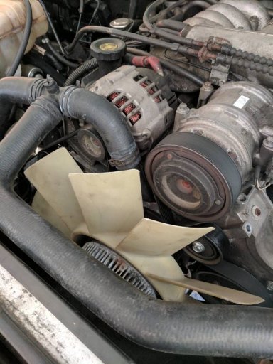

Here is the astro fan and clutch, blades are bigger and the pitch is a little more than factory.

Some quick tests last night showed a couple issues, and are most likely the reason for the temps starting to rise. For starters the fan clutch is toast, and needs to be replaced. Second in line is the AC condenser fan which is seized up, and the motor needs to be replaced on it. Lastly, it looks like we have some air in the cooling system. This is most likely from NOT bleeding the system correctly, and I know the system was NOT bled correctly. All three of these issues are likely what's causing the high temps.
I've placed an order with Autozone for a new fan blade for the early D2 models, and a severe duty fan clutch for the early models too. This setup will give me the same effect as running a Chevy clutch, and pricing is about the same. I also ordered a new fan motor for a Toyota Corolla since the fan used on those is the exact same thing that Rover used, and a 1/3 the price. When I start bleeding the system correctly I plan on adding some Water Wetter to the coolant before topping off the system.

Over the weekend I was able to get quite a bit done. I swapped out the bad afn clutch, fan blade, and ac fan motor for good parts.
Clutch - 922790
Blade - 620-112
Motor - PM9116 (fan blade trimming required)

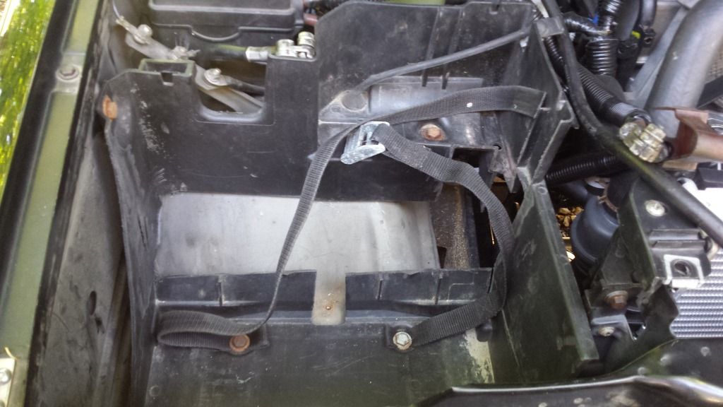

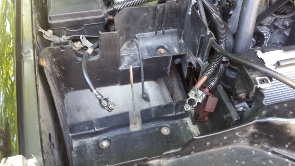

Sorry for some of the not so good pictures. I usually have my wife take pictures, but she was working on her own projects. On Sunday I knocked out our dual battery install, and it wasn't too bad. I was on the fences about installing a National Luna dual battery, and finally decided to do it. Since the plan in to live out of the Rover we needed to have some extra juice just in case.
I took the original box, and cut a little off the bottom to help fit the batteries.
Next I added a battery tie down that uses two of the mounting bolts. This is very simple, and wraps around the new tray, and both batteries to hold them in place.

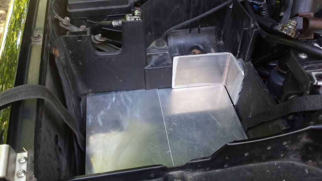

While cleaning the garage I was able to find a nice sheet of aluminum that I used to make two single battery trays, and a corner piece. I used RTV to fix the corner piece to the battery box. Since it was open to the elements I decided to cover it.

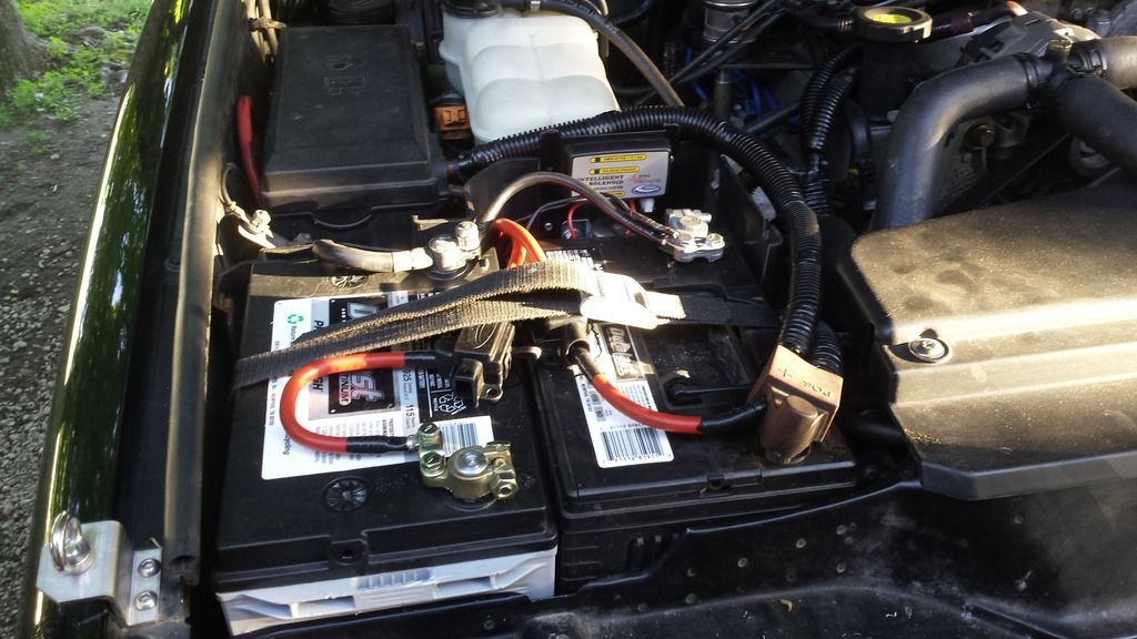

Here's the finished product. I'm not to keen on the location, but there isn't much to work with under the hood.

We've had the dual battery setup in for a little over a week now, and everything has been great with it. I would recommend the National Luna for members who don't want to mess around with purchasing individual items. That being said, if I were to do it again on our Disco I would NOT have bought the kit.
The kit is great if you don't have anything wired yet. Unfortunately I already had the entire interior wired before purchasing this kit. Our engine compartment keeps the batteries side by side so not much wire was used. I think I used about 2-3' of both wire, and was given 18-20' with the kit. I also didn't use the supplied battery terminals since the design of them wasn't very appealing to me.
All in all this is a great kit though.
