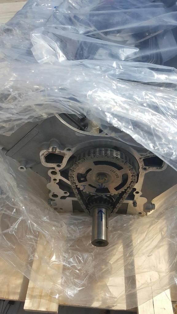

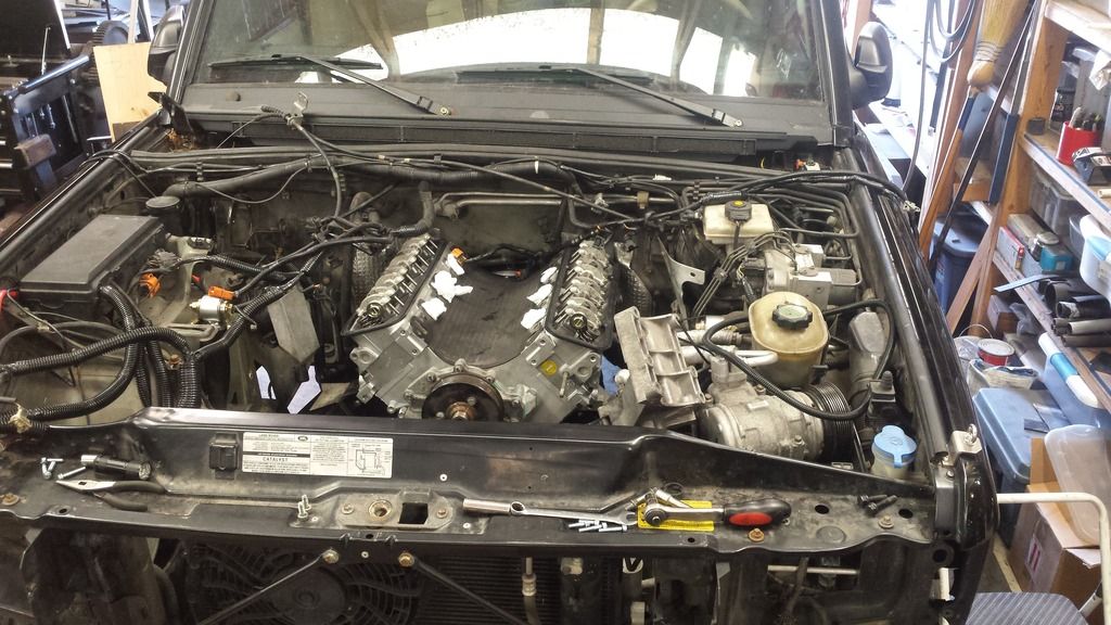

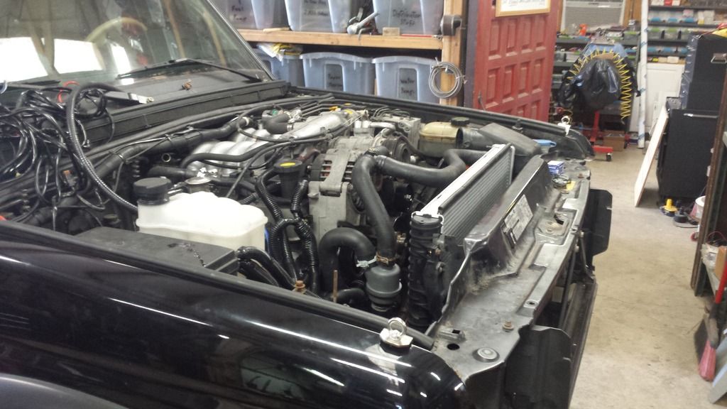

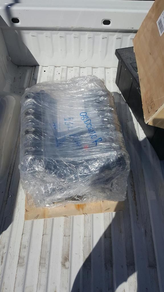

We have big things going on right now. A few months ago we decided to bite the bullet, and order a new engine from the UK. So much for not going overboard on this build! The company of choice was Turner Engineering, and they're regarded as one of the best engine re-builders around. After the placing the order with Turner we had the new engine in hand within 14 days.
This is the day the engine arrived.

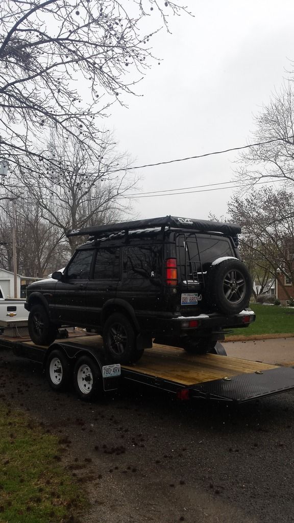

Next was getting the Rover to a better location to work on it.
Spent a weekend pulling the engine out.
Over the next couple weeks we cleaned parts, re-loomed the engine bay, cleaned up some rust, and put the new engine in.

We have big things going on right now. A few months ago we decided to bite the bullet, and order a new engine from the UK. So much for not going overboard on this build! The company of choice was Turner Engineering, and they're regarded as one of the best engine re-builders around. After the placing the order with Turner we had the new engine in hand with 14 days.

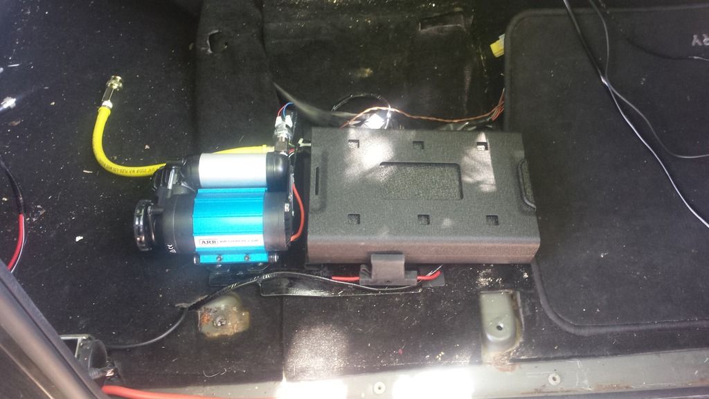

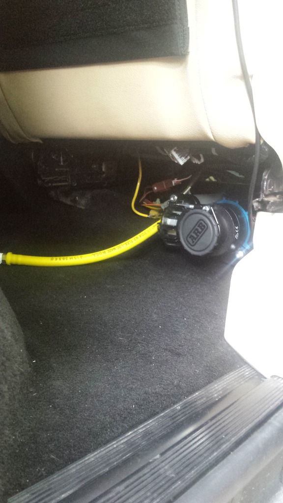

Had a little forward progress this weekend. I was able to install our ARB compressor, and get the winch mounted up.
I decided to put the ARB CKMA12 compressor under the passenger seat. I decided to make small extension to come off the frame I made for the safe. I also added a fixed piece of air line hose to the compressor so I wouldn't have to reach under the seat trying to find the connection. The compressor sits nicely under the seat, and is powered through the BlueSea fuse box that's installed on the platform.

What temps were you running before the winch, and after the winch. We noticed out of no where this past weekend that the temps are getting high. Normal highway driving we saw temps at 217, but would drop back down to 210. We even have the soft spring t-stat too. I also know we have the original fan clutch, and I'm leaning towards replacing that with a Napa server duty clutch.
Sounds just like mine, I swapped out my fan and clutch with a used 1999 Chevy Astro van setup, tight fit but bolts right on, I also added a skid plate/scoop under the bumper to funnel air up to the radiator. My temps stayed well over 200; now with the new fan and scoop, my highway is around 190-194 and below 50mph is 197-200 with or without a/c. Of course it's getting hot out, so I know these temps will creep up over the next few months.

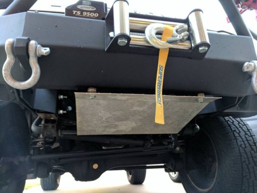

What can you tell me about the skid/scoop you installed? I have a front skid that I haven't installed yet, and don't want to add anything that'll make it hotter.
Here is the mock up, I left a 1.5in gap below the bumper to force air up to the radiator, effectively replacing the bumper scoop from the factory bumper. I'm still playing with the design, going to drill a few large holes in it this weekend. This helped dramatically at highway speeds.
OB#3799
Let me know what you come up with on this. Can you get a couple more pictures for me so I can see exactly what this looks like? I'll have to look at my skid to see what can be done to divert air up.
