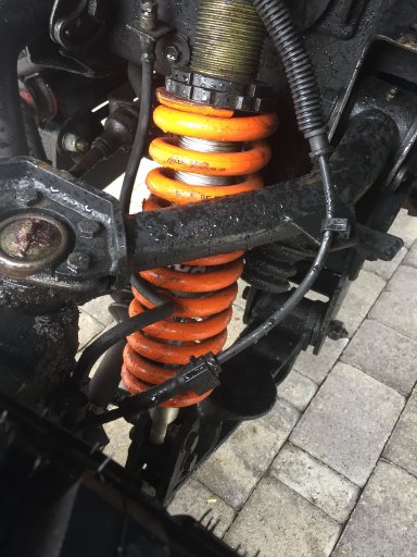

Hey Max- Thanks for the kind words over on Expo! Good looking plan you've got. Glad you talked to Atomic, nice guy and he'll hook you up! It was my understanding the mounts cannot but used with 2500, and even modification it would be hard because the angle of the spring would end up hitting the UCA's, but maybe things have changed since I last looked or maybe difference between 2500 and 2500hd, so atomic probably has something in mind... Looking forward to seeing it.

Hello! You're very welcome! Good to see you post here. I'll post up some correspondence I've gotten from Atomic and I'm hoping the only issues I have is the money haha. I also hope this information will benefit others with rigs like you fellas have and give Atomic more business!

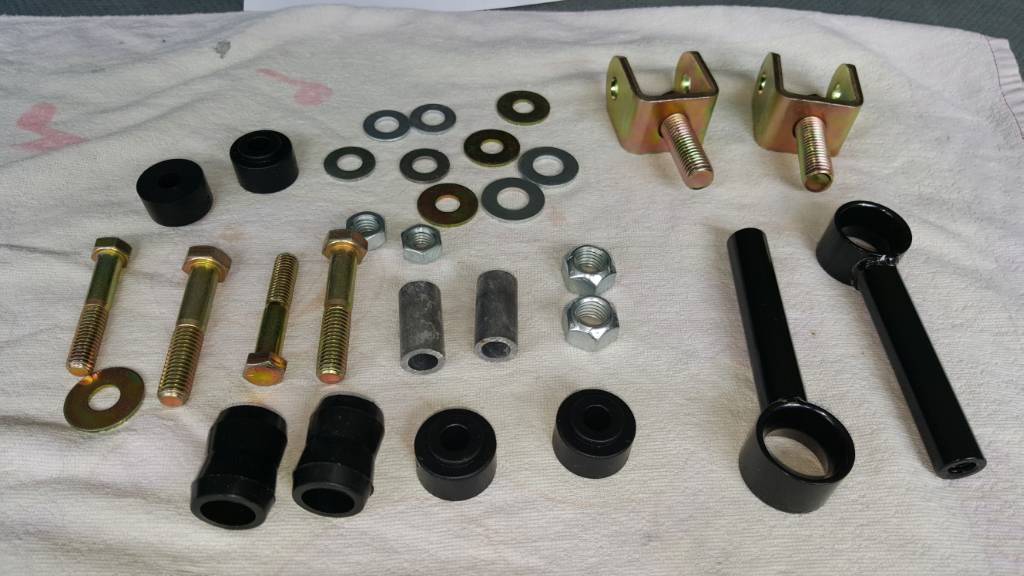

Here's the most recent emails:
I'm sorry, I think I mixed the emails up a bit but all the information from Atomic is there. As I understand so far: my lower control arms have the right mounting point, I will only need the stud adapter pictured below for the top, and I'll have to measure and have him put together the correct length coilovers! As long as I don't want the front end of my truck too much higher (I'm only leveled with the stock keys as I sit now) the UCA's should clear. Worst case scenario I would have to run Cognitos or I suppose the Zones. So my uneducated guess is as long as you are running Cognitos already, this will work! And I suppose reinforcing the LCA's would be wise but that's something I am not capable of but you probably are.

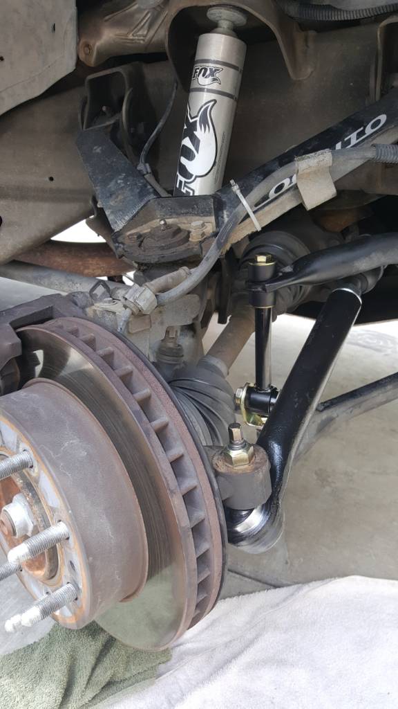

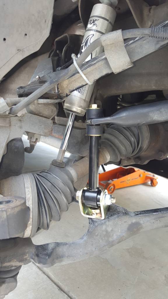

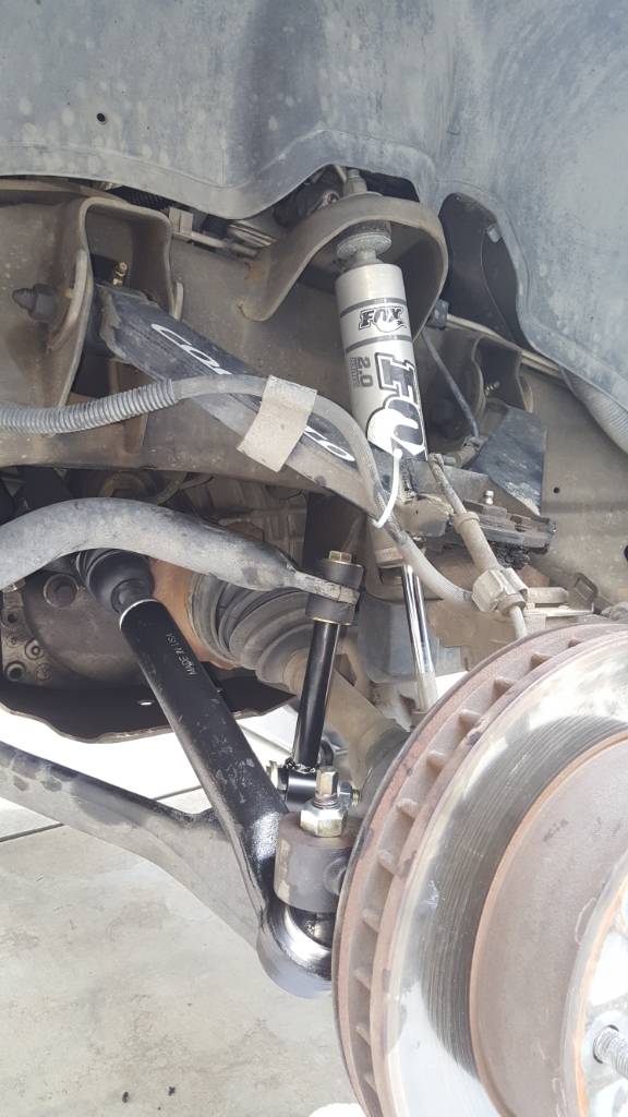

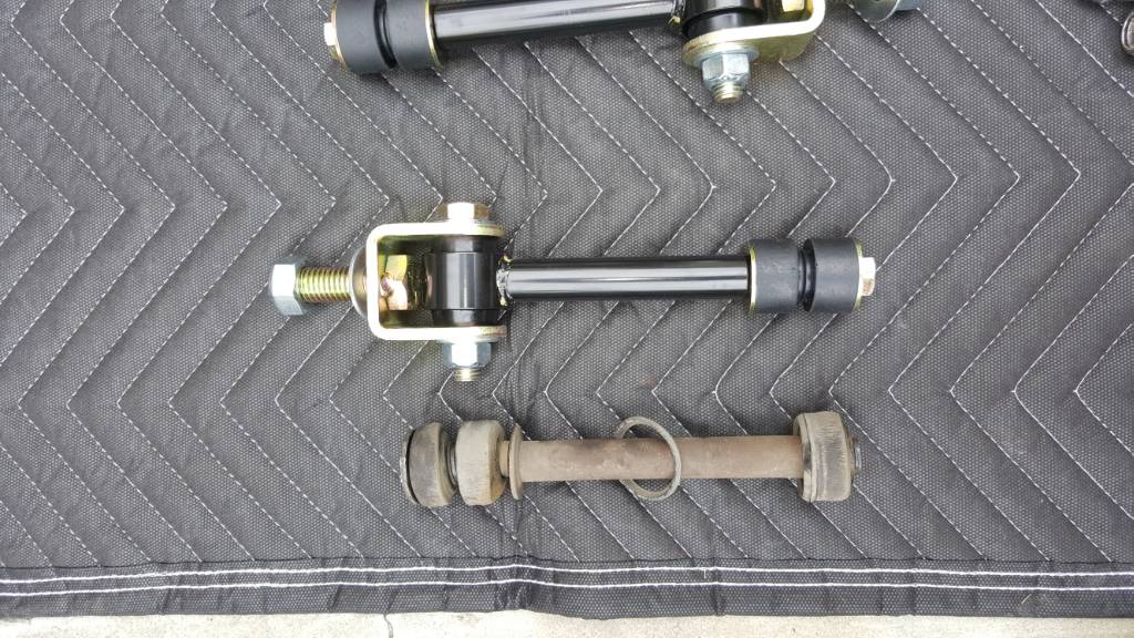

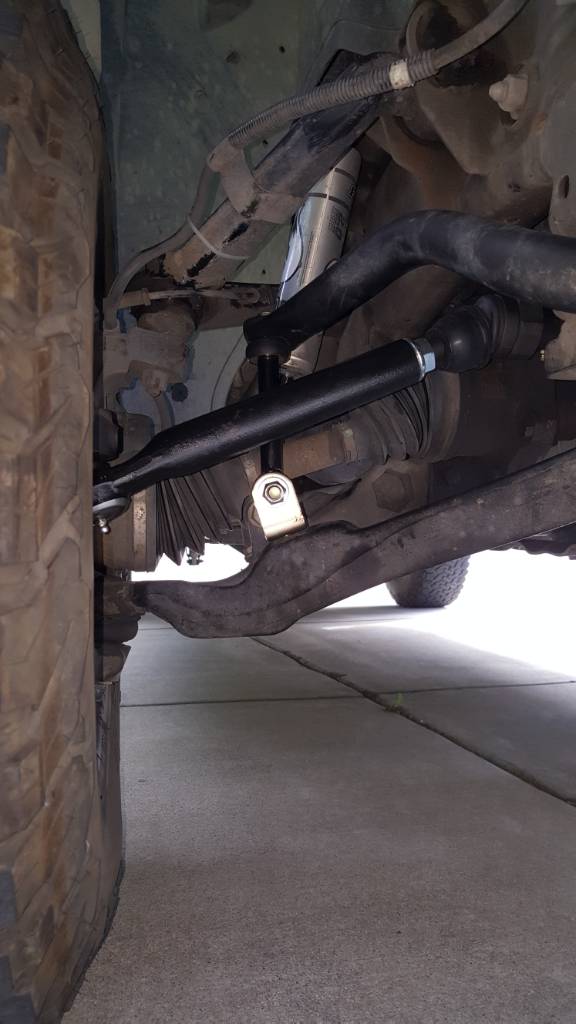

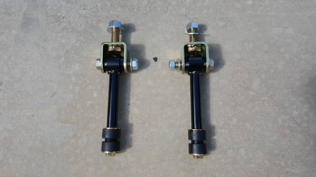

I wasn't able to install as I needed the Cognito endlinks that allow clearance for the Rare Parts tie rods last weekend. So Cognito endlinks SBELKHD-1000 we're ordered and came in yesterday. These will fit stock height to 3" leveled Trucks and suvs.
Notice how the sway bar has much more clearance. Just got her aligned nice tight and straight! Really happy with these upgrades.

Very nice Suburban!! I'm digging the suspension upgrades!! I've been trying to figure out an upgraded sway bar end link solution for my truck, and I think I just found it thanks to you! I've been using the "HD" Moog's, and keep chewing them up about once a month. Most likely due to some of the heavy off-roading that I've put my truck through, along side my torsion bars being cranked up a bit.
