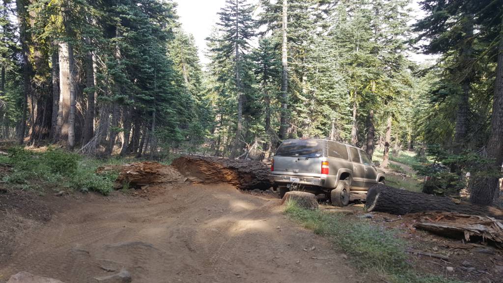

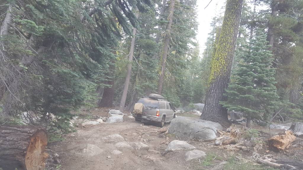

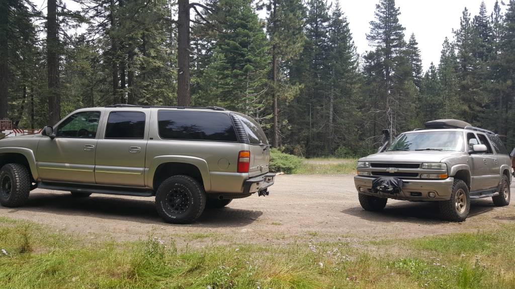

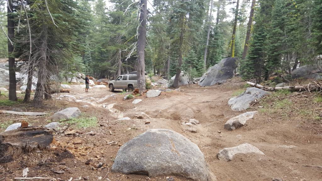

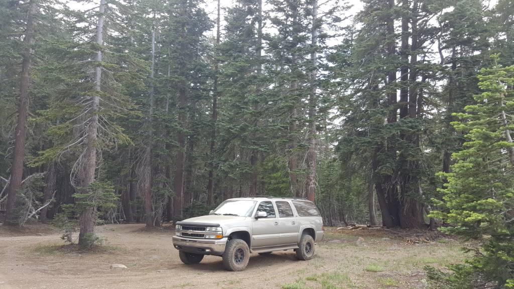

We (Jelorian) did the full Corral Hollow trail this past weekend and came out pretty much unscathed. However i did rub both of my running boards on the tight switchbacks on a rock and tree truck. Rock sliders are a must next mod. The trail was easy up to the cabin the remaining trail was moderate with the toughest part was navigating the large rocky sections and switchbacks.
I think it would be a lot more difficult if we came in on 7N35 vs 7N09 trail head. That would have been pretty difficult going up that side in the burb most likely 4LO up that side for sure. Rocks ruts washout exposed tree trunks, tight switchbacks. All in all an awesome trail!
Here are some pics..

Love the stance with all the suspension mods you've installed. I think that amount of lift looks more pronounced in the Burbs than the Tahoes.

No doubt I'll make sure to ping you on the next one bud! That trail was a blast to do! The last trip I had prior we had 4 Suburbans all Pewter metallic so a dark grey one would add some flavor..lol

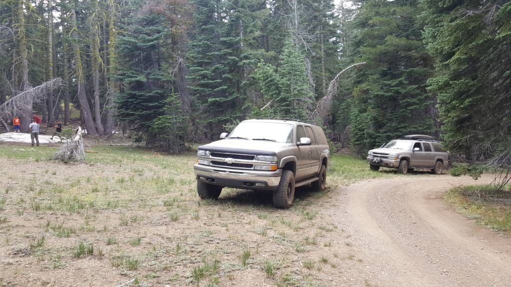

There all Suburbans. I can see the one in the shot your thinking of he linex it and painted an off grey color iirc. It has a Rough country 5" lift with front coilover convertion and 14 bolt swap, sliders, custom built bumper with integrated air tank. That thing floats over terrain my buddy in an FJ couldn't keep up with him on the trail!

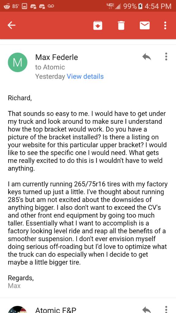

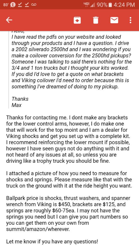

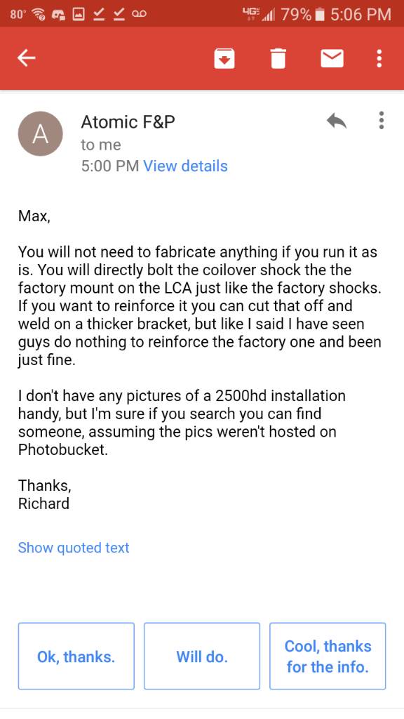

BDS would be epic. But I emailed the guy and it sounds like he has a way to make it work. I'll attach a screenshot of the email. It sounds like the upper mounts work and something needs done with the lower. What do you think @boss324
Sent from my SM-J320V using Tapatalk
I want to drive like a trophy truck! Well who else has run them on the 2500s? Not sure what "need to do something for the LCA" means??? Is there a forum he can direct us to for testimonials on his gear?

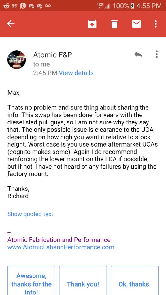

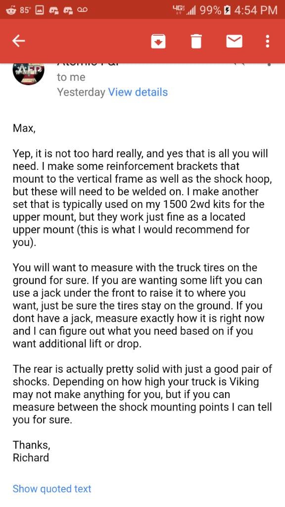

I emailed him back and asked for more information on the LCA bracket situation. I'm not a metal fabricator so I know if it required that I wouldn't be able to do it... But there's a lot of people who could.
I still have a lot to learn about all of this but I still think this would be amazing.... Especially if it can be done for less than a grand for parts and it's all bolt on.
EDIT: OK this is the email I just got back from him

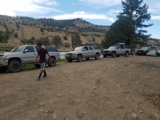

Burb One
Hey Max- Thanks for the kind words over on Expo! Good looking plan you've got. Glad you talked to Atomic, nice guy and he'll hook you up! It was my understanding the mounts cannot but used with 2500, and even modification it would be hard because the angle of the spring would end up hitting the UCA's, but maybe things have changed since I last looked or maybe difference between 2500 and 2500hd, so atomic probably has something in mind... Looking forward to seeing it.
Boss- thanks for the compliments, only two corrections, Truck is on 33's, and I'm not that sharp:)

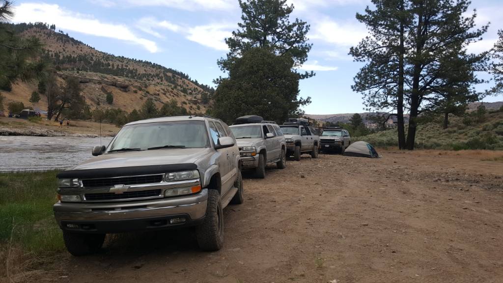

I think Jelorian took all the good pictures, this is the only one I have of the trucks lined up from the trip, but 2500 to 1500 lifted heights can be seen.
Mine is the 2nd from rear with a 5-6 inch RC lift (about 5.5 over stock) w/ coilovers and 33's The one behind me is 1500 5-6 inch lift on 31's, in front of me is 1500 w/ 2 inch with 33's and Boss is 2500, 2 inch with 33's?
Any questions, PM me or post over on Expo, I get an email reminder there...

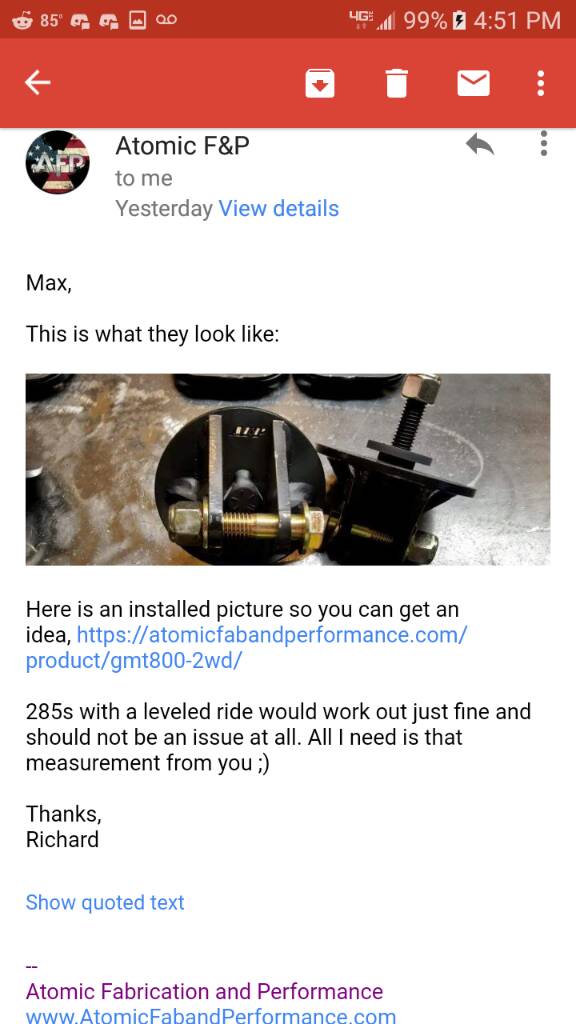

Hello! You're very welcome! Good to see you post here. I'll post up some correspondence I've gotten from Atomic and I'm hoping the only issues I have is the money haha. I also hope this information will benefit others with rigs like you fellas have and give Atomic more business!
Here's the most recent emails:
I'm sorry, I think I mixed the emails up a bit but all the information from Atomic is there. As I understand so far: my lower control arms have the right mounting point, I will only need the stud adapter pictured below for the top, and I'll have to measure and have him put together the correct length coilovers! As long as I don't want the front end of my truck too much higher (I'm only leveled with the stock keys as I sit now) the UCA's should clear. Worst case scenario I would have to run Cognitos or I suppose the Zones. So my uneducated guess is as long as you are running Cognitos already, this will work! And I suppose reinforcing the LCA's would be wise but that's something I am not capable of but you probably are.
