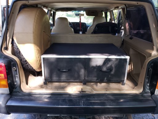

As mentioned in the Cherokee forum I've had good luck with the Crowns and MOOG coils on 3 Jeeps now. I got the 750 in/lb or whatever they were heavy springs and they've performed well for me. Nice drawer setup in the back.
