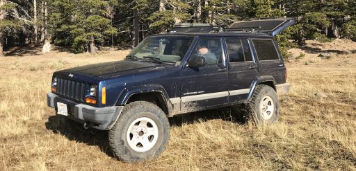

Thumbs up on the XJ, I've loved mine. I'm on my second and am also just starting some upgrades on this one. I wanted to try out the Quadratec 3" lift, which at $219 with reasonable shocks is a steal. Install was good, but they left out leaf spring retaining clips and a shock mounting bushing crushed on install. Clearance in the front was maybe more than 3" and the rear right at. I fit 31x10.50 wth 2" spacers and get some rub on full lock. I was expecting that, so will trim the fenders and do Bushwackers next. I might need a helper spring or a new rear pack when fully loaded and the weight of a new rear bumper. I have a full write up and will be detailing the build .

Looks good! I definitely recommend a full leaf, especially if you plan to load it (they are easier to install too)
Yeah, I had a RE setup on my last rig, but doing a experiment on budget systems to see what the limits are. I'll be be bumping to a 4" lift and 33" tires in the spring prior to a Rubicon run.
