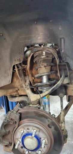

I will say, without a proper shop or a wall-mounted heavy duty spring compressor, swapping out the front coil-overs is best left to a professional. So, while I removed the front, I did ultimately have to bring them to a shop for compression and swap out. By the time I paid for that, I maybe should have gotten something that comes with the spring already mounted on the shock.

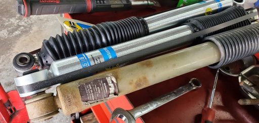

im lucky to be a tech and have all the tools i need to perform any job on my truck but even looking at prices and labor cost it really is hard to beat the 5100s the cost to performance quality is a rather great deal. i was trying to hold off on the 5100s because we are in process of becoming an icon dealer and will be going to icon coil over lift but with covid that has been delayed into beginning of 2021. but i sure am happy i did the 5100s. so much better than worn out 130k stock struts.
also i wish there was an option to gain a little suspension travel up front with out having to cut frame and go to a giant lower cross member. i want a little more ground clearance but it does not seem to be an option without spending thousands on cross members and what not.
anyway heres a couple pics from the install you can see the garbage the previous owner put in the rear. i pulled them out and the just collapsed rear shocks were not even doing the shock thing there supposed to do 20200630_180355.jpg20200630_194544.jpg

Although I happen to have a lot of hand tools and such, I am not a mechanic. So I like to try what I can, and have to watch my limits. Sometimes I think I'm going to save $ but I hit a snag and, whoops!
This was definitely one of those times. I'll get some pics up. I got everything out OK, but the retaining nuts at the top ce ters of the coil-overs looked like they were one with the spindle. More importantly, the silly, flimsy, hand tool-only spring compressor was nowhere near up to the task, so discretion was the better part of valor and I took it to a local guy

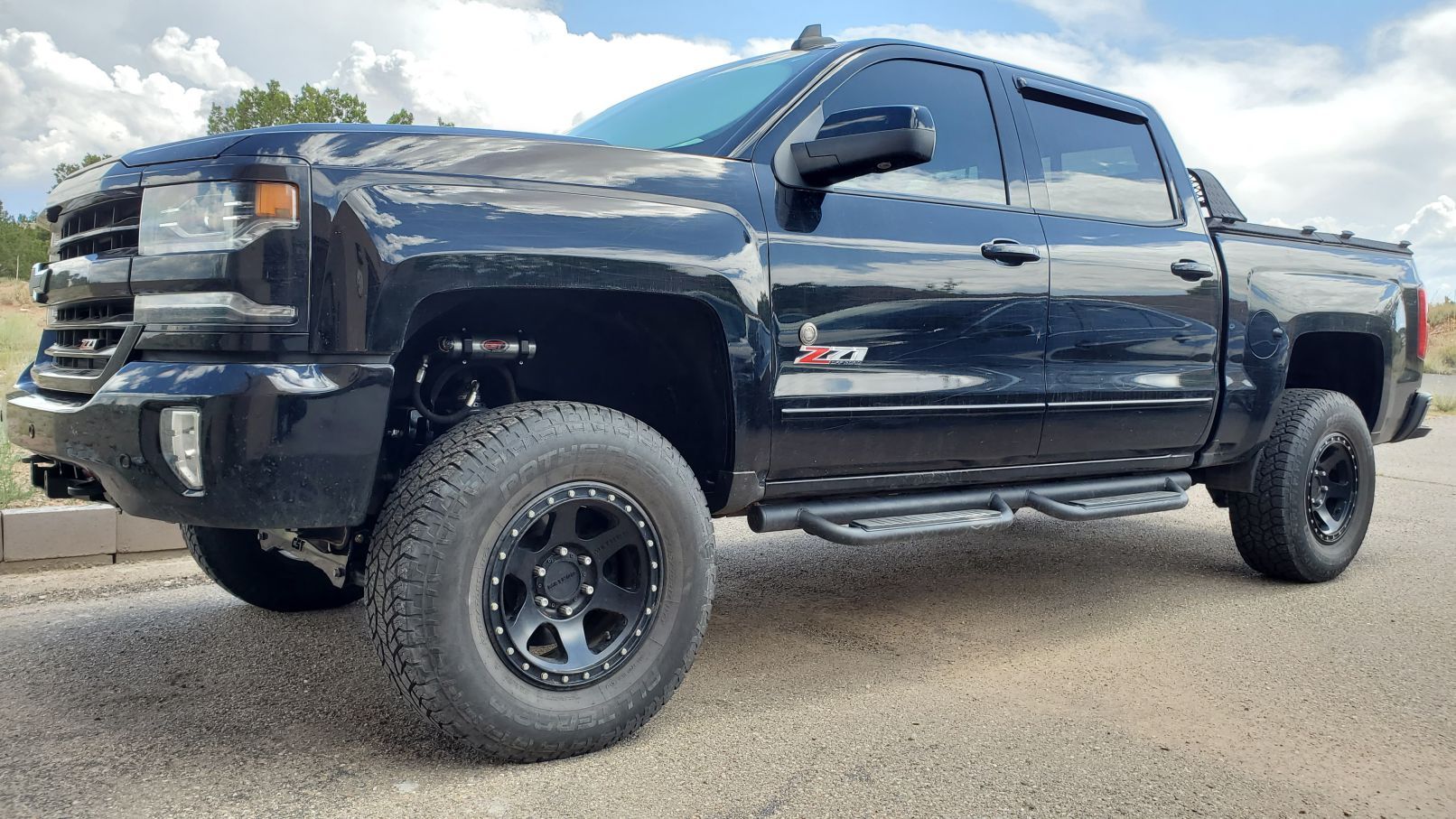

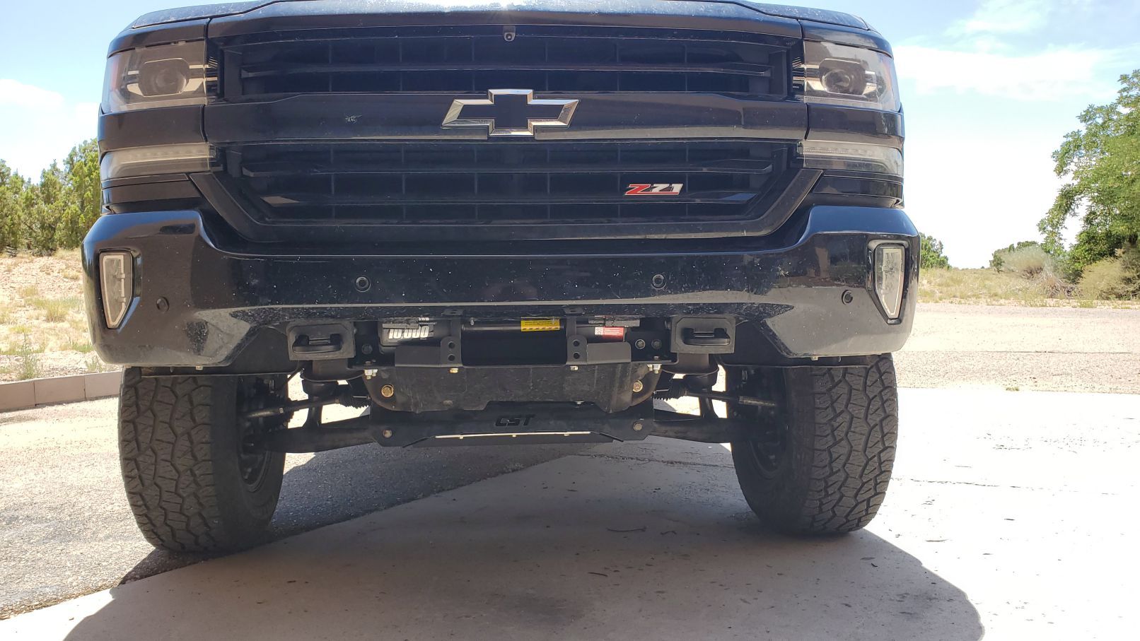

Just finished up my '17 Silverado CST4.5 lift, with the optional CST shocks. These shocks are da-bomb, fully adjustable and very comfortable. When i get a second battery, the hidden SmittyBuilt 10k winch will be functional.
Very nice! I'd love to find a set of steps or sliders like that which extend as near the rear wheel as they do the front. It would help reaching in for cargo from the sides
Those steps are the stock Chevy "Off-Road" steps. I'm thinking about building my own sliders with removable steps for street use. Or, maybe just going full on street with some Amp Research auto-steps that drop down automagically.
Can you fit 37's with that lift?
