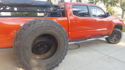

No worries, glad to help. I was tired of using the ECT button ALL THE DAMN TIME. Practically made the truck immobile in some situations, like safely merging onto interstate traffic.... Got back from Colorado a few weeks ago and shifting was horrible in the mountains. Big difference now.
My latest mod
