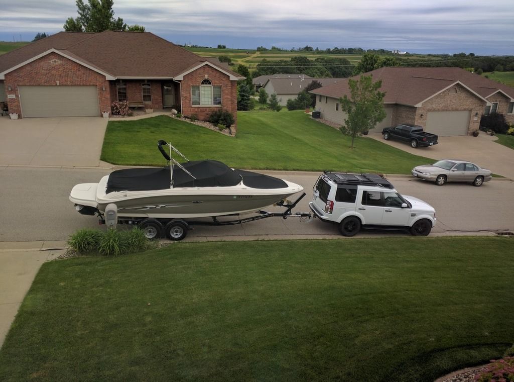

A full size would certainly tow, but then you have... a full sized rig to squeeze between things and maneuver. The turning radius, breakover angles (heck all the angles) leave a bit to be desired. You will have to commit to limiting the places you really want to go. Depends on the capability of what you are towing also, it should match somewhat.
My (obviously biased) favorite tow rig is a Land Rover LR4 (same would be said for LR3). 7700 lbs, 770lb tongue weight. 2010-2013 5.0L direct injected jaguar V8, 375hp/375ftlb.
I tow a 26' Sea Ray, 6000+ lb. obviously not off road, but its an amazing tow vehicle. Air suspension doesn't feel worked at all. And yet still small wheel base, narrow, and turning radius is amazing.
