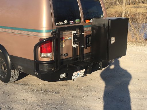

The 94 F350 can hide a 15,000 pound behind the stock bumper very well.
View attachment 197141View attachment 197142View attachment 197143
It can, youre right. It will fit. I just have a style of bumper i like to build for my rigs. It allows me to mount the winch in to a receiver hitch i fab in to my front and back bumpers. That way i can store my winch in the tool box and then choose weather i think i should pull myself through something or pull myself back out of something. I throw it on the back for things like water crossings or steep decents. And on the front to get up and over stuff or out of holes. Adds versatility. Pulling off the front isn’t always the best option. Sometimes its just easier to go back and pick another line.

I’ve seen hidden front receiver mounts on the front of the Areos as well. As for pulling the whole front end off... I’m more concerned with ripping the frame out from under the truck... besides... if I tweek the bumper I can get a new one for $50.00 at the wrecking yard.
