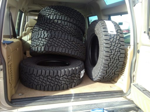

My new goodyear wrangler ULTRATERRAIN tires in 265/75/16 are sort of in between a normal all terrain tire and a mud terrain tire. 10 ply tire with 3 ply sidewalls, snow rated. Overall customer rating of 4.7 out of 5. I paid $899.00 for 5 tires and received a $140.00 discount from discount auto then paid almost $100 for the mount and balance. The rating was slightly better than a k02 tire but quite a bit less expensive. I would have bought Milestone Patagonias if they had them in stock, they too are an awesome tire and cheaper than all.

I can show you better than I can write about the Goodyear Wrangler Ultraterrain AT tire. It is not even close to what you describe here. This tire is a beast, so aggressive there is no mileage warranty. You are right about it being a new tire on the market and only Discount tire sells them. I'm not sure of the sidewall ply, I was told it was 3 ply but I cant find the info in the sales literature anywhere. The salesman told me that 3 ply was exceptional to any Radial a/t tire. Most are 2 ply. Standard non radials may be as high as 10 ply.
