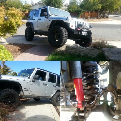

Finally installed my Teraflex Bump Stop Extenders up front. I didn't install any when I did my lift a few years back and Ehrrmergerd when I would come off rocks or ledges, the pucker factor of the front end smashing/bottoming out was very unnerving. I did it with the help of my 7yo son and then tested it on my front yard landscaping rocks. Very happy and much less pucker factor now!

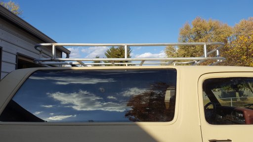

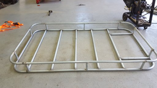

Working on a roof top basket for Dam Roger. At this point I have the bottom section welded up and the top rail tact on. I am waiting on a dimpling tool to complete some side panels that will add rigidity to the thing. I also have to come up with some attachment point connections. More fab work this week at the Booger Welding Company.:smiley:View attachment 9467 View attachment 9468

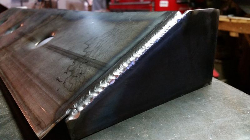

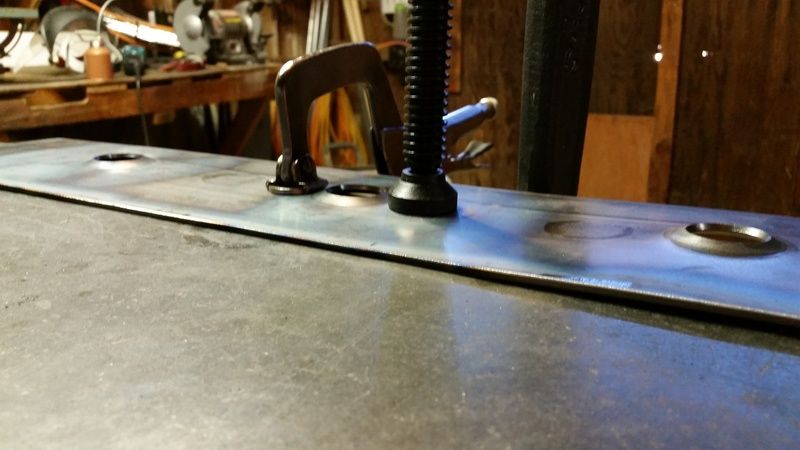

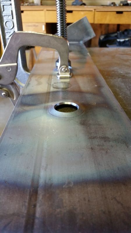

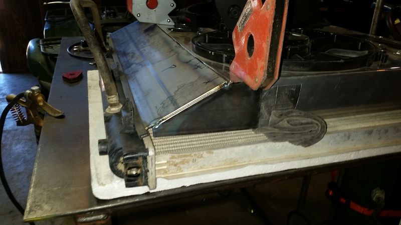

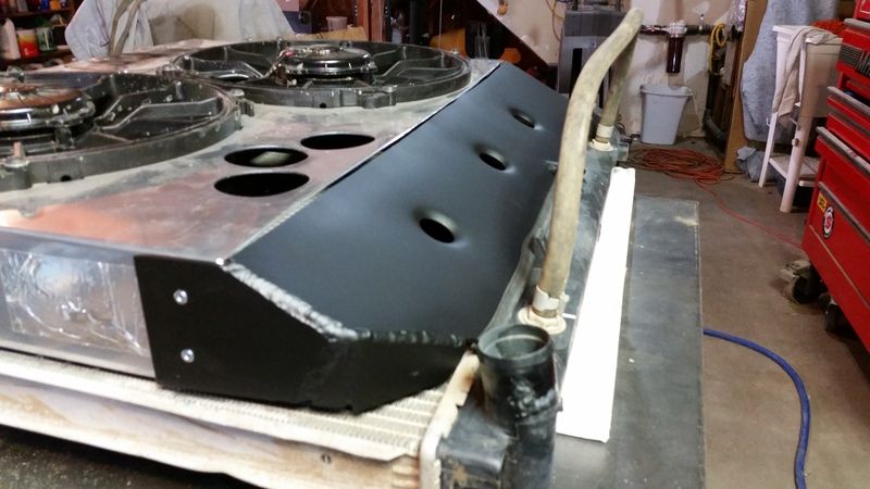

Had to pull the fan back out. I wanted to add more support to take some weight off of the top radiator mount points. I also wanted to expand the fairing in order to increase the area that the fans drew through the radiator. So I cut off the bottom of the fan fairing and fabbed a new combination support and fairing that would take advantage of the old mount locations on the bottom of the radiator.
Mock up.
DIMPLES!
Between cutting heat and dimpling, this panel was an arch. With some creative heating I got it reasonably straight.
Meh. Rusty on the TIG machine.
Everything looks good in flat black.
