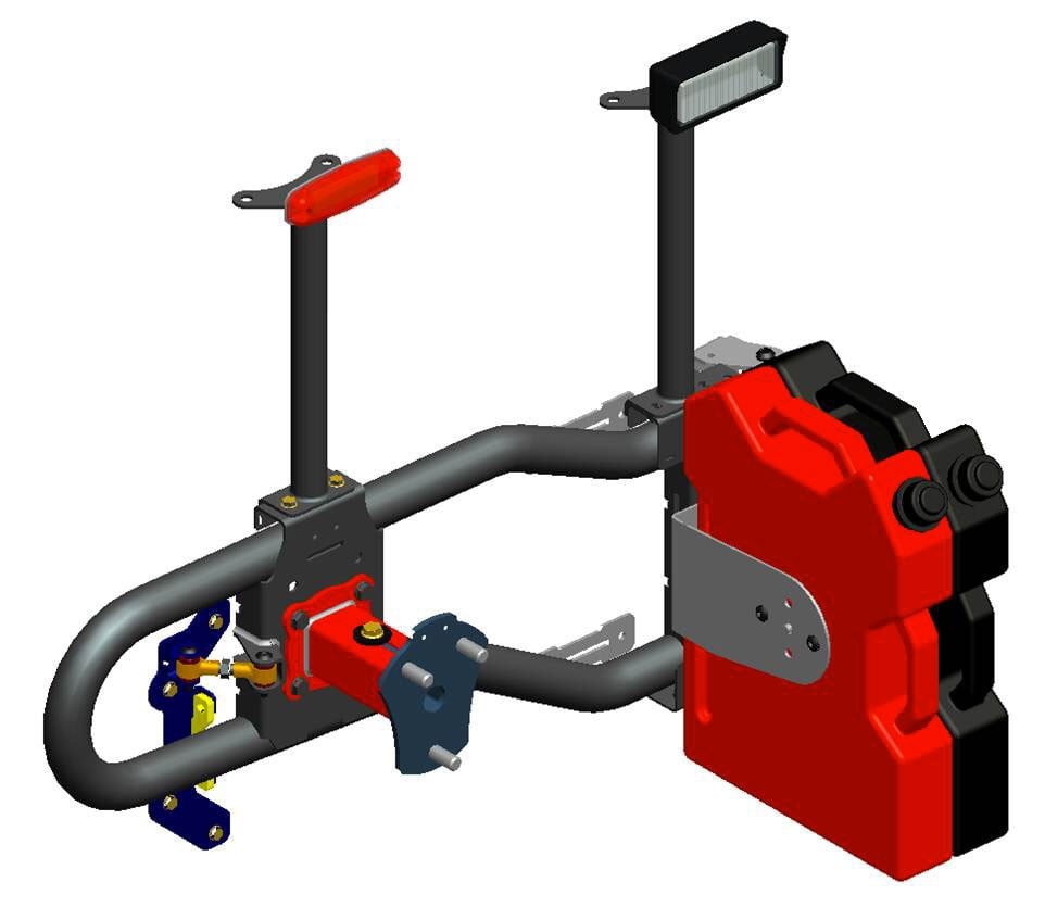

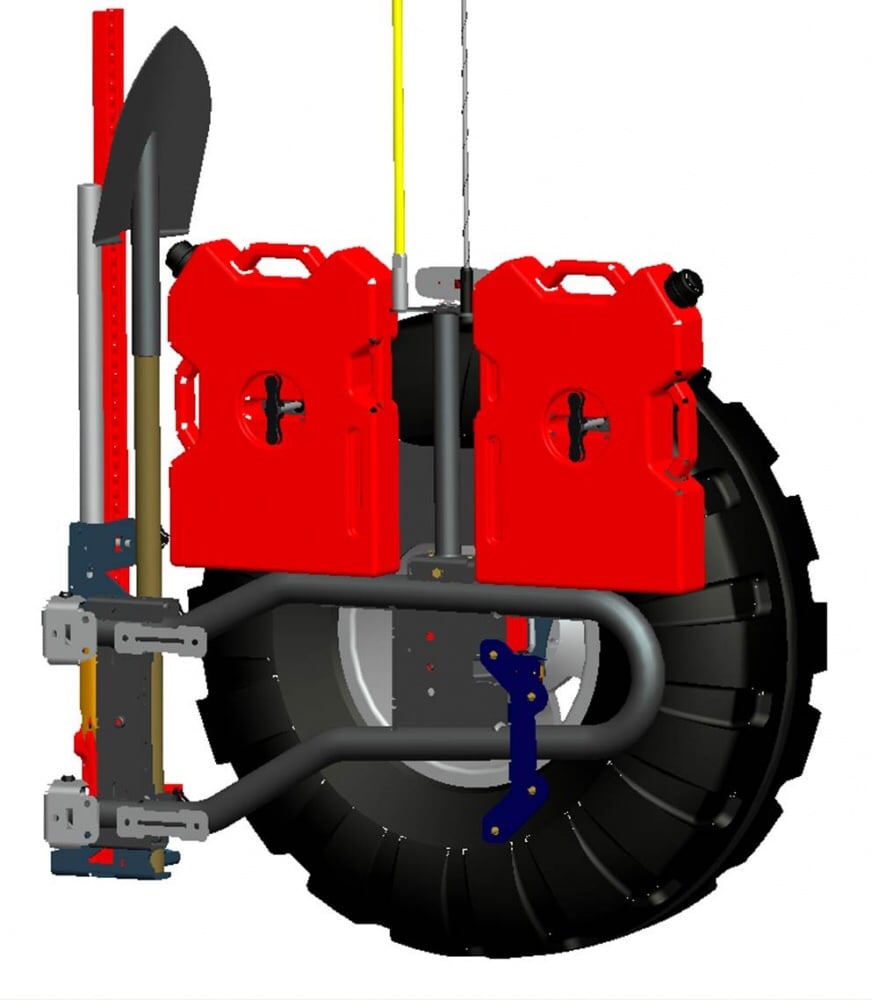

Real nice set up Jonathan, I like it a lot. Do you have a pic of it with out the tire on to see how you mounted it up.
I don't, I can get one. I still have to find a place for my backup camera. The tire carrier is a maximus-3 and so are the rotopax/jack mounts.
Awesome!!! Thanks I'll look them up and see if the Carrier will be able to hold a 35" tire. Thanks again for the pics and info.

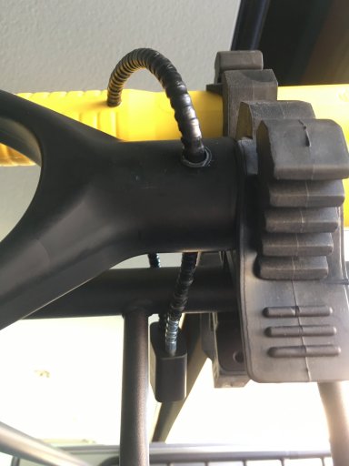

Was already locking up the shovel but you've gotta protect the beaver AND axe.
Tom if you don't mind can you post a pic of your shovel and ax that the lock works for. Or the site where you purchased it. Thank you sir.
The shovel is made by https://krazybeavertools.com and I drilled a hole near the end of the handle of my Pulaski to pass the cable lock through.

Awesome!!! Thanks I'll look them up and see if the Carrie will be able to hold a 35" tire. Thanks again for the pics and info.
No problem. I can assure you it can handle a 35" tire. I'm running 315/70/17, only because they don't make duratracs on 35x12.5r17.
Sweet! And thanks for the info and heads up on the locking part of it. I actually have like three spares of those types of locks that will come in handy for that set up.

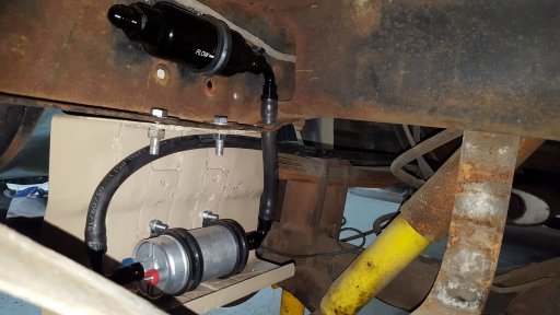

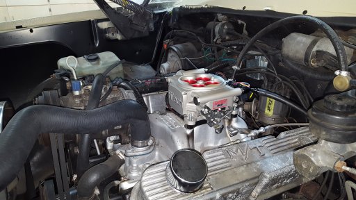

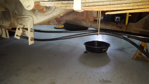

I have been trying to swap over from carburetor to FiTech fuel injection. Easy swap they say. Yeah that hasn't quite been the deal. First I had to build a bracket to mount the fuel pump. Then I had to build all the fuel lines and of course that wasn't a straight up deal either. I had to use several 90 degree fittings which were not quick or easy. The straight fitting could be pushed on without any real work but the 90 degree fittings required a new tool from Kool Tools and it is really cool, but expensive. Well I had every thing test fitted and found out I was short on return fuel line so while I was waiting I started working on the rear brakes. I had to replace everything but the drums and backing plates. This also included the parking brake cables. Of course the cables show up and one is the old style and the other is a newer style which brought me to a halt again trying to get a matching cable.

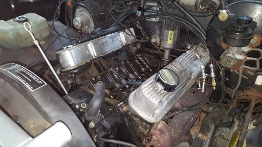

So while I am waiting on cables I decide to work on a couple of other pieces of the FiTech system, one of which is installing a temperature sending unit in the intake manifold. Not a problem right! I ended up haveing to pull the intake off so I can take it to the shop to get it put in. 20160813_112917.jpg 20160813_112945.jpg 20160821_140630.jpg 20160821_140649.jpg Well I guess I will have the rig on the road some time in 2017 at this rate!

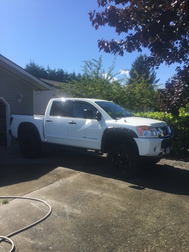

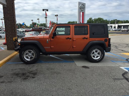

Well not entirely true...I pre inspected and sized up a spot for my ARB diff breather kit. And I measured the box for my weather guard slide out. But alas it won't fit. So on to more inter web searching! Hope you all are having a productive day!!!

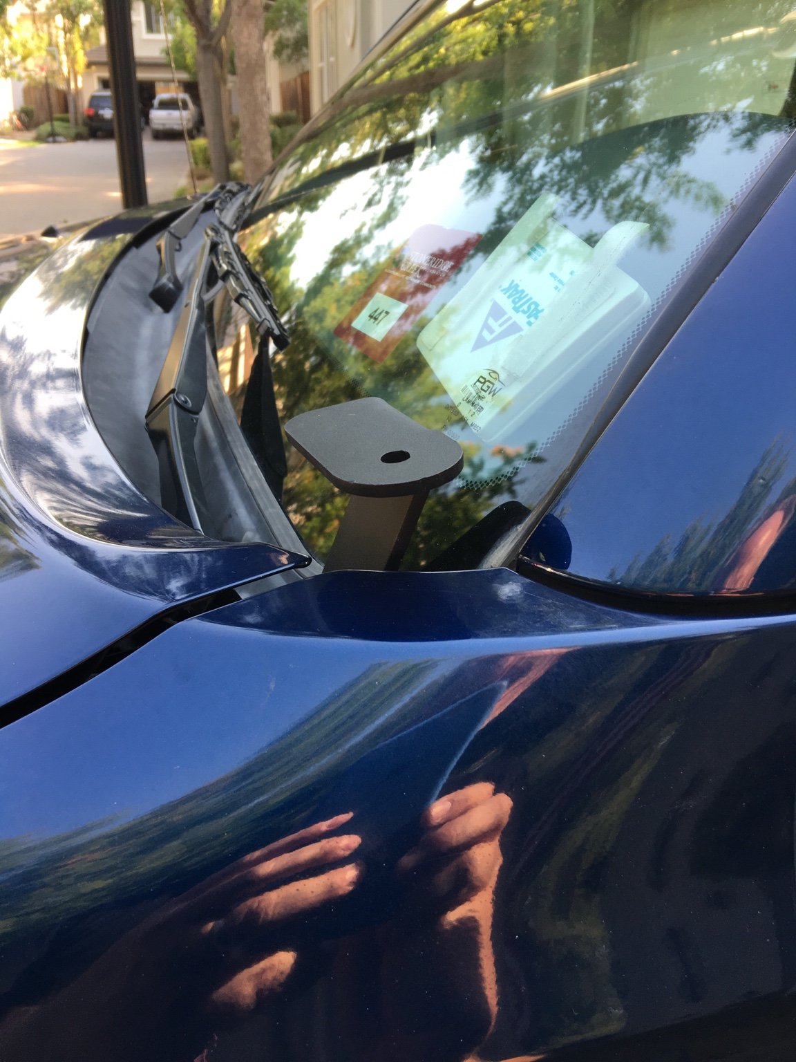

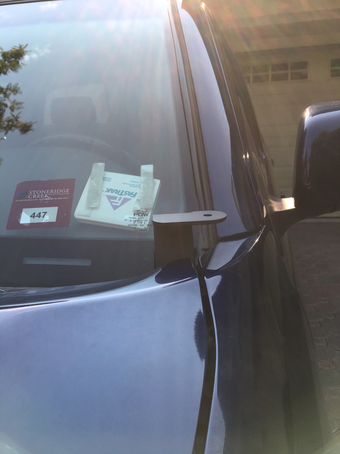

Today I am one step closer to installing a CB in the Tacoma. I purchased and installed a CBI drivers side antenna bracket. Next step is to order a Firestik.

Interesting mount. What happens when you have to get your windshield replaced?

I considered that too. It will have to be unbolted and moved out of the way when the windshield needs to be replaced. I think the same issue exists for the ditch light brackets some people run in that same location, but I would like to hear from someone who has them.

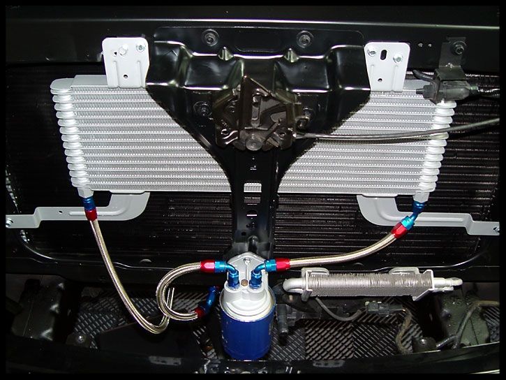

Today was installing the Tow Mirrors and getting the new stock Fog Light housings prepped to go in. These Tow mirrors are going to kill me on the trail but I need them to tow the boat and trailer. All my AN fittings came in as well for the Big Superduty Trans Cooler and remote filter.
Those are turning into This..
