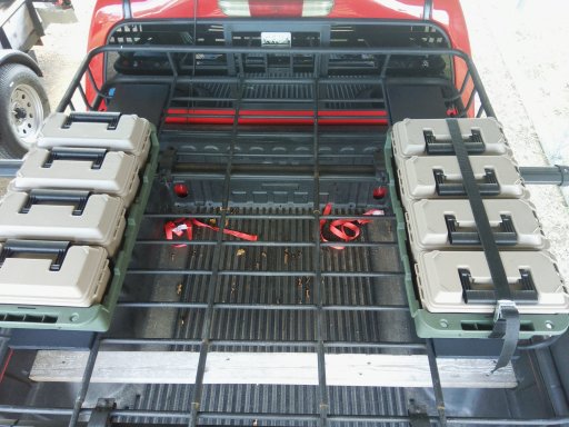

Permanently attached the ammo can storage system to the rack. Instead of the whole system being strapped to the rack, the crate is now bolted to the rack and the cans are strapped to the crate like they are supposed to be.

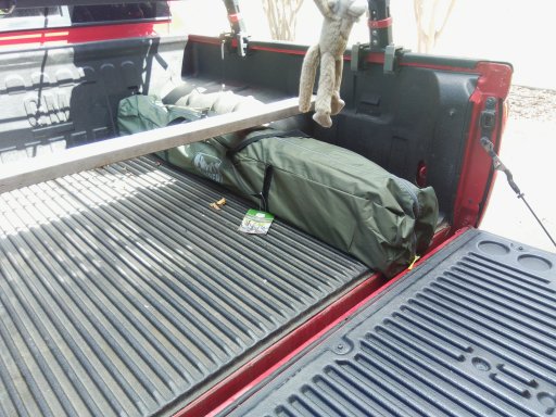

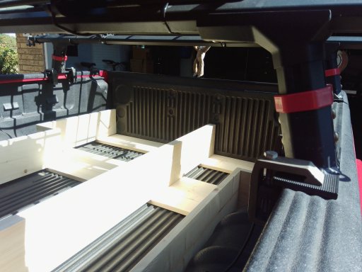

The "benefit" of having a vehicle nobody makes anything for is literally having to fabricate everything yourself.
Today's project: Home made bed drawers. Each side can be installed individually so I can use one or both as needed. Plus, they can easily be removed altogether when I need to use the whole bed.
Measuring to custom fit the Blackstone travel griddle -
Driver side frame done -
Passenger side done -
With the tailgate closed, everything is held tight -

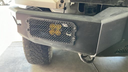

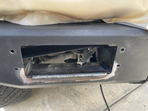

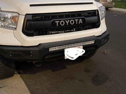

Bumper installed, and finally got shorter brackets to re-install light bar. Waiting on BD squadron sports for fogs. I'll have to fabricate and weld in some mounting plates for them in the corner holes.
