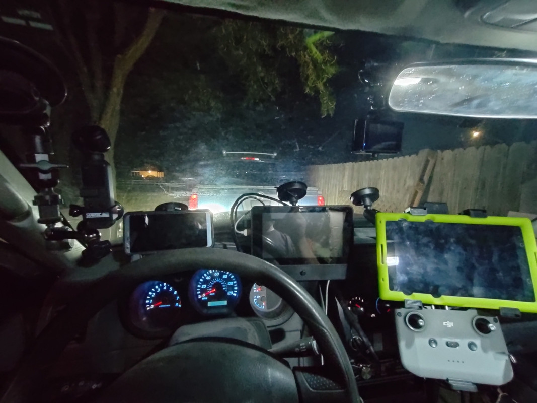

And the most recent thing has been figuring out how to mount and power camera equipment.
Right to left - dji osmo pocket, phone to monitor/control osmo pocket, android auto navigation/music, dji Mavic air 2 control, action camera up by the mirror. There's a backpack on the passenger seat with two more action cameras, and a full size osmo as well as other items.

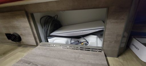

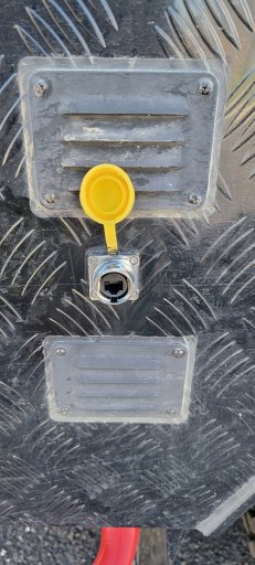

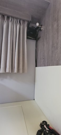

It has been a week long ordeal. I got my Starlink and wanted to run it all off of DC for the trailer. Probably would have been quicker if the first PoE injector wasnt bad. But got the inverter, stepup convertet to 48v and tested to make sure I had dishy power. Dishy McFlatface fits perfect in one of the storage areas, used the shipping packaging so it doest slide around. and last It passes though the outside of the RV with a waterproof connector so im bot running wires through doors or windows. Just need a telescoping pole to mount dishy on. Router hooked up inside and out of the way. going to wait to install the wire runners to make sure thats where I want it.

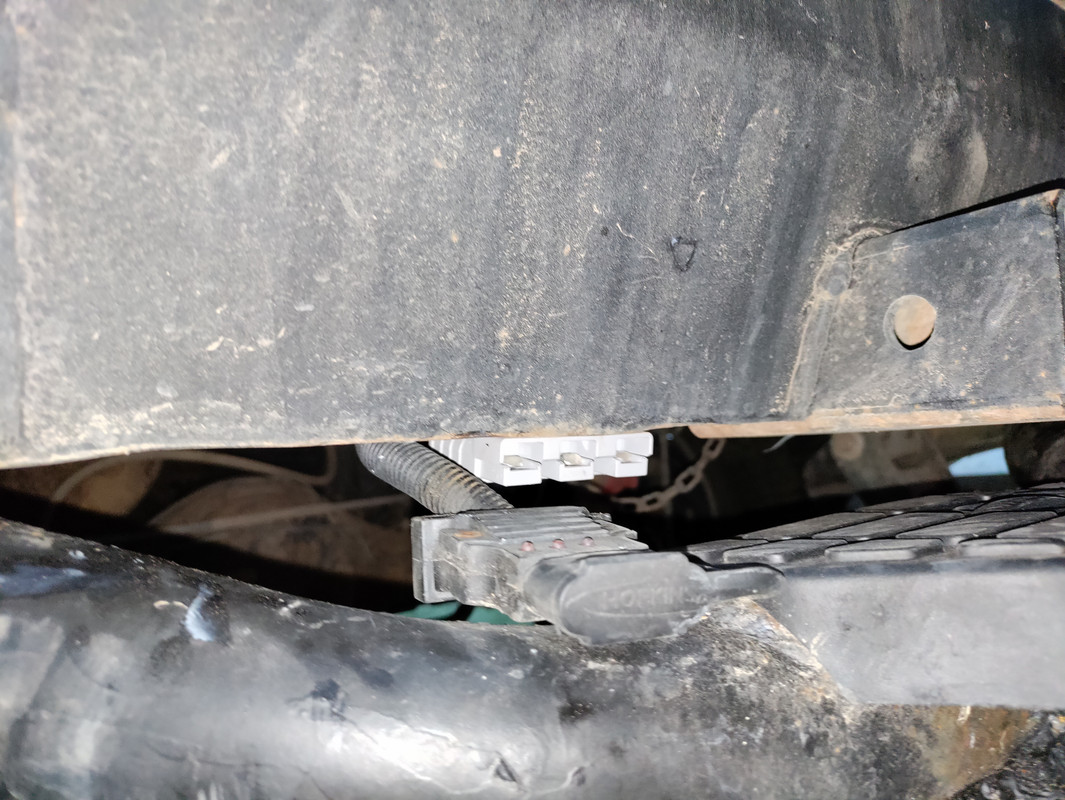

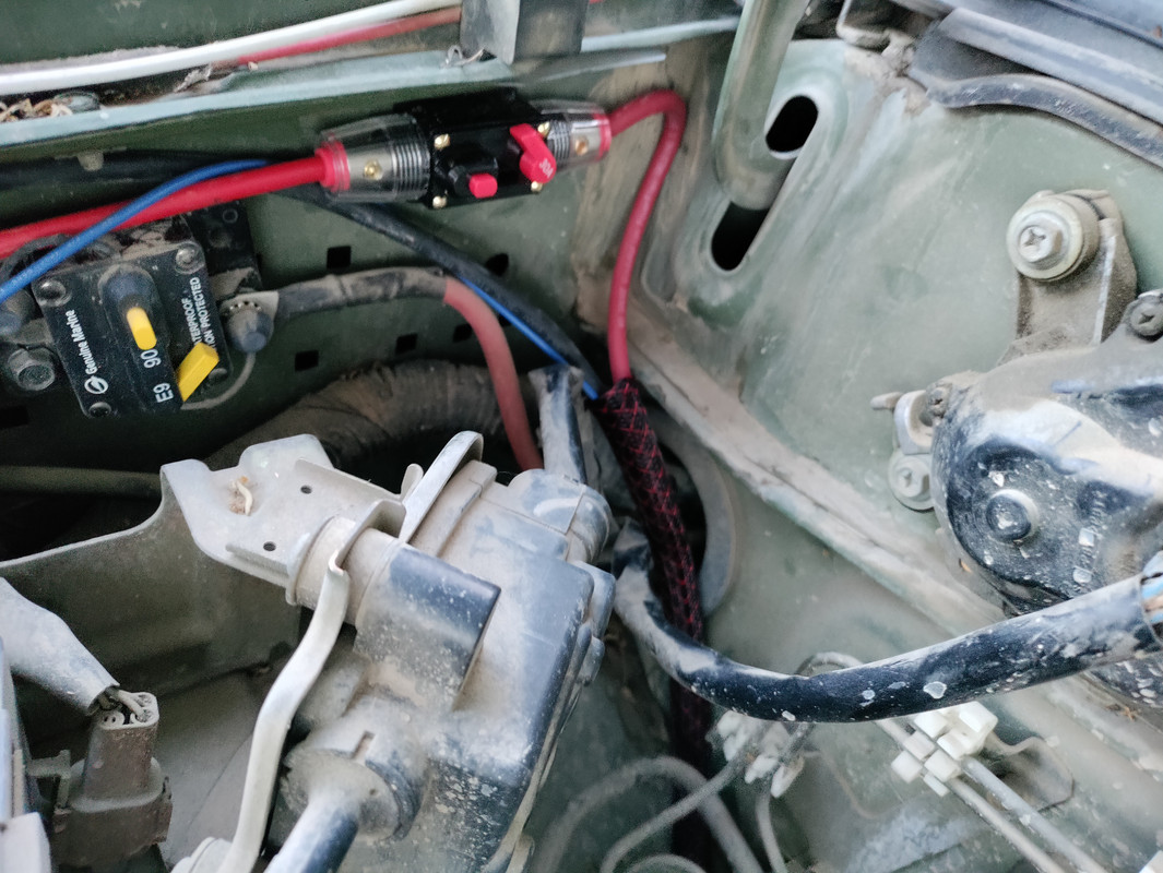

Last night, I went to test the DC-DC charging and trailer lights when hooked up to the Xterra (I've been towing it with the truck).
DC-DC charging wasn't working, but then I decided to pop the hood, and check the breaker.... I forgot to close the breaker switch.
And.... The tail lights work!!
Though the driver's side blinker in the plug on the Xterra is a bit finicky. I'll have to look into what I can do about that. Maybe it's got some dirt in there.
