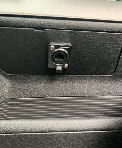

That looks great! What type of connectors/extension did you use for the remote mount?
I used the midland MXTA31 Extension cable from the unit into the center console and then used a .5ft Cat5e cable to connect between the extension cable to the RJ45 mount socket. The mic extension cable came with my unit and I had already fed it under the center console awhile back, otherwise I would of just ran a longer Cat5E cable from the unit to the RJ45 Socket.
Parts List:
Mic Ext Cable - MicroMobile® MXTA31 Microphone Extension Cable
RJ45 Socket - Cat5E cable -

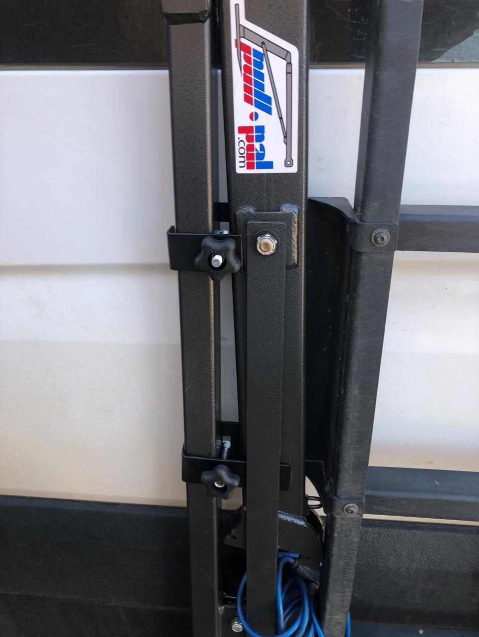

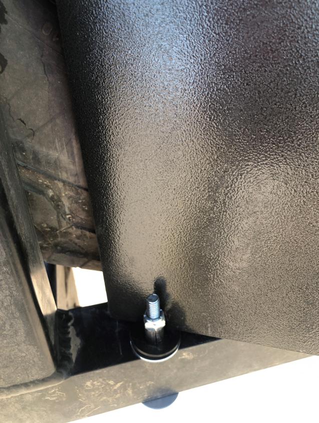

Got together with a friend who has a metal shop and made some mounts for the Pull Pal.
The lever arm mounts to the VanCompass Hi Lift mount on the ladder. I've decided the Pull Pal is probably more useful than the Hi Lift.
The blade mounts on the back of the Aluminess spare tire swingarm.

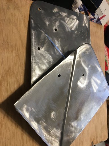

I fab'd up my radio console today in 23* weather like a idiot. LOL. This will sit on a wood platform I have already put together but need to finish sanding, priming and painting. Film at 11.
Zim
I'm going to drop in another usb port for charging also. Can never have too many charging ports. LOL
