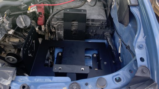

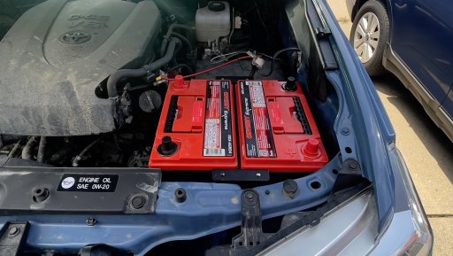

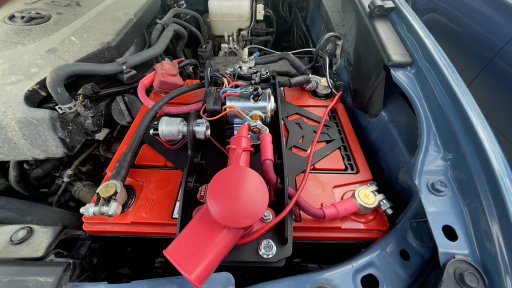

Dual Batteries have been installed on what seems like the hottest day I could have picked for SW Ohio :tearsofjoy:
Drilled and inserted Well Nuts then installed new Tray
Shimmied the Group 34 Odyssey batteries in
And installed the smart solenoid harness
Did a quick trip to the store for refreshments to test everything. Success!

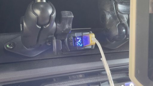

I also tuned my ECU to put out more AGM like levels. Confirmed this is accurate with voltmeter at the batteries

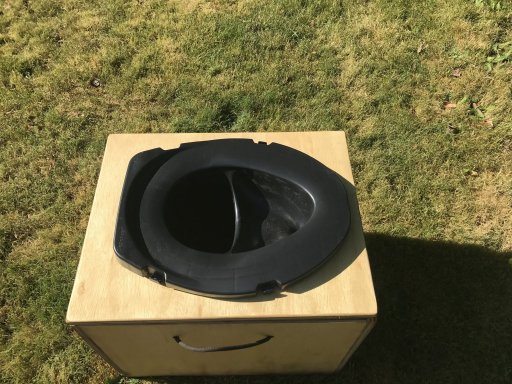

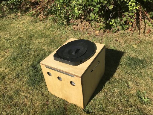

Today I finished the composting toilet project and added it to the kit that goes in the back.
Last year we did a DIY compositing toilet as a "proof of concept" to see if it was something we were even interested in. It exceeded expectations! So much better than the nasty vault toilets at the campground (especially during a pandemic) and it did not smell and was easy to deal with unlike the liquid portapotties or tanks you have to empty.. So this year took it a step further constructing a really nice one that will last forever. The bucket was not on purpose, they ran out of orange home depot buckets and this was the only one they had. Of course it was too funny that my composting toilet has a Kracken bucket or is that spelled "Crackin?" :)
View attachment 205738View attachment 205739
View attachment 205740View attachment 205741View attachment 205742
As a Canucks fan, I don't mind if you crap into that bucket.
