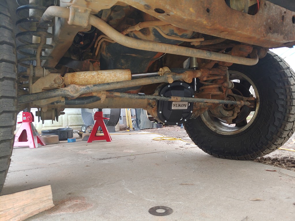

Finally got all the parts together for the front axle. 4.11 gears, bearings, seals, u-joints, and LSD installed. Also replaced the front cover with something a little more durable that has a drain plug. It's all fancy now but it shouldn't take long for it to be the same South Carolina clay color as everything else under there.

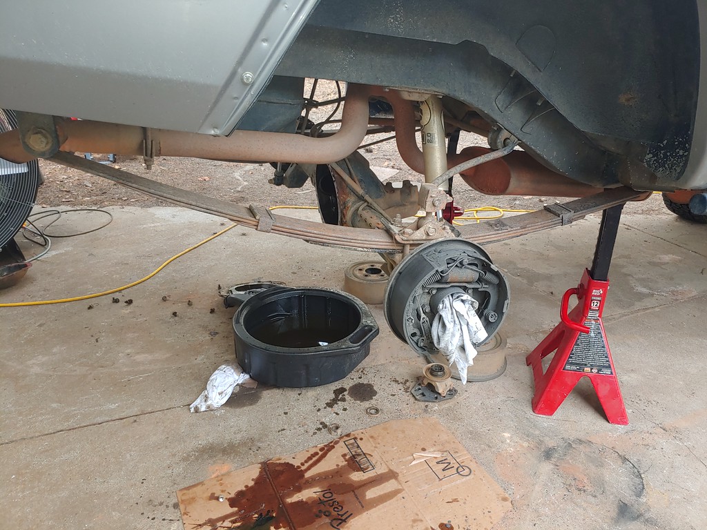

Then turned it around, put the rear in the air, and stripped it. It's getting the same treatment, gears, locker, bearings, and seals. Hope to get most of the assembly done tomorrow evening. It's a good thing this was already in the works. The driver's side axle seal had already failed and soaked the shoes. Super tempted to throw a disk brake conversion on there while it's apart.

Got started on the rear axle only to find out I have the wrong bearing kit. Amazon shipped a D44 kit instead of a Chrysler 8.25 kit. And the locker I ordered is a 29 spline and the axle under the XJ is a 27 spline. That necessitated digging the original axle out of a pile of parts behind the shop to get the shafts and carrier out of it. This whole project has been one wrong part after another.

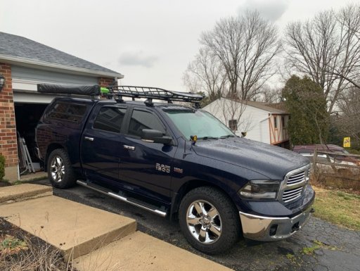

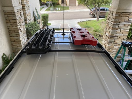

I am a few days behind, I finally got the extension for my bedrack done and bolted onto my truck
I had to take a picture at night, my extension got finished about 2:30pm I got to pick it up and I immediately had to rush to the shop. I had 2 back to back recovery jobs (tow jobs) and didn’t get done until after 9 pm, I took this picture as I am leaving to go out to the farm to get my Roofnest Falcon RTT so I can meet up with some other OB members for some wheeling and a camp out the next day.
