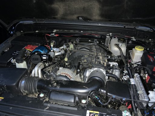

Finished up the air compressor install today. Received the 90 deg fitting earlier in the week and the boy and I wired it up today. Works well and am excited to use it. Also ordered a set of Staun deflators that should be here tomorrow (thanks @Ties for the reminder!)
New thermostat into the J200 next.
Wiring not yet installed in these pics, but you get the idea.

Finished up the J200's thermostat today. Putting it back together was easy peasy and the boy did it himself. No leaks - no RTV! Getting the housing off took a while as everything was corroded / RTV'ed in there real well. Took it slowly and carefully and used lots of PB Blaster. Ordered the wrong gasket so we got to practice our gasket making skills as well. Took the time to really clean up the mating surfaces and flattened out the removed piece with emory paper on the garage floor. Much better than before!
