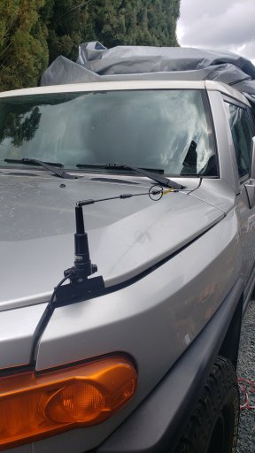

Since I added the ditch lights I have since had to find another solution for my stock antenna as well as CB antenna that was on both sides of the hood. I already bought and installed the shorty antenna for the radio. Today I installed a ditch light extension, then added my CB antenna to it. In this position and when the hood is fully extended the antenna does not touch any part of the vehicle, which is great.
As far as highway stability I still have to take a drive when this whole shelter in is done. I'm a little concerned that I might catch branches on the trail or mall so we'll have to see. Reception will has to be adjusted. Will need an open space to re-test SWR tuning.
If this solution does not work I do have a hood channel CB mount standing by. It does require drilling though. Not a fan of that lol.
This should work, especially with the spring attached. Fire Stick antenna's are very hardy antenna's.

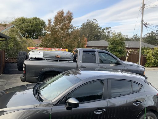

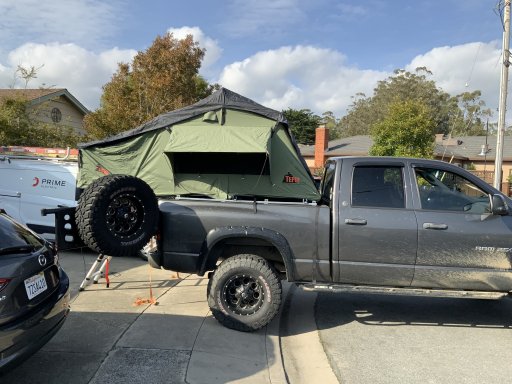

Well... considering that I’m on a Corona-cation.... I decided that instead of spending $1k+ on some “overland rack” I'd make my own for $100.... I wanted low center of gravity and lots of options.... unistrut seemed like a good choice... we shall see how it holds up. This set up is about 550lbs lighter than the previous skyscraper that we had.

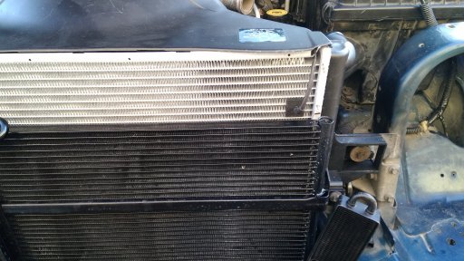

WJ is running again. Replacement radiator is all good. Left the front plastic off, still waiting for my behind the grill cube lights to show up. Amazon is a week late.
Fired it up, bleed the coolant system, and adjusted the electric fan controller all with success. With the probe moved to the hot side the controller works like a champ.
But...... the new electric fan assembly has so much vibration you hear a low drum inside the vehicle and can feel it from the seat. Can't risk it shaking my radiator to pieces. So out it will come and I will replace it with the high mile junkyard MOPAR electric fan I have in reserve.
So that makes 2 water pumps, 2 radiators, 2 fan controllers, and 2 electric fan assemblies to get acceptable parts to finish this project.
Edit: on a WJ, spray the bottom few inches of the radiator black, and it will hide with the AC condenser when you put the plastic bumper back on. No aluminum bar visible side to side through the lower airflow slats.
Edit: Checked Amazon again, they pushed the KC LEDs out until the 21st. Thanks for the notice guys. Cancelled Amazon and ordered direct from KC. I should have the lights Fri or Sat so I can keep going on this project. The 4x4 Fabworks brackets are already here.
