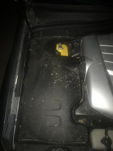

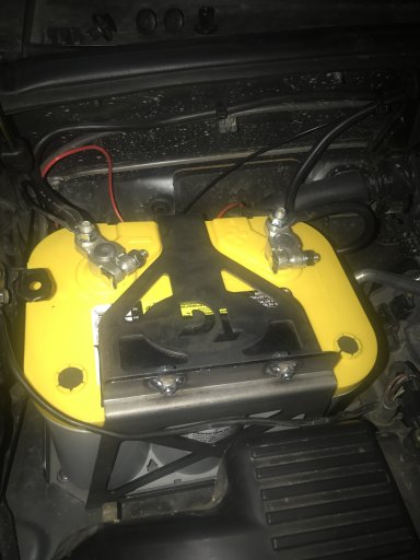

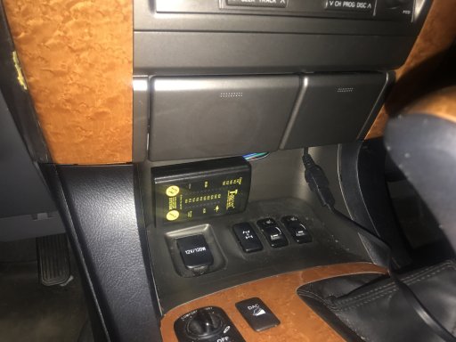

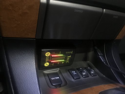

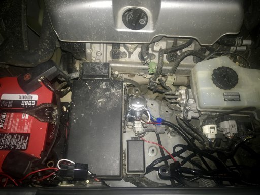

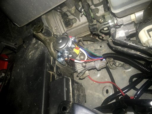

I finished the dual battery install last night. Used the T-Max dual battery kit on Amazon as it had good reviews and only cost $120. I was pleasantly surprised to find the kit had all the wiring and connectors I needed. It included enough 4 AWG wire to run between the batteries and solenoid, and the battery monitor is more than sufficient.
Decided to mount the solenoid on the back side of the bracket used to support the plastic engine bay cover and ran the monitor through the firewall, across the driver footwell and mounted right below the ashtray. Out of the way in an unused spot and easy to read when needed. Still need to move the led and light bar wiring to the aux battery, but more importantly the fridge wiring is on the aux battery ready for next weekend at OXW.

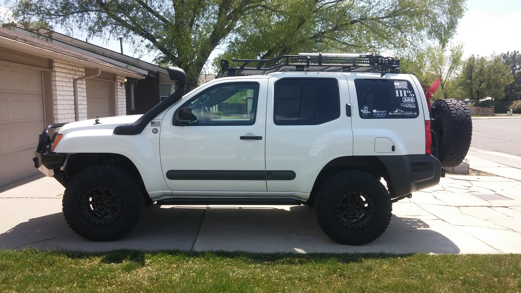

New leafs (alcan 2.5", +600lb), shackels (PRG), installed the grease-able SPC ball joints. The noise was coming from leafs, but my god, this is like driving a new truck.... I love it. I'm sitting about a inch higher than before, so after settling it will be close to where it was (OME HD pack, mid hole on Nisstec shackle), I will take rider height difference photo later, but a storm just rolled in, but let me tell you what a relief it is to get the dam OME out from under this truck. I still have 2 holes left on the shackle incase I want to increase height, but Im fine with it currently, just nice to increase height later.

Awesome! Any pictures of how the X sits now? I'm strongly considering putting in an order for a set of Alcans soon, and was thinking that 2.5 inch, 500LBs extra capacity would suit my needs. I've got PRG shackles on there already, and I don't want it to sit TOO high in the rear with new springs.
It moved up about 3/4" from where she was before, which I personally liked how she sat. So after break in and settling, and throwing the tent back up there, I think it will be even again. If not, I have 2 holes left on the shackle...
