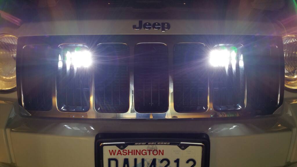

Finished wiring the Rigid Duallys behind the grill.

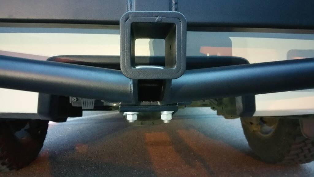

Wilco Hitchgate Max install completion tomorrow, with dual 4 gallon Rotopax fuel packs added.

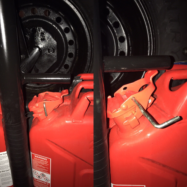

Today I had my metal fabricator add two steel pipes just over the lids of my two jerry can tire swing setup to keep someone from lifting the cans out or even opening the lids to siphon the gas out. He also added two more bolts to the tire mount to keep that 33" Dick Cepek fun country secure while on the trail and highway.

Looks great! Nice that you can still open the back glass.
How solid and sturdy is it? Any wobble?
Very solid. Zero rattles. I added a an additional low cost hitch stiffener, because it's just what I do. It's probably not even necessary.
The LOCK-DOWN Hitch Tightener Heavy Duty No-Wobble Hitch Stabilizer for 1.25" and 2" Receivers- Made in USA, Rust Proof, Quick Install, Stops Trailer Hitch Rattling!

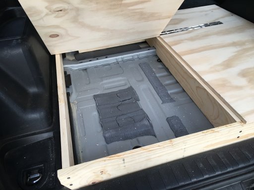

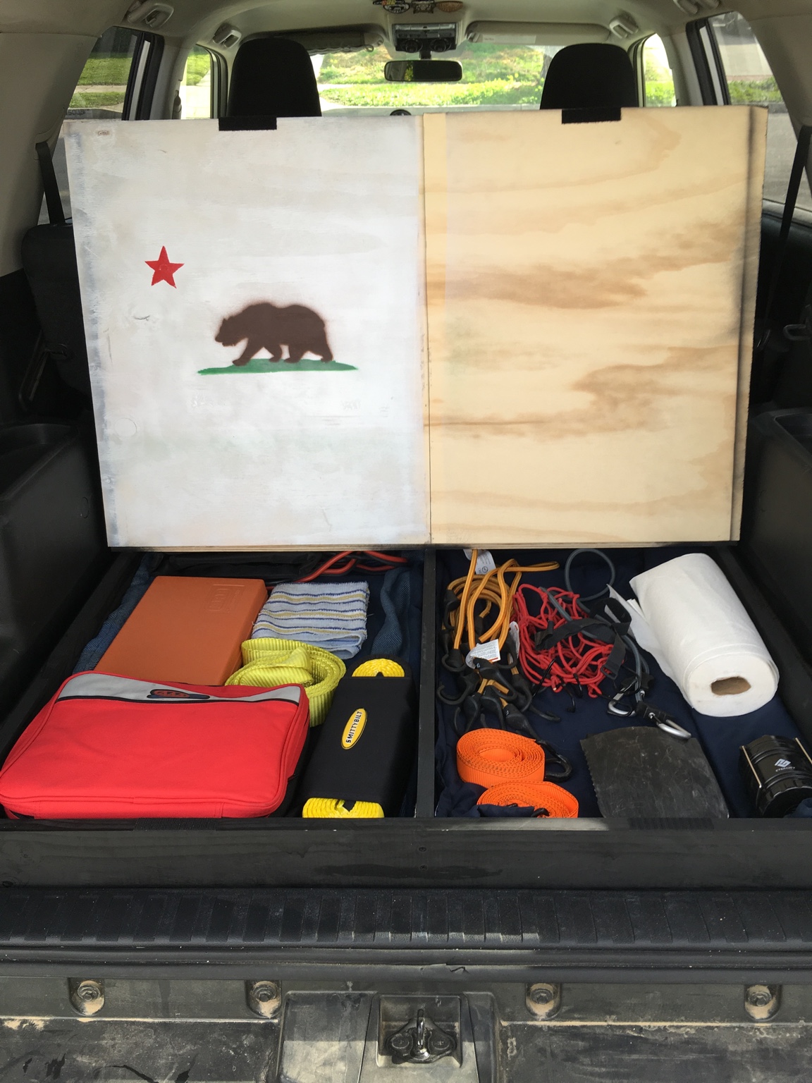

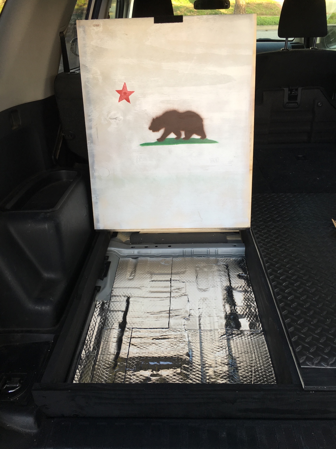

Finally got off my butt and built in a rear storage/sleeping deck for the 4Runner. If you get a 2014+ without 3rd row seats or the pull out cargo tray there is a dip between the folded down rear seats and the cargo area. it's about 2" and makes sleeping back there pretty uncomfortable. The carpet and hard foam under it are only really secured by two 10mm bolts where the tie downs are and some clips. Easily pulled out.View attachment 16898Next I boxed in the outsideView attachment 16899Added a lid with a split to make it a little more accessible if I have gear in the cargo areaView attachment 16900 To be continued...

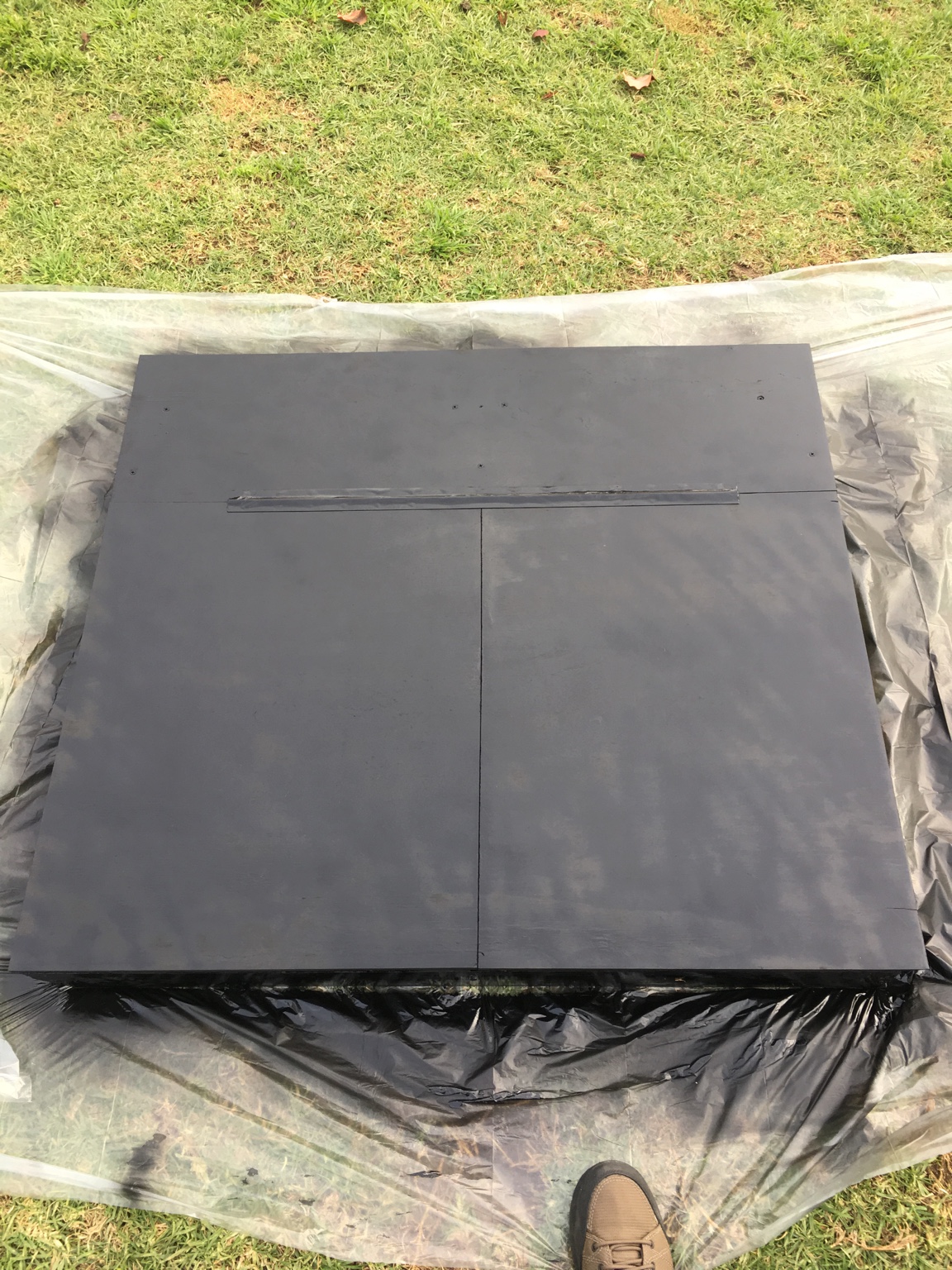

Continuing on... Time for paint. A couple cans of spray paint did the trick.
Next I added some sound deadening material to cut down on road noise, a little more paint to the inside of the lid [emoji6] and a rubber pad on top to keep the dog and gear from sliding around.
Added in some gear I keep in the truck all the time anyway, but at least now it will be out of sight.
And it was time to give it a shake down run. A buddy and I hit the San Berdoo road into Joshua Tree NP and camped in the park. Sleeping in the back now is awesome, add in my REI camp bed pad and it's as good as home. Up early for coffee and sunrise. The pup seemed a little chilly and not ready to get out of bed yet.
Overall spent about $60 at Home Depot and a day of effort. Big improvement to the truck and my comfort, so I consider it a pretty good mod for the time and money.
