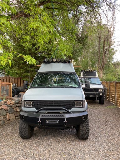

Finally finished up the roof rack wiring & hoisted the hack on top of the van. Took a little effort (rack weight is close to 190 lbs with lights) so awkward to lift but patience won in the end.
  • Love
Reactions: GLOCKer
Since my wife & I rock climb a lot, we used some old gear & an old rope for the pulley system. Anchor point was our other van. Using an ascender & old Grigri. I was able to pull the rack in the air, ended up working out quite well. The long sling on the ascender help when I was running out of steam. I would put my foot in it & step down the pull in slack with the grigri which is an auto locking belay device. Glad to have the rack on top of the van. Should be able to wrap up the wiring pass thru & switch gangle tomorrow .
