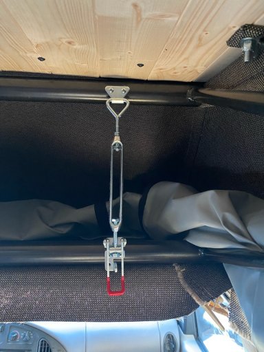

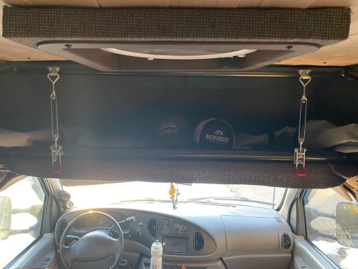

Played all week so no work on Vinnie. But late this afternoon I decided I better get the latches in for the top. Not really needed with electric actuators, other than really windy situations to help pull the bulb seal really tight so there is no chance of wind buffeting come in from the corners on the E Series Vans. The roof arch front back plus side to side so you can get a little gap in the corners at the front. Anyhow I never liked the latches that Colorado Camper Van used for the high top E Series Vans so I made my own… still need to paint them to match the frame. But they are installed & work.

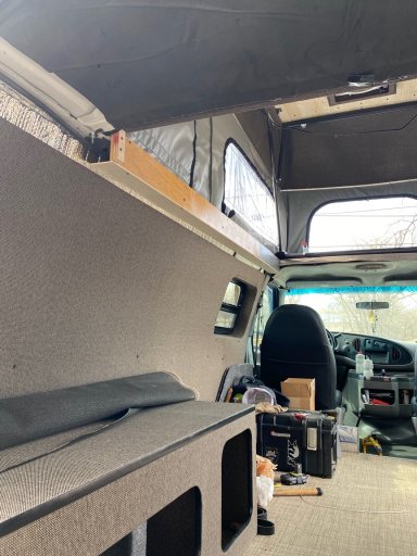

Seats, trim & one storage box. Oh & dogs.

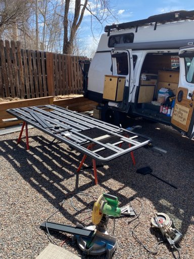

Vinnie is progressing slowly…decided to build a rack since I found a great deal on CL for two Rhino Racks, under $500 for both from a company that was going out of business. They were used not new but in great condition. I turned the two racks into one big rack for Vinnie. For got to take a picture of both racks before I started cutting them up but you get the idea…the hole is for my max air fan rack is 50wide X 123long. Low profile so I think it will look good on the van & allow me to mount my lights the way I like with 6 - 6” round baja style lights in the front. A 20” light bar on the rear & 2 - 4” cubes on each side. That way if we get into camp late I have no issues hitting anything in the dark.

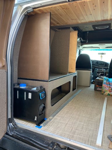

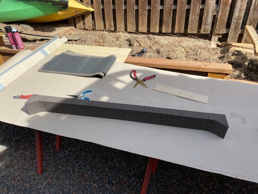

Not much has happened interior wise but the rear closet is coming together. Two sections are done & one is test fitted. It will look like the rear panel. One done I’ll put a face on the front with one door & a double slider for the larger opening. Plus I decided on putting the heater in the back of the van. It will have a splitter to so it will heat the rear & mid cabin. Not going to tap my diesel tank as winter diesel is horrible for heater ruins fuel pumps & filters way to fast. I’ll be running mine with a built in small tank & do a diesel/kerosene mix.

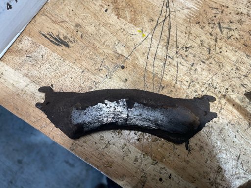

While on the lift we checked other under carriage parts & found that the rear rotors & pads need to be replaced. The pads made me gasp, they were extremely worn. Oops.
