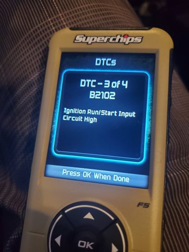

The engine turns but doesn't start.
Battery is full, 12.9
Scan says ignition run/start circuit high

If the code is B2102 there is lots of info on every jeep forum. Most common issue seems to be bad fuel pump. Even though the code is not technically for that. Check the fuel pressure at the rail. Could even use a little starting fluid and see if it kicks over to confirm the old school way. No death nails. Everything is an easy fix.

The thought was there may have been a fuel pump issue but if that wasn't recognized, and it was jump started thinking it was the battery, that may have sent the code.

? I dont imagine it will clear if the issue is not resolved or if your scanner has a fault?
But as to what it means, now that you are back home, when you get a moment of free time, take a look at the thread with some fresh eyes. We found the official and several practical possibilities for you to look into

This is a hard fault code ant won’t clear… check out the thread below for more details on the code and how to troubleshoot and fix the problem.
