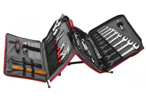

Always found what tools to carry tricky. I've added to what was a basic socket set over the years as I've needed tools for jobs but I know there is some I don't have. I'm not an experienced mechanic so I probably don't know what I might need in an emergency. On the other hand I do have experience with electrics so tend to carry tools and spares that relate to this. Probably because if it was something I messed with recently, it will be the next thing to break!
I did spend a while searching for a kit I could buy but gave up on that. This was the only one I found at the time.
http://www.motorsport-tools.com/facom-folding-tool-bag-case-and-tool-kit-set-2049m.html
Will be great for me to get ideas here too. Thanks
