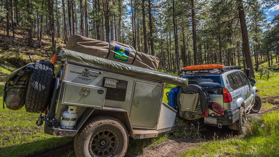

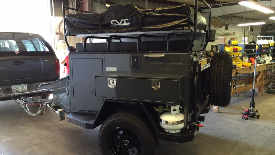

The biggest hang up is trying to decide on a combination that provides the largest propane tank setup. Since we are going with the nose and side box option, it reduces the 20lb side tank to an 11lb due to the long box reducing the available height. I can increase the overall capacity by getting the "grill tank" option, which adds another small 5lb tank on the passenger side... still not enough in my opinion.
The simplest solution is put a short box on the driver side (same size as the passenger side) to allow the installation of a 20lb tank. I also considered a bracket inside the main storage area to hold a standard 20lb tank and just pull it out when needed. Either way, I lose a bit of storage space.
The whole reason for sticking with a 20lb tank is to allow us to swap tanks at a gas station or grocery store, as opposed to searching for a facility that can fill the oddball size tanks. I'm open to suggestions...
The big box dilemma. (Driver side main tank below)
The passenger side "Grill tank" and short box.
