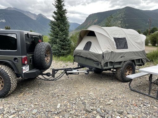

I tow my M101A2 often with my 2015 JKU Rubicon. No issues for me even loaded heavy (pallet of sod). Towed it to Silverton CO last summer. It towed good. DCCD1B02-5095-43B0-B5D5-1F224D1AAD13.jpeg

I tow my M101A2 often with my 2015 JKU Rubicon. No issues for me even loaded heavy (pallet of sod). Towed it to Silverton CO last summer. It towed good. View attachment 223550
@2015Rubicon - I like the way that works! :smiley: I built a similar trailer and I'm undecided as to whether to build a hard shell RTT for it or do something like what you have done. If I can get something to fit my 4'x6' bed with a drop down tailgate it might be the way to go.

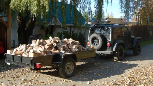

I tow a work trailer behind my TJR which sometimes scales at 3500# going to the dump. Load of chimney brick here.
Not an issue but not sure I'd want more than 2000# on the highway which my cargo trailer full of tools weighs.
