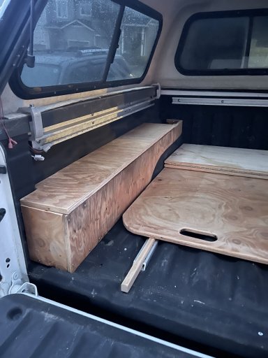

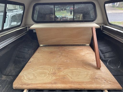

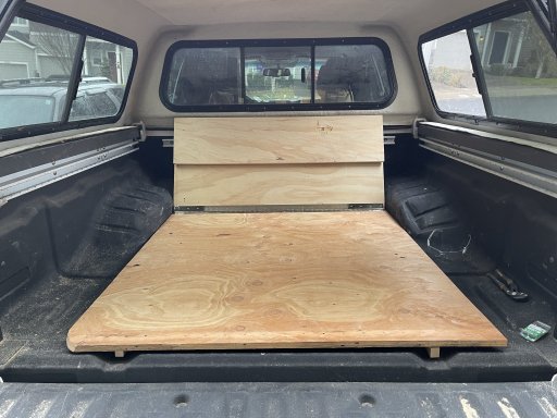

Make the simplest platform I could . I’m using a futon mattress (air mattress always seem to suck ) so I made the platform fold in two spots so I can roll the mattress up with sleeping bag on it and still be able to put stuff on top of the mattress and as a bonus it will sit angled when folded half way making a lounge to sit and chill . Found a piece of 3/4” ply in the back of the warehouse at work that had piano hinges on it so total cost so far is 0$ . The sliders are just pieces of hardwood that I did a round over on and sanded super smooth and smothered in paste wax . It slides super easy actually to easy because it bangs back and forth when driving . Took the scraps I had left over and mocked up a box for the sides . I will pick up some nice birch or other nice plywood to make them out of . 6103F605-F400-4894-B909-0656E2362646.jpegCDCFF773-8E55-42D8-B2E4-3D2C01E0AE11.jpegE385BEAF-3C0C-40CF-9EDE-ACC67BE64204.jpegC7F6E258-2F28-46F3-A904-B81FECC70D80.jpeg3E60C88A-7401-4AC6-B936-A997FB740D69.jpeg

That’s coming along very nicely.
I like the storage box on the side. Are there going to be hinges…oops, I just saw “mock up”.

ya unfortunately the plywood had been sitting in our warehouse for at least 10 years so it has let’s say a certain odor of old musty building and needs to go asap
What, you don't want that authentic "moldy motor home" smell?
Seriously though, I'm really excited to see what you do with this. I'm currently switching my Xterra around a bit myself.

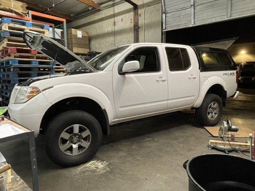

Productive evening after work 2” body lift (easiest one I’ve ever done ) and an add a leaf for the rear . Suspension was a bit squaty with even a couple hundred lbs hope the add a leaf will combat that . Have a couple little things to do later , make some 1” spacers for the engine and trans to help keep the shifter a little higher and will make fitting the winch behind the bumper a little easier . 5B86A869-3196-4981-A1E6-1334CCBFA1BF.jpeg1AB19A41-9E40-45D8-9ABB-8582052AA52A.jpeg

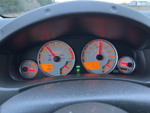

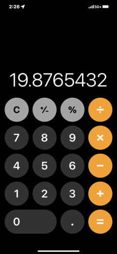

Had to run from clackamas to auburn wa and back because I mistakenly put some product on the wrong truck at work and had to pick them up from a shipper up there . Even doing 76 most of the way I still managed 19.87 mpgs and hit 150k on the nice little morning drive . E2A039BC-37DD-4A6C-B3BA-25C2F8D0106E.jpeg1C95BA06-1DFF-4681-994E-D018D83B2685.png

Had to run from clackamas to auburn wa and back because I mistakenly put some product on the wrong truck at work and had to pick them up from a shipper up there . Even doing 76 most of the way I still managed 19.87 mpgs and hit 150k on the nice little morning drive . View attachment 247963View attachment 247964
Looking forward to this thread and I enjoyed your Sequoia projects here and elsewhere (and I'm a little bummed you moved on from it), but I had to comment: I don't think I've ever heard of the I-5 run between PDX and SEA as a " nice little morning drive." You must really love your new rig!

the sequoia was a fun rig and I’m already missing it’s butter smooth ride but the truck just works better for me in daily life and I really want the convenience of a slide in camper down the road .
ya thedrive is much better in my truck compared to driving a box truck up there .

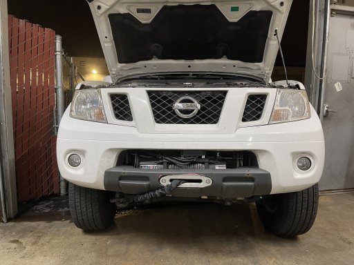

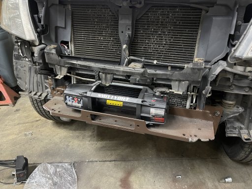

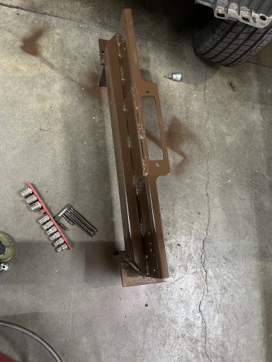

Making a little progress. Need to drill a few more holes get some longer bolts some more trimming of the bumper and mount but should hopefully get it buttoned up tonight . And if you’re wondering brown and blue was the only paint I had laying around at work . EE017A29-CAF8-4194-9C1B-421910AE9D99.jpegBE789026-93BC-4AD7-B6A3-126AFB81DA29.jpeg

I dig it. Where did you get that winch plate?
It’s just a harbor, freight universal that I attached to some half-inch play. I had laying around with a piece of 2 x 3 corner wall underneath it and a couple of quarter inch flat bar tab is running up the frame.

It more or less made sense. Are you sure the tabs and flatbar will be strong enough to hold during a pull? I'm not interested in putting a big steel bumper on my X (mileage is bad enough, and I don't want all that weight up front, requiring new torsion bars).
If it's strong enough though, maybe I'll pick one up, and have a shop help me figure out how to attach it to the front of the X.

Wam bumpers makes onethere is a company or two that makes to I just didn’t like the $600 price tagBD205F15-1B18-4500-B68A-484C19DB3CB2.png

That turned out really nice! I'm a bit jealous.
thank you , there are some things I really don’t like about it but it’s covered by the bumper so nobody will ever see lol . Next after I sell off mysilverado( if you know anyone in the market for a super clean 2wd let me know ) it will be onto the long process of figuring out tires and debating on building a slide in camper for it .
