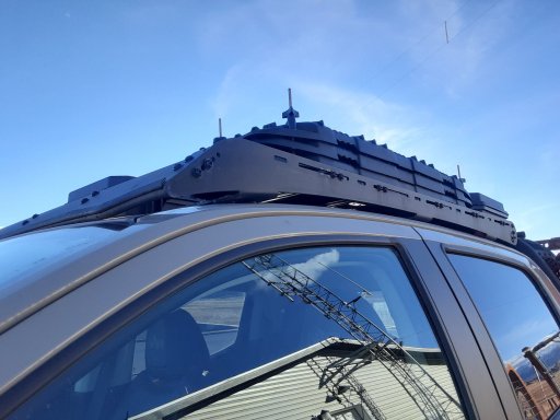

With our change of focus to have camping-type stuff on our trailer, the roof rack had become very... bare. There was just a pair of traction boards on the rails held down with ratchet straps, and the whole roofline was now lower than the toolbox that is on the bed rack so it looked uneven and particularly empty. The fix was to add another Plano box on the roof rack, and add a second pair of traction boards to make a complete set of four. The toolbox is along the passenger side where it is easily accessible, and the boards are along the driver's side mounted permanently with some 1/4-20 rod and some knobs and other assorted hardware. We have removed the 23Zero 180R awning (which is for sale!) since we don't need so much awning on the truck anymore, but we may replace it with a 4 or 5 foot simple pull-out awning in the future so room has been left for that just in case.
Sorry for the crappy pictures, but the sun was getting awfully low!

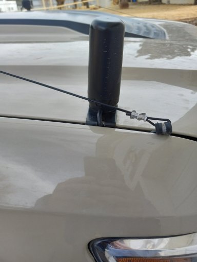

I've always wanted limb risers. Do I need them? Probably not. But I like the look and ultimately it's cheap insurance since I spent maybe $25 on this whole project. I found a 100 foot spool of black plastic-coated stainless steel wire on Amazon (wire OD 1/16", coated OD about 1/8") that even included the right size crimps for the end loops for around $18. Coupled with some Ace Hardware rubber coated metal P-clamps and a pair of small turnbuckles, plus a few small bolts, and voila: easy 30 minute project. I used open ended turnbuckles with the theory that if I ever hit something beyond the breaking strength of any of the components, a bit of stretch and the assembly will come apart before it rips any metal. A dent from a branch is easier to repair than a ripped bolt hole in the sheet metal. The only downside is that in order to open the hood the turnbuckles have to be loosened, but that doesn't even require tools.

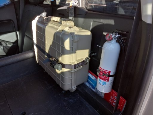

Things slowed down a bit over the holidays, but now we're back at it! Today we did a simple addition: a large medical kit and fire extinguisher, mounted where easily accessible (but not stealable!) in the cab. We have more projects in the works; we're just waiting for everything to ship!

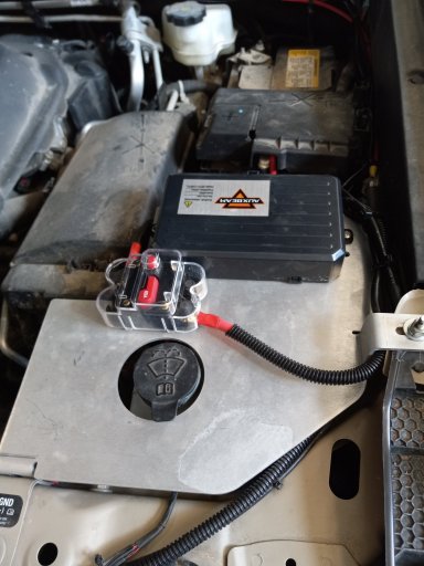

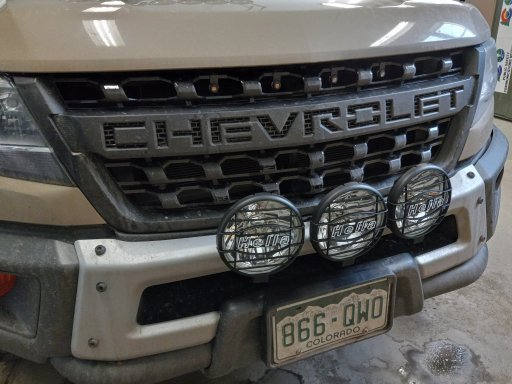

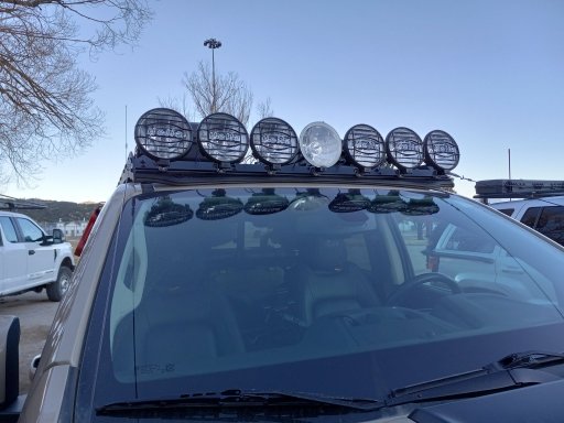

As I've been hinting, I put on the first lights for some nighttime exploration capability enhancements. I finally got around to wiring in the bumper, A-pillar, and roof rack lights with an Auxbeam 8-position switch pod. Though we're only using three of the circuits now, there are plans for all of the others with eventual side and rear facing lights and chase lights. An engine bay mounting plate and sunglass holder replacement panel (both from Colorado & Canyon Enthusiasts) made the job stupid easy.
I previously posted pictures of the lights mounted to the roof rack and bumper; I really like the multiple-pod look a la the KC PRO 6 lightbars that are so popular, but that is way out of my budget. Solution? Take Hella 500FF lights (I had them on my FJ Cruiser previously and had a good experience with them) and I replaced the legacy 55W halogen bulbs with LED units since they're just standard H3 bulbs. I'm looking for higher-wattage bulbs but for now the equivalent of high beams will do. I chose Auxbeam floods for the A-pillar lights, on mounts from Rago Fabrication.

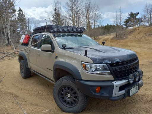

To eliminate glare off of the hood (from sunlight as well as the roof-mounted lights) we got the hood wrapped with a matte black vinyl that has a topographic map design on it. Really pleased with how it turned out! And it's not just any topo map - I had the graphics shop use the map of a trail my wife and I hiked on one of our first dates as the basis for the design. Let me tell you about the mad props I got for that! I haven't put up any whole-vehicle photos to show the status of the build in a while, so here's a few from today while I was out scouting the area for June Jam 4. A bigger change is coming next week - getting new and bigger shoes on!
