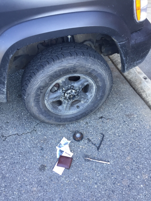

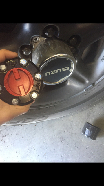

Also, good to consult shop manual for torque specs. haha. working on getting it to you.Well here's a quick lesson in the use of Locktite. Walked outside this morning and EVERYTHING SINGLE bolt for my lock hubs was gone on one side.
Luckily there is a Fastenal around the corner and they had the replacements.
Don't let your kids to grow up like me, teach them to use locktite the first time or they'll end up working on their rig in a parking lot.

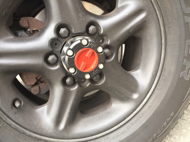

What kind of manual hubs are those? I was looking at some cheap $50 online and those look the same. I was wondering if they worked well?Updates on the Super Trooper:

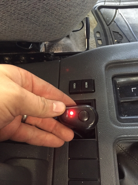

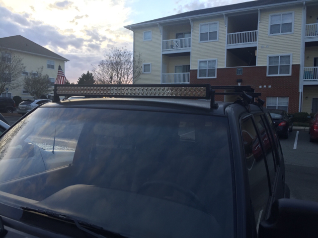

New LED light bar was installed. Kind of a middle of the pack price wise off FleaBay, so we shall see how it holds up. My only complaint a week after install is the switch it came with is really low quality, I'll be switching it out very soon.
I took the time to run all the wiring behind the trim of the interior and it was worth it. If my high school self could see me now! Actually taking the time it do something right... who would've thought?

With the lift going I needed to address the notorious CV joint issue Troopers and a lot of other IFS rigs have, so I installed locking hubs on the front. When the rigs is seeing daily driver duty the front will run free and this hopefully reduces if not eliminates wear on the drivetrain components upfront. I'll lock it up when I hit the dirt. I've heard of guys running lift son these 2nd generation Troopers and the CV joints going out after only 200 miles. Yikes.
Really simply to install. Took me about 20 minutes combined for both sides.

They are the $50 knock off aisins. They work great so far. It's been about 2 months. Just make sure after you install, that you retighten and check the bolts. I lost all of mine on one hub.What kind of manual hubs are those? I was looking at some cheap $50 online and those look the same. I was wondering if they worked well?

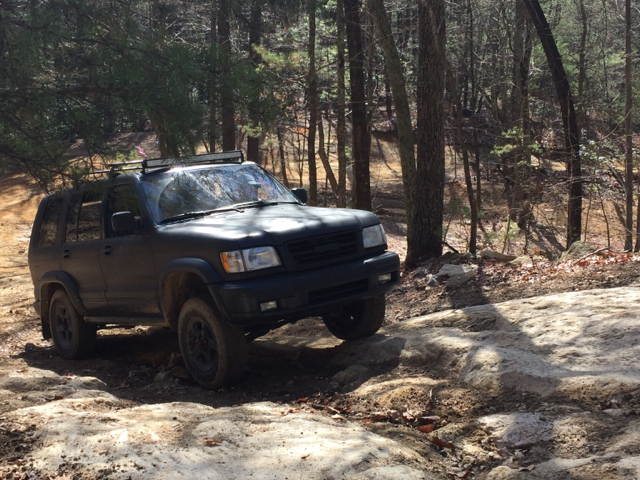

Finally got out and had an adventure! Tried out Brown Mountain, NC OHV in Pisgah National Forest and it was awesome. The Trooper did really well and had no issues. It surprised me how capable it was. I camped out on the other side of the park with my wife. It was great trying out all our new gear. Only issue was I'm 6'1" and the back of the Trooper is not so sleeping in the back was rough.
My father in law brought his JK out. We stopped here and had a nice picnic with the rest of the family. He was shocked how well the Trooper did and said he was proud to have owned one 20 years ago.
My mighty Trooper standing tall.
Brown Mountain Beach is a really pretty place to check out. It's great to climb down into the gorge, hop on a rock and enjoy the sunshine while the occasional white water kayaker paddles by. If anyone is interested I can write up and post in the trips thread all about my findings. Sorry my pictures suck. I tried not to have my phone with me that much this weekend.
