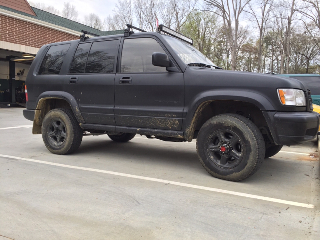

So I swung by my buddies shop before work and snuck in some wrench time. About 30 minutes later and we are riding 2" higher.
I used Rubicon Express 2" coil spacers in the back from a Jeep JK Wrangler and turned the torsion keys in the front. Eventually I will go to a more proper and permanent lift but this will do for now while I'm just starting off. I don't want to get carried away (yet.)

After:
Hand fitment test:
Before:
After:

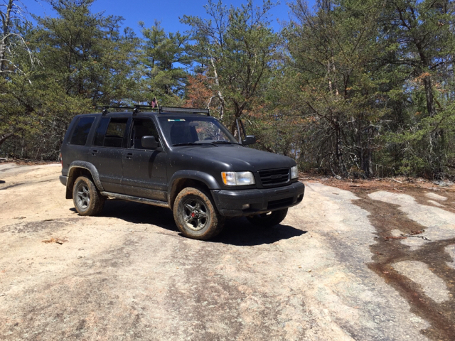

Finally got out and had an adventure! Tried out Brown Mountain, NC OHV in Pisgah National Forest and it was awesome. The Trooper did really well and had no issues. It surprised me how capable it was. I camped out on the other side of the park with my wife. It was great trying out all our new gear. Only issue was I'm 6'1" and the back of the Trooper is not so sleeping in the back was rough.

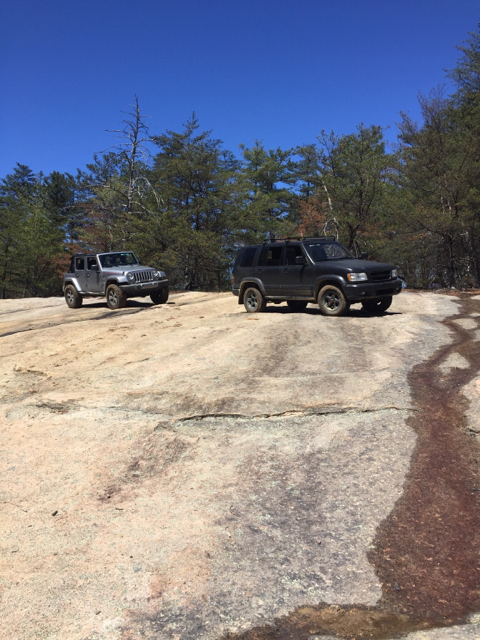

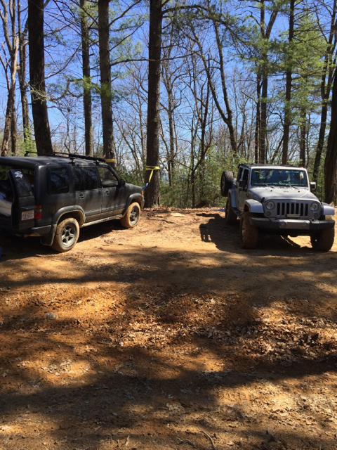

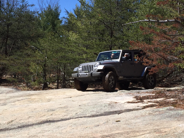

My father in law brought his JK out. We stopped here and had a nice picnic with the rest of the family. He was shocked how well the Trooper did and said he was proud to have owned one 20 years ago.

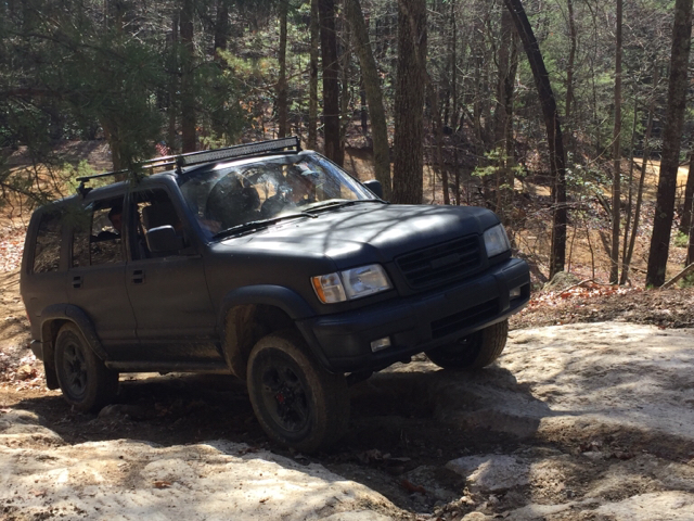

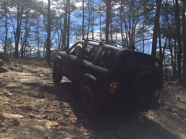

My mighty Trooper standing tall.
Brown Mountain Beach is a really pretty place to check out. It's great to climb down into the gorge, hop on a rock and enjoy the sunshine while the occasional white water kayaker paddles by. If anyone is interested I can write up and post in the trips thread all about my findings. Sorry my pictures suck. I tried not to have my phone with me that much this weekend.
FUTURE PLANS:
First off, the Trooper needs armor. It'll never be a rock crawler but there was one obstacle this weekend, thanks to some shotty spotting [emoji36], it took a hit. Nothing got broken and thankfully Isuzu had the foresight to build it decent protection from factory but I about shit myself initially.
