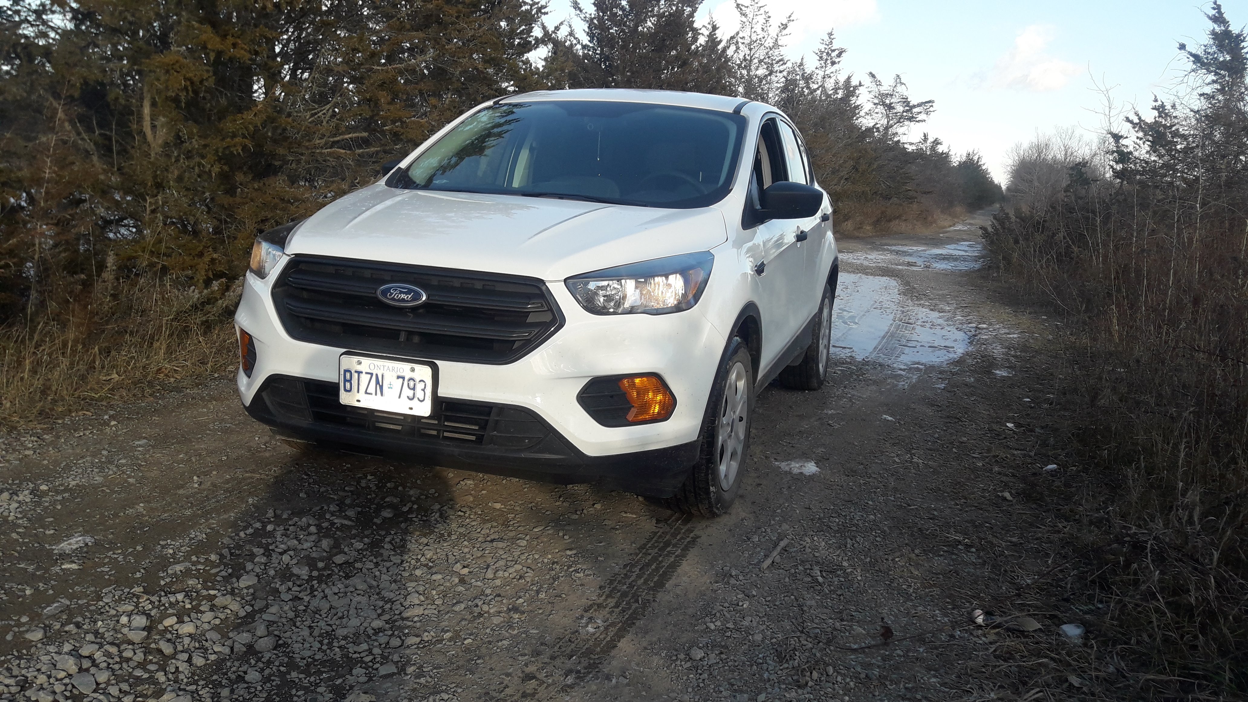

Probably the part that scares me the most about my escape is that there doesn't seem to be any factory tow hooks.
Being a 2wd, I sort of expect that but even the 4x4 models don't have them.
Ford lists a tow eye for recovery.. but I can't seem to see where the heck it goes on the 17 models.
Any other escape artists have a hint? I for one won't go down any tougher of a trailer without them.
Apparently Ford did away with it in 2017 which is really messed up.
