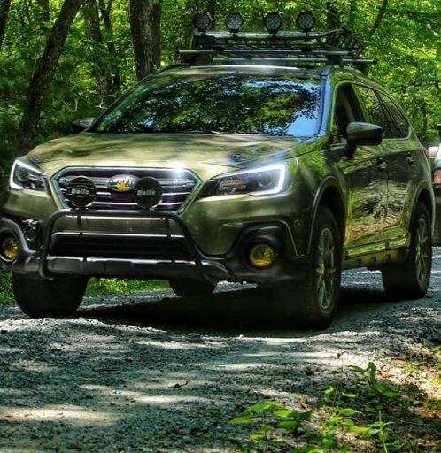

LP stuff is so damn expensive and then to add insult to injury you get slammed with freight. I want skids and bull bars / sliders for my 2019. Wish Primitive would step up their game or LP would get a US distributor.
Primitive now has skids and sliders for 2019 - at least for the Outbacks. Sliders from LP are $1,000, from Primitive they are $500.

The LP just look so much better and better designed. Whether they are $500 + $160 freight better is the question.
Also, no front light bar or side rocker rails from a Primitive.
The biggest difference outside of price are the Primitive sliders are 1¾" diameter and are MIG welded. The LP's are 1½" diameter and are TIG welded.
You won't find any debate from me about the LP set being more desirable than the Primitive set. They do have some cool looks & they are at the top of the game for putting out high quality stuff for Subaru models way before any other company. I was dead set of wanting to get some LP gear for my Outback. The question becomes, are you paying for the name - or are you paying for a higher quality product? Are you paying for form over function? I haven't heard of anyone having a problem with any of their LP gear - but I also haven't heard anyone having a problem with Primitive.
Rock sliders and rocker rails are the same thing. The bumper guards are a different story... LP is still the only company that puts out a serious guard that provides protection without losing your front bumper cover. I got a front rally light bar from Rally Innovations. It doesn't offer any protection but it does the job.

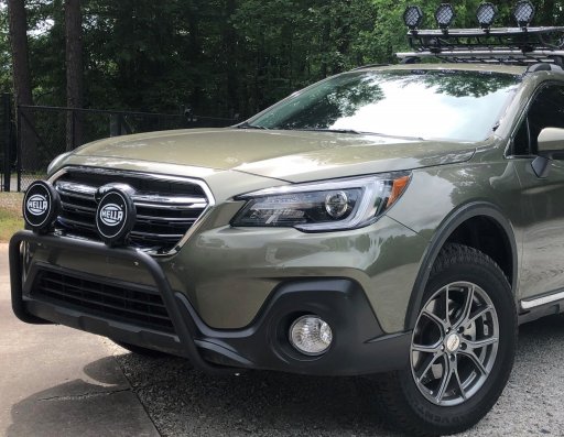

That is a fairly easy task. I installed one of these from Rally Innovations. I bought just the bar and then installed a set of Hella 500 lights on it.
105394
It bolts on to the bottom of the frame and then uses a second plate that bolts onto the bumper beam to have support pieces that come out through gaps in the grille to keep the bar steady. They call it a "Rally Light Bar" instead of a bull bar because there isn't much protection to be had from it.
I like the Primitive winch mount because the winch can be hidden behind the bumper cover. The main reason I like the LP bumper guard is because it provides protection but it doesn't mean that you have to remove or cut up the bumper cover. My car is a 2019 model, I really don't want to mess with cutting up body panels or anything. I'm sure you can understand with a 2018 Forester.

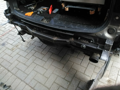

If you're in need of some ideas, this is what I'm working on now:
107271
Those two plates at either end will fit through holes in the bumper, and then the swing-out will be mounted in double shear, with the plates you currently see resting at the bottom.

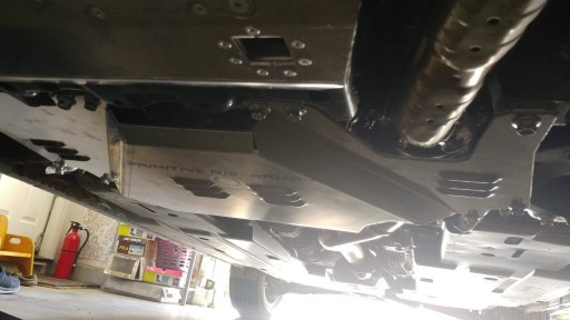

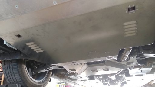

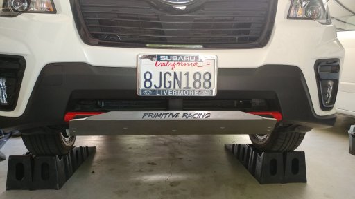

Decided to pull the trigger on some underbody protection, trans fluid pan looks extremely vulnerable. Ended up getting the get-Primitive skid plate set, looks good and doesn't actually reduce clearance by that much, it tucks in there nicely and is not very heavy, according to FedEx the entire package of the front, mid and rear diff plates was 40lbs. I'll get some more flattering photos later off the ramps and better lighting.
I did the engine, transmission, and rear differential plates (the snow plate didn't seem like anything I needed here in the deep south). The biggest surprise I had, was a 2-3 MPG increase with the Primitive plates.
I just installed mine yesterday so can't say for sure but milage did seem higher than usual on my commute and I had bad traffic so at highway speed I should probably notice an even bigger increase.
Yup, it had never occurred to me the amount of wind resistance created by wind flowing underneath and up into the chassis. I always thought that things like the "active grille shutter system" in my Gen5 OB were just gimmicks to sell more cars. Turns out, they actually do know what they were doing. Now if only I could get a full on diff locker and a quick release for the rear swaybar I'd be cooking with gas!
