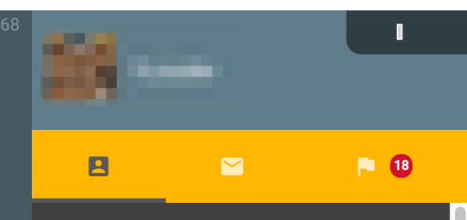

Stephanie,
It was not via email (although you might have received an email notification) but via the Overland Bound forum's private messaging feature. In the top right of the forum, you will see "inbox". Click that, and go to the conversation titled "Tri-Fold Mattress". The following link *should* work for you:
https://overlandbound.com/forums/conversations/tri-fold-mattress.34930/
