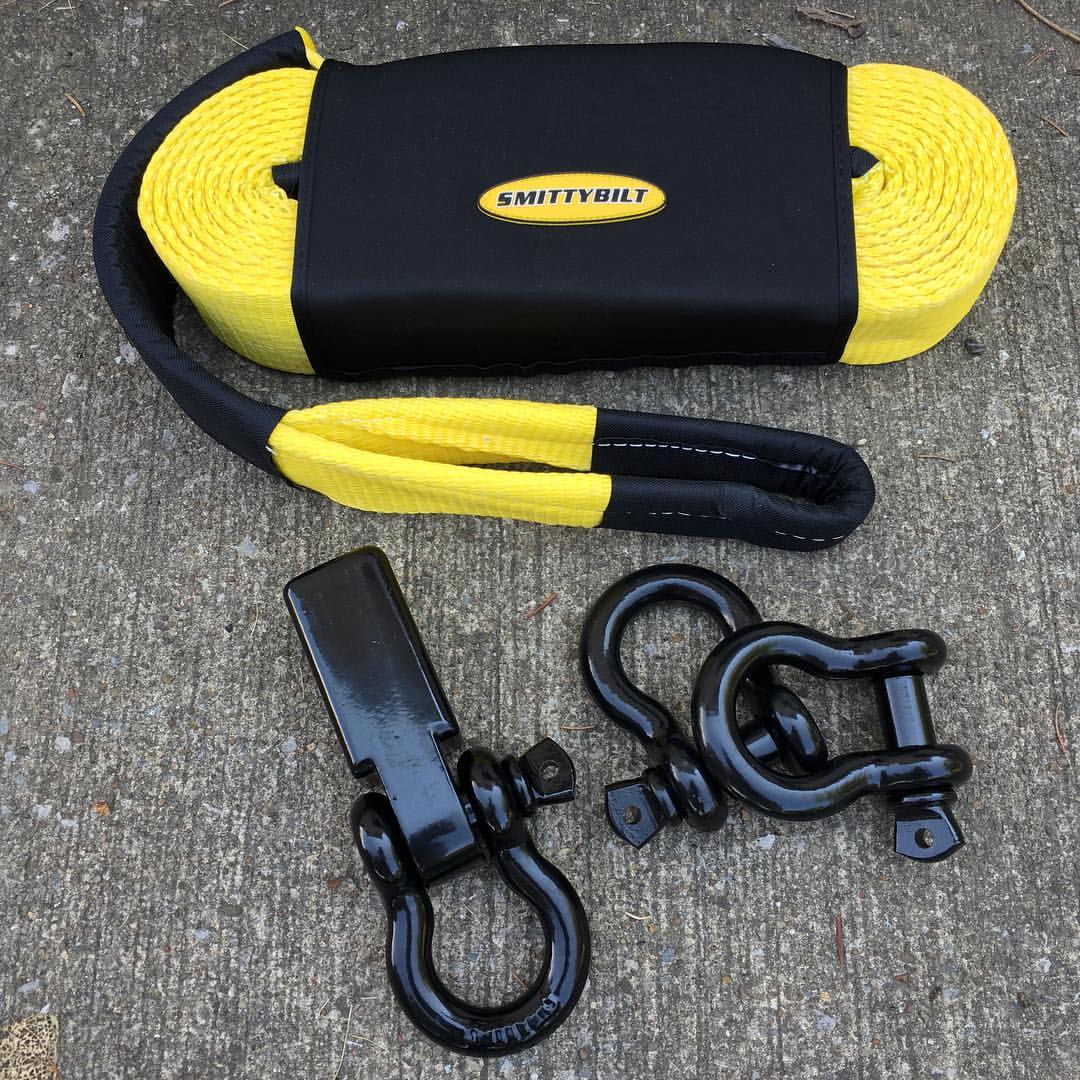

I finally got around to putting together an actual recovery gear kit as well. I had been just throwing pieces of kit in amongst all my other gear. Now, I have a box with everything inside that I can grab and go, much better.View attachment 6224
Still need to add a good snatch block though.
I love your dogs expression in this photo. [emoji106]

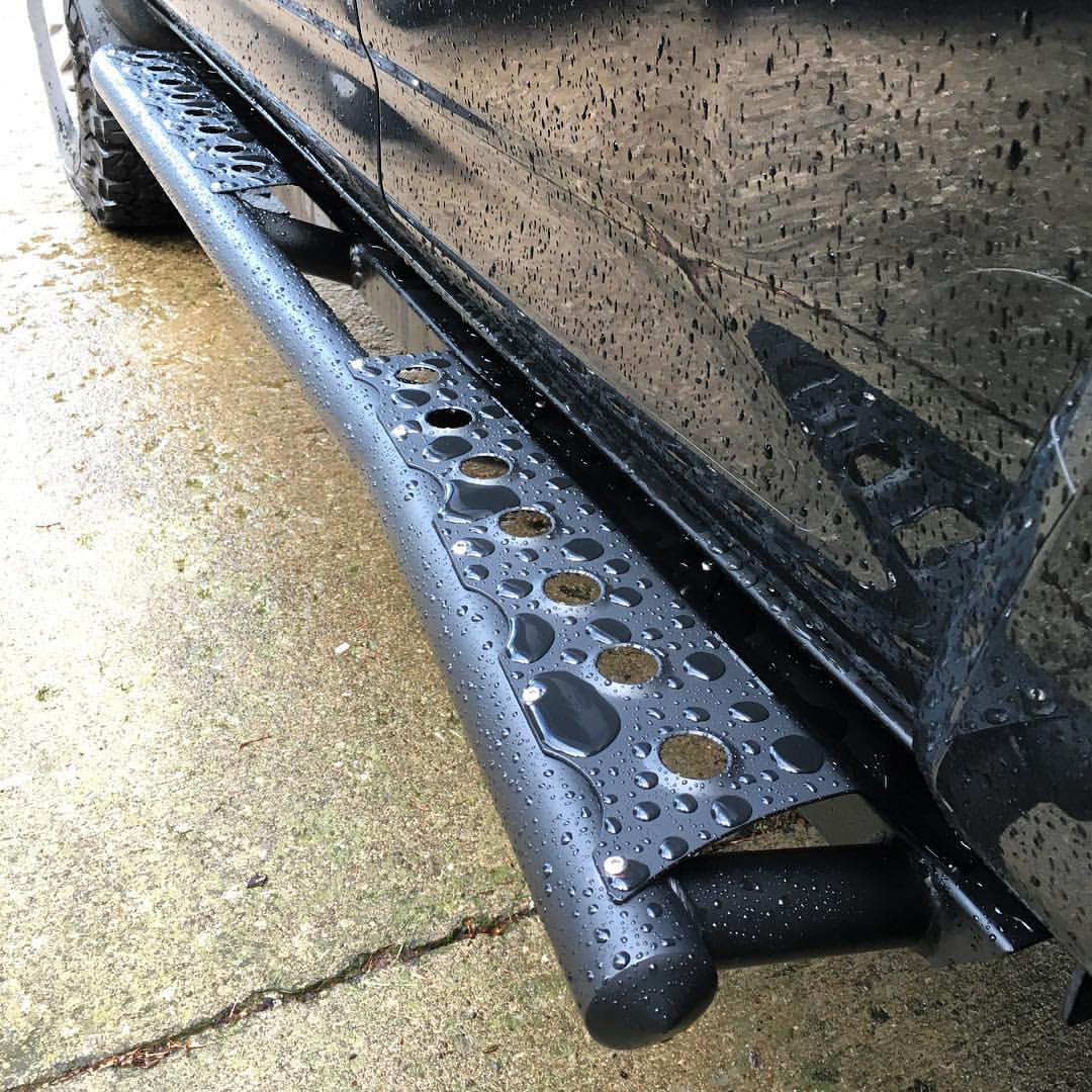

We *finally* got the C4 Fabrication rock sliders mounted on my 4Runner. They look fantastic! I was #4 on the group buy, but they spent two months at my powder coat guy! Shoulda just had Caleb do them for the $25 I saved... Thanks to #ohio_hawk for the guidance and massive amount of help. It was 90 with 96 heat index while we did this!

I liked the C4 Fabrication sliders because they had the separate step plate and looked a little different than most brands. Plus, the 2X2 supports are turned 45° for more strength, with angled gussets. They look really strong!
The removable plates were done so that the powder coat gets better coverage. You've all seen deep pockets or corners with limited on no coverage on powder coated parts. Having the steps separate eliminates those pockets, so I'm less likely to have rust in the nooks and crannies.
And having the rear of the step tube stop where it does instead of returning to the main slider like most nerf style bars gives it a distinctive look. I'm very pleased!

i just ordered mine.
Mike and I ordered ours together to share shipping, and he knew this powder coat guy, so we saved a little $$. Mike ordered a bag of #10-24 X 1/2" stainless steel button head screws to use on the steps, instead of the supplied zinc plated self-tapping torx pan head screws. They were only $7 for 100, and should prevent rust better than the plated screws. plus they look a little better. We just ran the self-tappers in first to start the thread, and then used the stainless screws.
We also sprayed the frame rail and back of the slider with Fluid Film to prevent any rust building up between them. And sprayed some Film Fluid into the tubes through the step holes prior to mounting. Lastly, we used anti-seize on all the frame fasteners.
Mike did his first, and it took him two hours for the passenger side, and 3-1/2 hours for the drivers (we both have KDSS.) I wasn't available to help him. He came to my house yesterday, and with his knowledge of what needs removed and pried, and having four hands instead of two, we did mine in 2-1/2 hours! Plus, he used a floor jack and a couple jack stands to get his in place. I have a motorcycle lift, so it was easy to maneuver the sliders into place and holding them while installing the fasteners.
Those are sweet! Can't wait to replace the stockers with these ore something similiar
