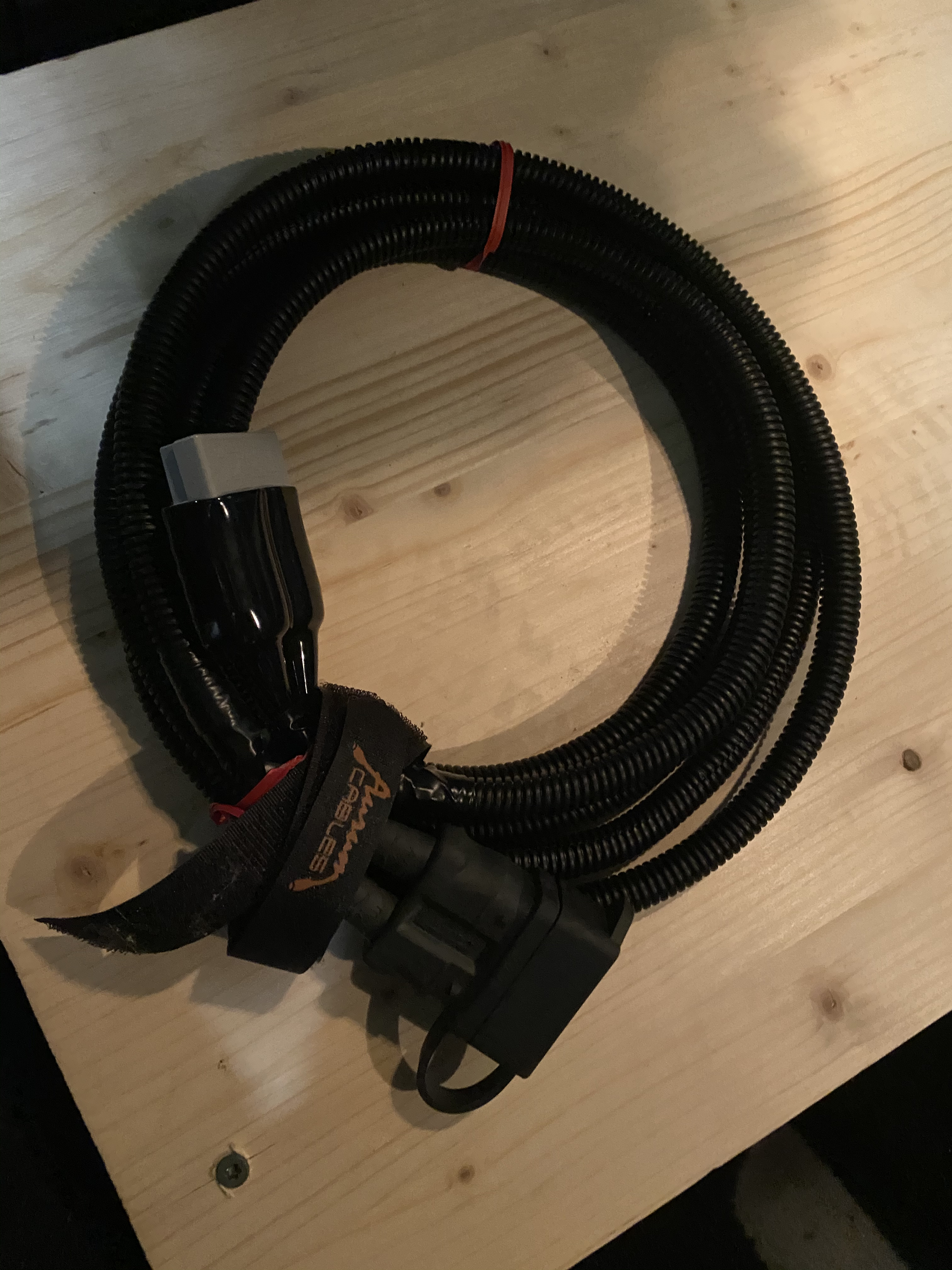

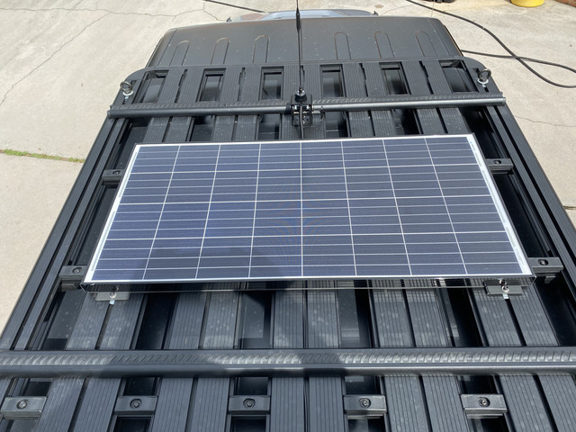

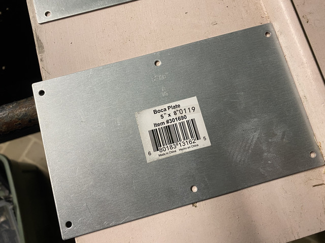

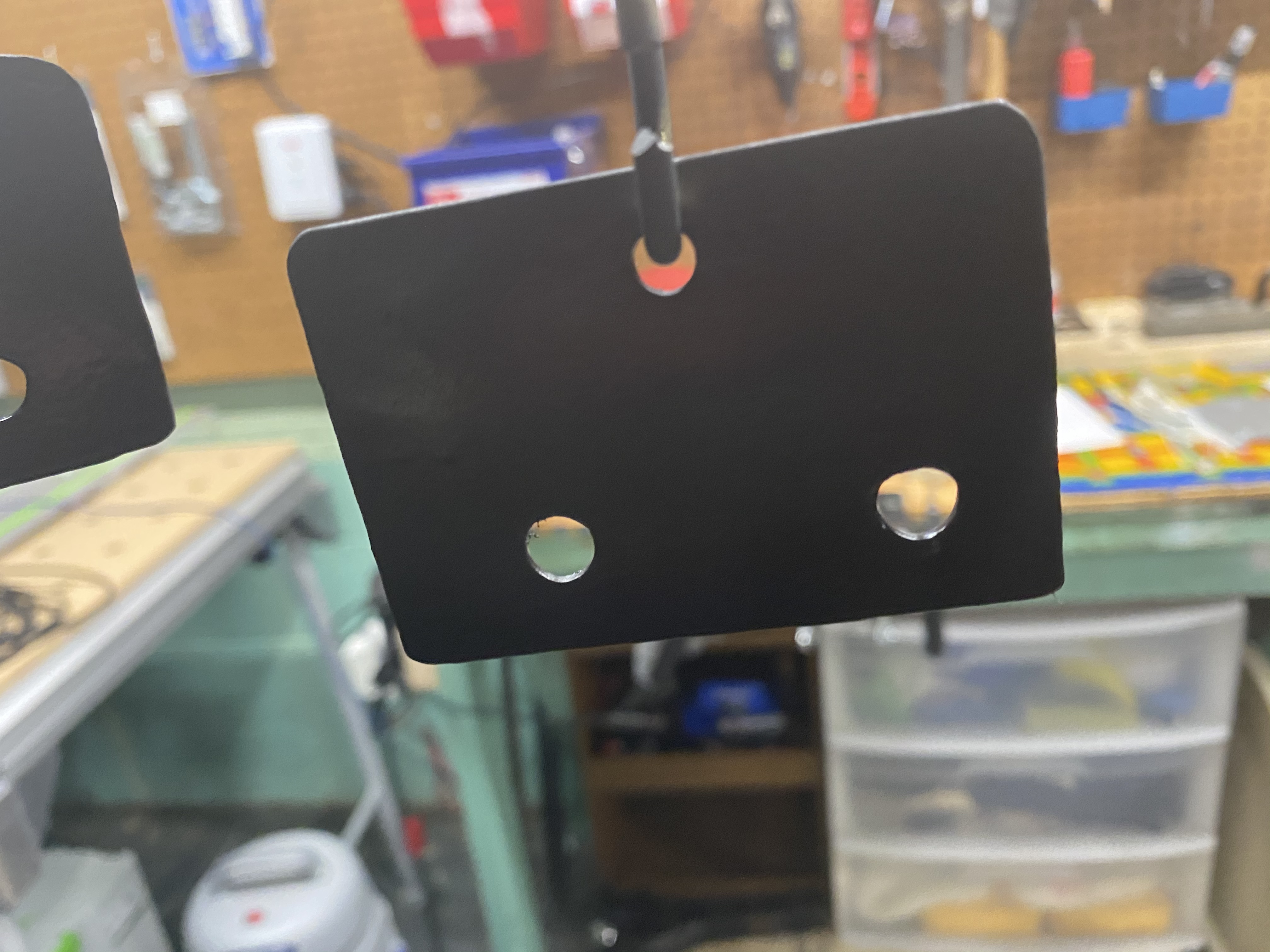

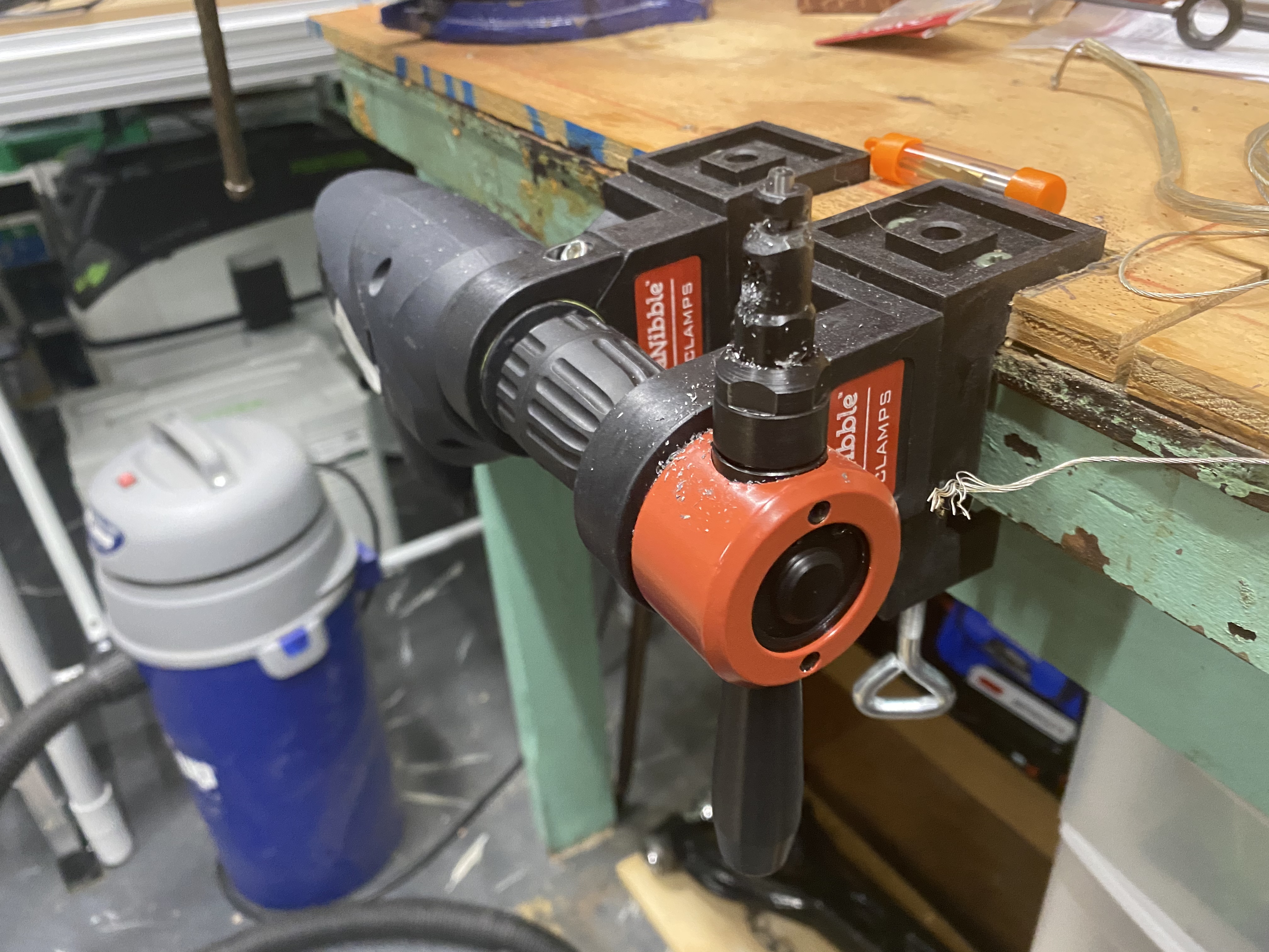

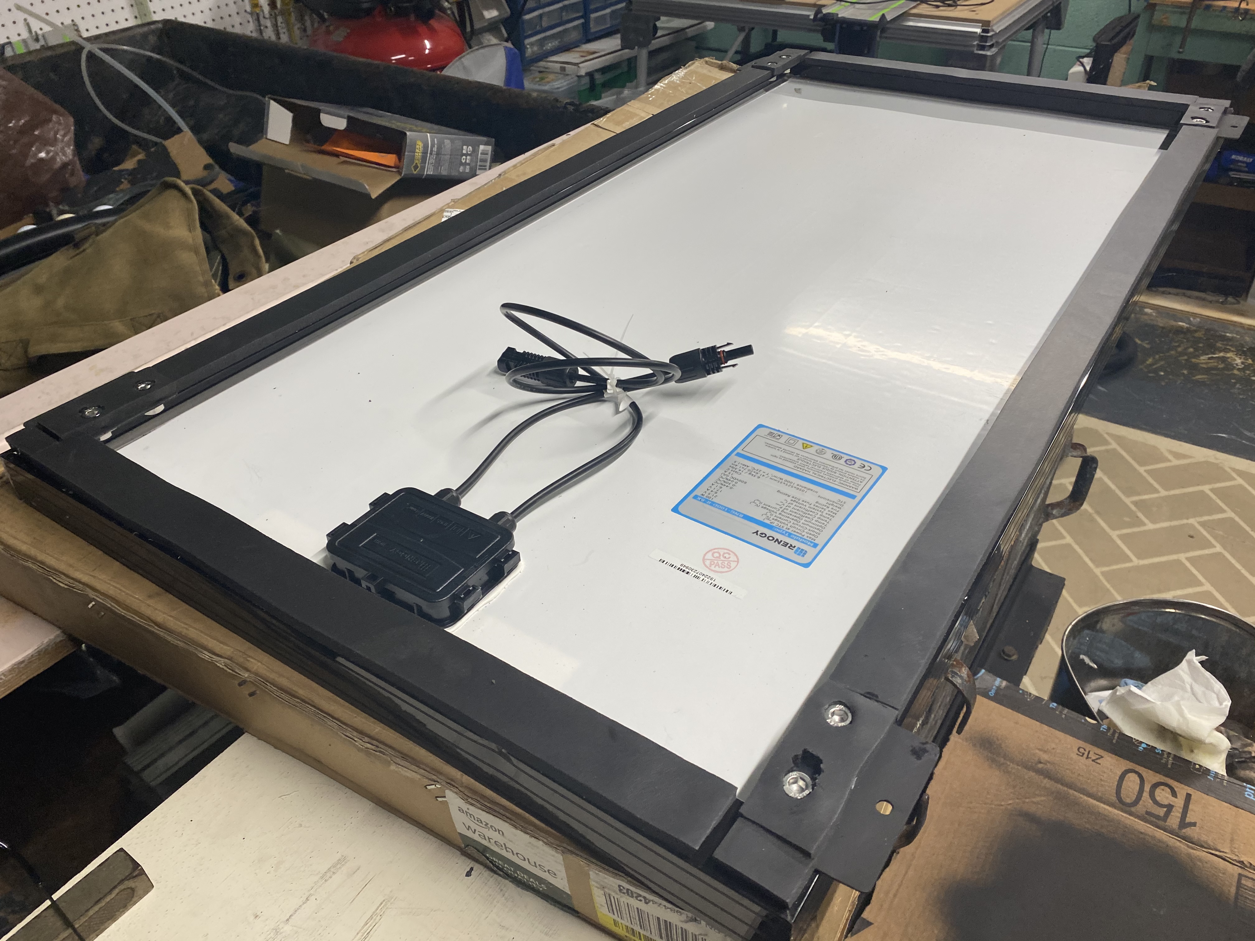

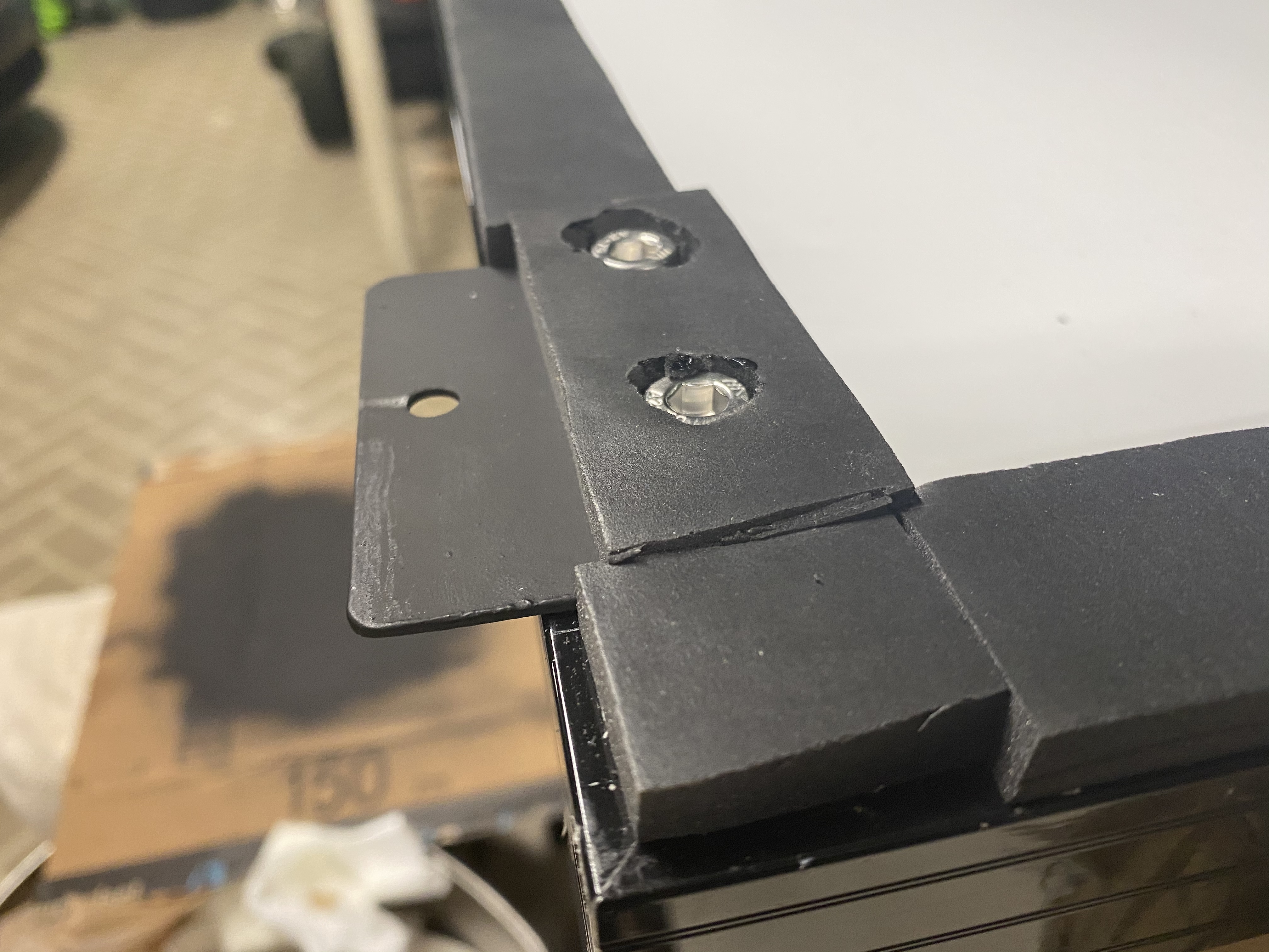

I just added 100w Renogy to my Jeep for the Dometic PLB40 and a Snomaster CL56D.
I had to make some brackets form 16g steel (Lowes) to attach it to my roof rack.
Used a CaNibbler to shape them.
I also made a custom cable with Anderson SB50 connectors and Powerwerx Environmental boots to run from the panel to the PLB40.
