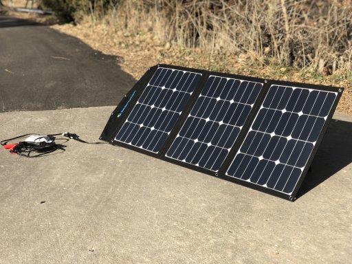

Since I did add an ARB fridge to my setup, but am still 'investigating' the best way to add a deep cycle battery, I decided to add another lightweight, but more powerful, solar panel to my gear.
I've had a 24W triple-USB port panel (http://amzn.to/2Bg5Fxs) I use with great success to top off my iPhone and iPad when off grid camping. Figured if it works for the gadgets, it might work for Ruby's battery as well...
So, after some research, I decided to order an ACOPower 12V 105W panel. It comes with one USB port, and built-in alligator clips. Can't wait to give this a test run! http://amzn.to/2BClg7D
If this works as well as the little one, I may add a second unit and wire them together...

I also own this ACO panel. Been using it for about 3 months. My trailer has a solar controller built in so I'm not using the included controller. This panel works well and is far more convenient and easier to store than my old 100 watt hard suitcase.
-Curtiss
Thanks for the feedback. Looking forward to using this as well!

Nice. Yeah, my 24W little one has been in my camping gear for a couple of years. Works great for iPhone, iPad, my Macbook Pro, and charges my handheld CB (the Ham/GMRS is in Ruby, so runs of the battery.)
I was looking at other panels to permanently mount on the roof rack, but with the RTT there's just not enough room up there. And with the separate folding ones, I can 'follow the sun' easier as well. In the summer, you get an average of about 5h of top sunlight, so most of the charging has to happen during that time :)...
Also, considering the weight and size, I could easily add another panel to get me 210W when connected.

Yeah, I started looking at these panels using your posted link from the other post. Figured, due to the low efficiency of solar panels in general, I'd go for the highest wattage I could get for my application - as long as the price weren't exorbitant. These (http://amzn.to/2CM43rH) seem to fit that bill.
I also like that they come with a controller - even though I'll eventually probably get one mounted in Ruby, with fixed wiring to the battery(-ies) and a plugin on the side...
