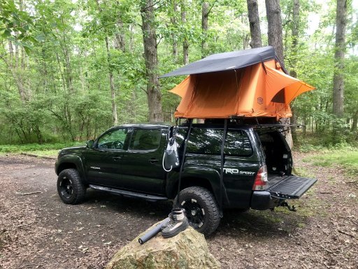

I use metal topper with 2 side doors and the rear door. I have put up to 1000 pounds on top, my rtt, myself,my wife, PC water tubes 10 inches wide and 6 ft long x 2, 270 awning. This is all on top and my kitchen is inside the topper. Fiberglass will not do this.
What kinda topper do you have Pic?

I used angle steel and tubing and bilt and exoskeleton roof rack on the outside of his topper. Bed rail over the top to the other bed rail. I and looking try and do it in aluminum buy the end of summer.

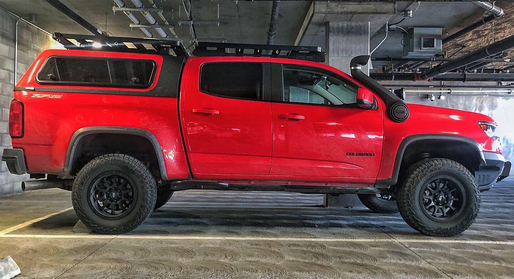

I'm probably late to the party but seems like an over-topper roof rack is the answer. I am currently modifying an older steel contractor rack to allow my old ARE topper to fit under it. Granted Im running a 3/4 ton diesel with LOTS of weight capability. There are a few manufactured racks that do I this. That way I can pack the truck bed with gear, dog cages, etc and a have the rtt and some recovery gear up topside and accessible.
